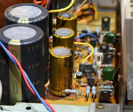

Hello to all Sansui & solid state enthusiasts.
this receiver needed many transistors replaced, they have been carefully replaced with modern parts, list available upon request. Upon slow power-on via Variac (approximately 70 Volts) I am noticing immediately the power transformer making a buzzing noise (excessive noise based on previous repairs) it is also becoming warm to touch and you can begin smelling the resins or paint softening, not a good sign. The voltage rails on the power transistors are ok on one collector side and not good on another. If I disconnect the tree secondary wires from the transformer to the amplifier board, the buzzing is gone. My gut instinct tells me that there is something wrong with the amplifier board or the power supply itself for the high voltage rails. I also cannot get the -23 VDC rail to show (the positive is fine). DC Offset & BIAS seem to be very responsive. Any pointers may be much appreciated, thanks

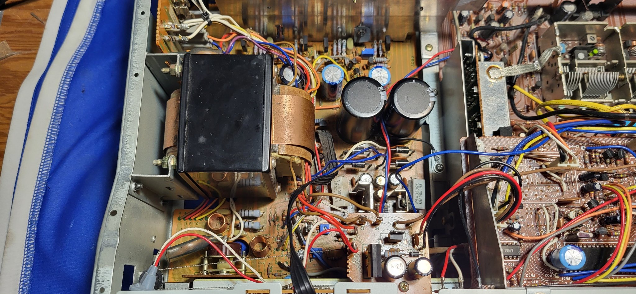

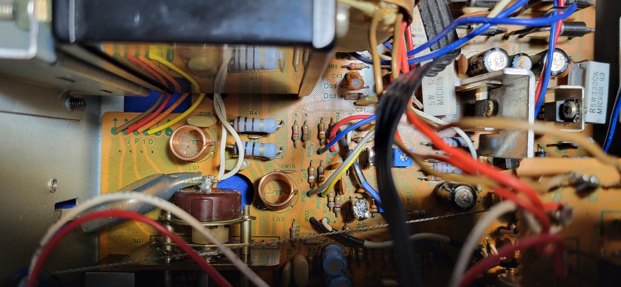

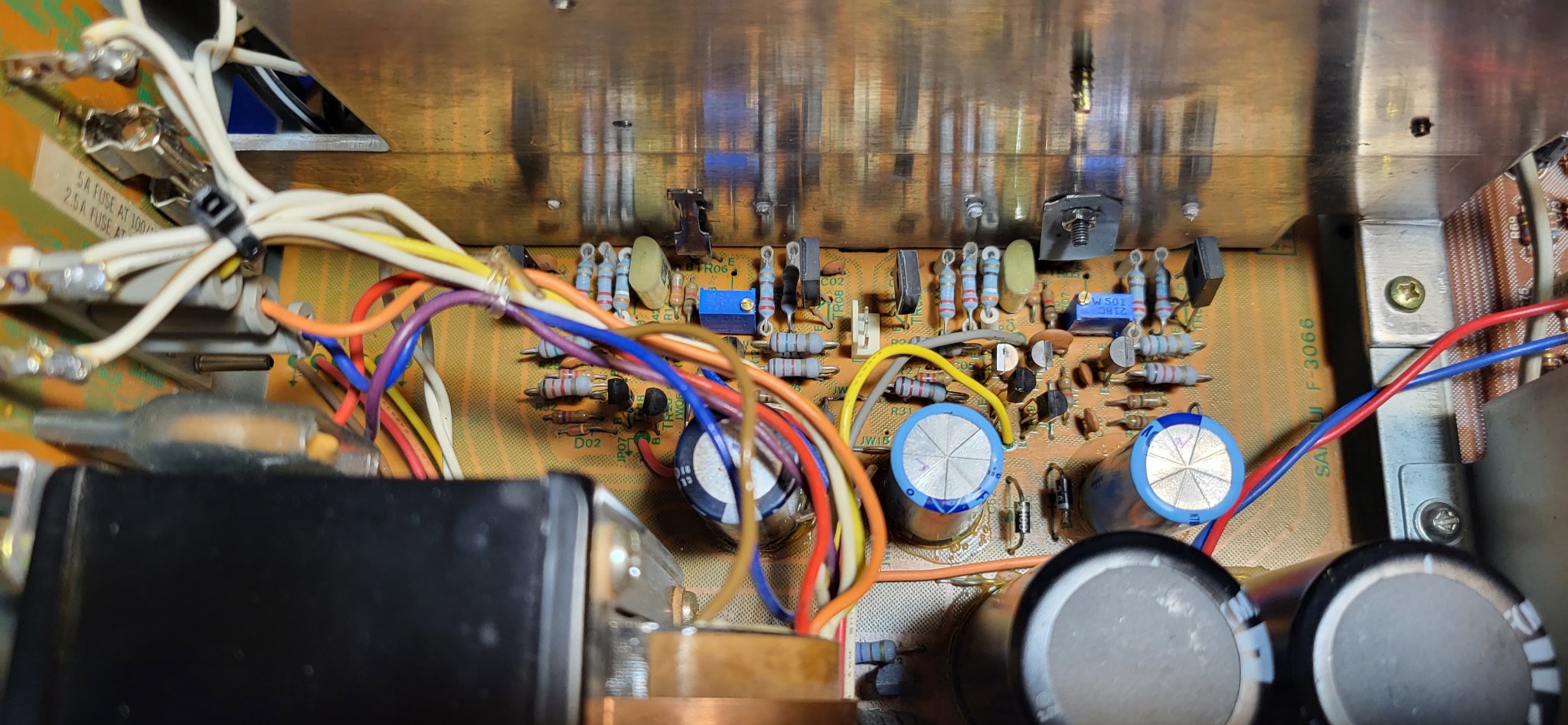

Pre-drivers are KSA modern transistors. I have also tried to isolate the power supply so that it will have "no load", again no difference..........attaching three pictures for the sake of it.
