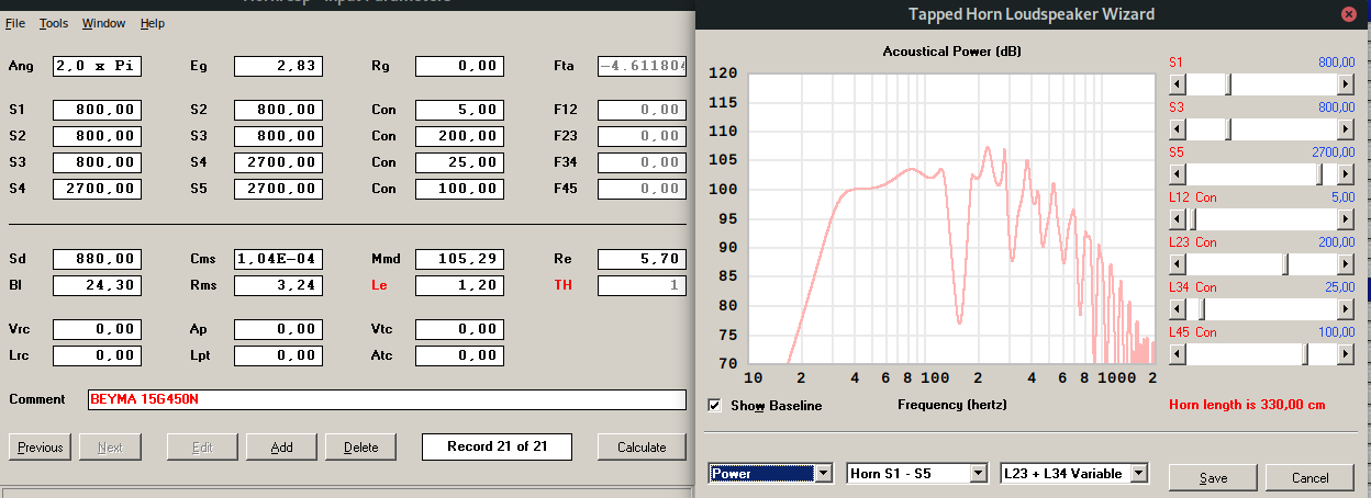

Hi all,
Please assist with hornresp input data for the attached.
I am looking for something that can beat the THAM15 in terms of SQ, SPL :D. I play electronic, reggae and jazz. I have 2 Beyma 15G450N.
  • esw1015 rcf hoornsub.pdf
If you are not afraid of a large box, then the Beyma 15G450 seems to fit in a "EDM"-tuned ROAR. Nice midbass punch centered around 80 Hz and a good 33 Hz extension downwards.
This will beat a THAM15 in every way except size and weight.
The next box I am building is a roar, I have one THAM and I love the way it sounds, loud, clean, musical bass. If you recall, I started a topic on the ROAR18. I am aware 1 ROAR = 2 THAM. :)
I just want to see how the ESW simulates.
