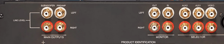

My audio system has always been multichannel surround built around a digital home theater processor. What I'd like to do is isolate two channel sources from multichannel sources and run two channel stereo CD player/DAC and turntable/Pearl 2 phono pre through the Iron Pre I'll be building and leave all the multichannel audio (TV, bluray, roku, etc) to the current surround processor while utilizing the same amps and speakers at all times.
A line level switcher would allow this, but currently my passive sub is driven by the processor as I'm utilizing all the xover and eq controls there so that complicates things. I could ignore the sub controls on the processor entirely and instead run the sub via MiniDSP for instance but I'd like to avoid that.
Surely I'm not the first nut to do this without wanting to unplug/plug RCA cables each time. What solutions have others created?

There are 3 channel video switchers for 2 to 4 inputs to 1 output. They have RCA jacks. They cost about $12 on ebay/amazon/aliexp about double in stores. Look for the red, white, yellow inputs. The yellow is video, but you don't have to use it. If you use the yellow for sub, red for right, white for left, there you are.
Challenge is still generating a subwoofer output from the processor while driving the two channel preamp from a strictly stereo output from the DAC or Pearl 2.
So do you want to run the sub with the 2 channel preamp? It is a lot simpler if you don’t want to use it.
you can use a pair of y splitter connect to the Pearl 2 output, one of the y splitter output go to one of the line level input of the B&K processor for subwoofer processing, the other output of the y Splitter go to RCA switcher.
Yes I do wish to run the sub. As you point out, if I ignore the sub for 2 channel the solution is simple.So do you want to run the sub with the 2 channel preamp? It is a lot simpler if you don’t want to use it.
There will be both the Pearl 2 output and a cd player/DAC on the two channel side. Using a y splitter from each to the B&K processor means that the processor also must have the correct input selected in addition to selecting an input on the 2 channel preamp. Perfectly functional but I wonder if I'm overlooking a more elegant solution?you can use a pair of y splitter connect to the Pearl 2 output, one of the y splitter output go to one of the line level input of the B&K processor for subwoofer processing, the other output of the y Splitter go to RCA switcher.
The solution above is the only one I can see unless I run the sub as a strictly two channel system via the left and right preamp outputs using MiniDSP or some other external subwoofer xover/eq box.
Through the processor your main speakers are typically high passed. Do you want the same through the preamp? If so I would add a 6-24 crossover, to keep the signal path analog, after the preamp then add a multi-way switch to switch before the amps.
Sorry, the y splitter should connect to the preamp output instead.
One advantage is you can turn off the sub by selecting a different input on the processor or change its volume level via remote control. Since the main speakers are running full range.
How about put it in your preamp, use a switch for "home theater pass through" and a set of subwoofer output.Perfectly functional but I wonder if I'm overlooking a more elegant solution?
