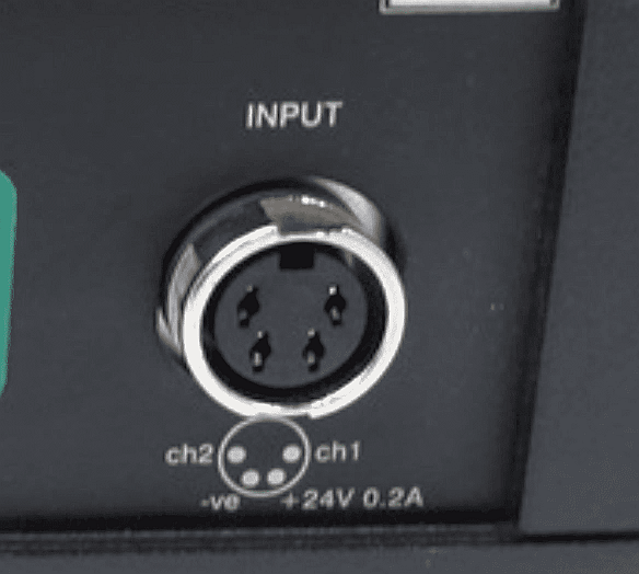

I want to connect a preamp with RCA outputs to a Naim NAP 150 power amp. Can someone tell me what the matching connection diagram looks like?

Ch 1 and Ch 2 are the two audio inputs (L, R) or the two balanced inputs for a balanced unit.
Check in the manual.
Also, check in the manual if that 0V - 24V is for an external preamp or whether it is an expected external power supply input.
Schematic?
Edit: I Googled it for you.
So the two inputs Ch1 and Ch2 to L and R RCA center, -Ve to each RCA ground, disregard the +24V output.
