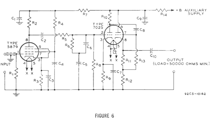

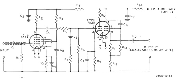

We are all familiar with the RCA tube manual and the RIAA pre amp in it. RCA also published another book "RCA Hi Fi Amp circuits". In this publication a modified RIAA pre amp with a cathode follower was added. It also used an 5879 tube as the input. Has anyone built this circuit? Is it a good sounding amp?

Perhaps you should include the schematic of this circuit as context for the question?
Is it the one on page 18 of this edition? http://www.tubebooks.org/file_downloads/RCA_HiFi.pdf

"LOAD = 50000 OHMS MIN"
Also, if you look at the cathode load resistor for the output stage 12AX7 in that circuit, it looks like its value is only 15k ohms. The voltage chart says there should be +19VDC on pin 8 (the cathode of the cathode follower section).
That means the plate current for that stage is 1.2mA, which is plausible. But a 12AX7 running with a 15k load? Yuck. I wonder if that was a mistake...

Pentode input is king for phono stages. Apart from that the circuit isn't that interesting and can be "bettered". To each their own but a CCS as anode load and gyrator on the screen grid instead of R4 should make it possible to remove R5 and to some people "sound better".
FWIW: the circuits in the RCA manual are all solid and will give solid results with little issues but they were aimed at industrial customers that buy 30000 tubes from RCA to deliver the crates of radios with the added phono input they are comissioned to deliver to the retail chain. So the focus is on ease of build, budget friendly, no need to fine tune anything, stable and (back then) serviceable.

The issue with pentodes in the 1st gain block of phono preamps is S/N performance. Partition noise is an unpleasant "fact of life". The nice EF86 is a marginal performer, in the 1st gain block role.
High gm is a plus, in the overall S/N performance "picture". At 1 mA./V., the gm of the 5879 is unimpressive. Those individuals accomplished at setting RIAA EQ networks up (I'm not) can consider the 6AC7, whose gm is a substantial 9 mA./V., for 1st gain block duty.

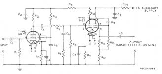

In post #3 (above) the circuit shown is the tape head version on p. 20; the RIAA is on p.18.Thank you Mark for pointing this out to me.
