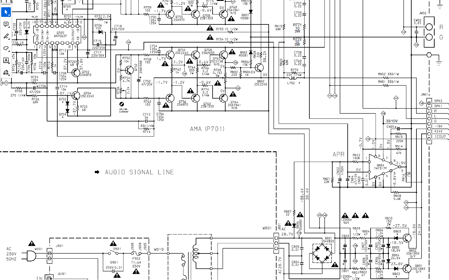

Hi, Hope some of you can help me with this.
I have a Marantz PM6010 KI Same PCB as the PM66 PM68 etc. I think.
There were some cracked traces around the rectifier. I've repaired the traces.
When I turn it on it can take a while for the protection relay to switch on, some times it does not, sometimes it's with in 20s. Maybe another trace/joint that I missed.
The main filter caps (C801 and C802) have a bit of a bulge in the top, so I will replace these.
I'm seeing 24-0-24 AC (ideal 28.7VAC) on the secondary before the rectifier and +36.5VDC -48VDC after the rectifier and on the power amp rails (should be +/-38.4VDC). This section is unregulated. I took these measurements with no load on the amp but, it still behaves the same with the speakers connected. When the relay clicks in the readings are the same.
Is this to be expected from these amps, is there a common fault that cusses this or is it what I suspect and caused by the a (probably) damaged rectifier and dead capacitors.
With the power delivery line losses and so forth I'm not surprised by the 24-0-24 and therefore the +36.5VDC. It's the -48VDC that is confusing me.

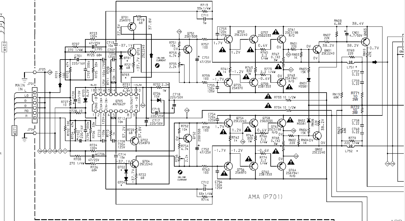

PSU and power amp right channel attached.

Are you sure you have not made some sort of mistake in your measurements?+36.5VDC -48VDC after the rectifier
If you are measuring -48VDC at test point 160, with respect to ground, then it's possible C802 has dried up, lost capacitance, or is open circuit.
It's always a good idea to check the bridge for opens/shorts too.

I seem to have fixed the offset but now both are high: took the main PCB out reworked some more of the joints. Took the main filter caps out and did basic check (as much as you can) with a standard multi meter: check for short, charge and discharge; both about the same, took the bridge rectifier out and checked that, tested ok.
Put the components back on the PCB turned The amp on relay not clicking.
Checked the rectifier bridge. 233Vac mains, 63.3vac across the rectifier (31.5vac and 31.4vac from each TX out to 0v should be 28.7V on both)
Checked with continuity that chassis and PCB GND are connected (which they are).
+42.3Vdc and -42.4vdc out of the bridge rectifier to Gnd.
Q761 & Q762 +42.2V, Q763 & Q764 -42.2V. The heat sinks are getting warm not hot as is the bridge rectifier.

This does not match your earlier post ("and +36.5VDC -48VDC after the rectifier ").+42.3Vdc and -42.4vdc out of the bridge rectifier to Gnd.
I would replace the rectifier caps before you go any further and get to a stable supply. There may be faults further into the circuit which are triggering protection and holding the relays off. When it does power up can you get to the output relays or amp outputs and measure the DC offset? This should be close to zero. If not you have other issues.

If you look at Q761 it should be +38.4 on the collector and on Q763 it should be -38.4 on the collector the same as TP157 and TP160. Which is where I originally measure +36.5VDC and -48VDC

So I've found the why the protection relay was not triggering, it was a dry joint between R801 and R802 in the PSU.
12mVDC at the speakers is acceptable on this amp so that was not triggering the protection circuit to go open, the voltage at TP146 was 0.4V not enough to trigger the relay.
TA7317P (QN04) is a Protection Circuit for OCL Power Amplifier and Speaker, this controls the speaker protection relay.
TP150 was about -18VDC, and TP149 was 0V. There was 0V on all three legs of Q801 and + 42Vdc at TP157 and 0V at R802.
Of course it did help when I nudged R801 while testing it and everything clicked in to life then clicked out of life.

Edit: as for the rail voltages, they are fine. It's an unregulated power supply so their actual value depends on the line voltage in your area.
That +/- 38.4 V is unregulated and probably based on a mains voltage of 230 V which the UK only has on paper but in reality maintained 240 V. Seeing +/-42 V, is hence not surprising. I wouldn't be bothered by a few V of difference as long as it stays below the caps voltage rating. Besides, our and your mains voltage is allowed to fluctuate up to 253 V to stay within code (which with all those solar panels around nowadays is almost a given on sunny spring and summer days, at least on our congested grid).So I've found the why the protection relay was not triggering, it was a dry joint between R801 and R802 in the PSU.

If I were replacing those caps, I might go up one step in voltage if size would allow it. But I'd probably first put them on my LCR meter and see if capacity and tanδ were still within spec. Those big caps are usually still fine after 25 years.
Wave soldering doesn't allow for much variation. Wave too high and you have a lot of shorts, too low and a lot of unsoldered joints remain that all need to be touched up by hand ($$$). Getting it right the first time is the most economical for the manufacturer.
Schematic says 28.7-0-28.7 VAC.
Assuming this is at 230 V, that's almost a perfect 8:1 primary:secondary ratio.
At 240 V this results in a secondary voltage of 30 VAC.
At 250 V this becomes 31.25 VAC. Rectified - 2 diode drops of 0.6 V leaves you with 43 VDC.
So the measured +/- 42 VDC are very possible and leads me to believe the mains voltage was around 246 V at the time of measurement.
