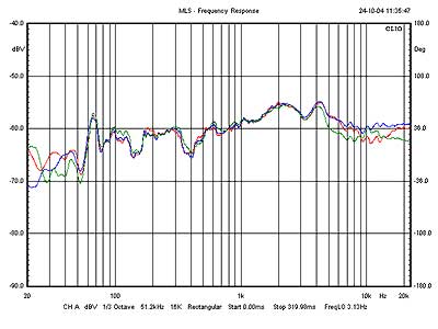

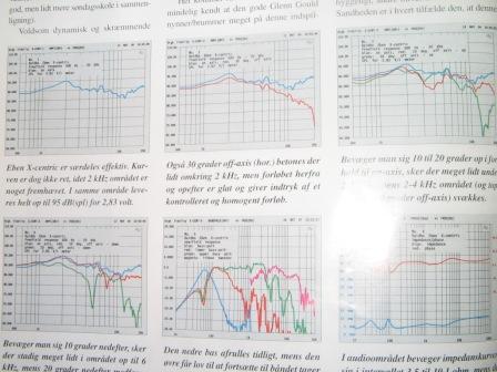

this is the reponse curve for the raidu tweeter 😉
http://www.hifi4all.dk/content/templates/test.asp?articleid=934&zoneid=3
ABJensen said:this is the reponse curve for the raidu tweeter 😉
Hi ABJensen,
Reg. the hifi4all test they measured the speaker in a very small room not knowing what they were doing. The measuring equipment only goes to 20 KHz, the mike was not calibrated for starters. The response is very flat there are no measurable distortion and no time smear.
