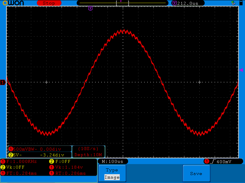

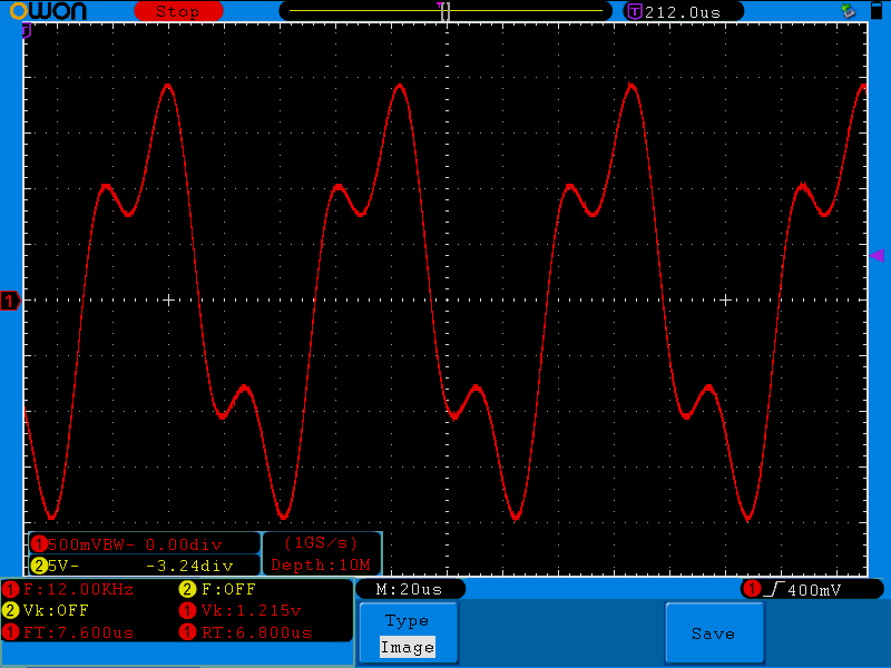

This is one thing those cheap boards are quite useful for.Hardware is not up yet, so I cannot test but if possible I want to finish the controller software beforehand.
I have observed the same behavior on the 9028Pro / 9038Pro, with 128fs mode enabled.
It looks like NOS, even though the different digital filters are still active.
Note that it comes with the classic NOS artifacting in the high frequencies. Doing a frequency sweep easily reveals that.
Plus almost sure it has the NOS high frequency roll-off (to be confirmed with measurements..).
