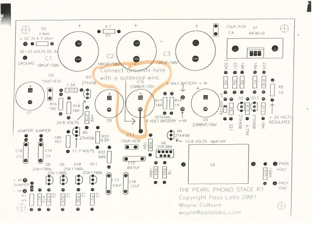

Dont forget the soldered wire from C15 to the GND solderpad!!!
The circuit says nothing, without it

Steen - or anybody else for that matter - you wrote that a wire should be soldered C15 to the GND solderpad - should the C15 negative be soldered to the solderpad, and THEN to ground ?? On the PC board there's a line between these points, but should the wire continiue to star ground ??

I have a drawing somewhere that shows the wire. Its a jumperwire on the PCB. There is a solderpad for it. I will dig up the drawing when I get a chance, and post again.should the C15 negative be soldered to the solderpad, and THEN to ground ??
