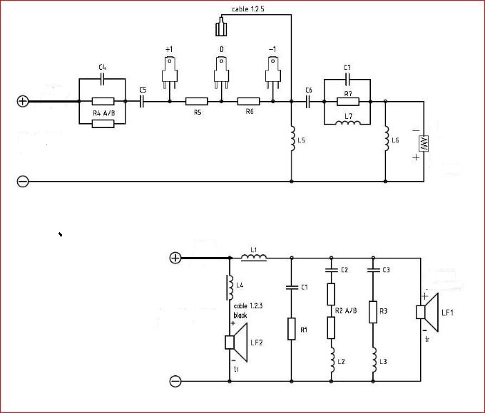

I've got a pair of speakers with 4th order HP on the tweeter at 2.7k and 2nd order LP at 2.7k on the upper mid/bass and first LP 1st order at 500hz on the lower bass.
The mid/bass and low bass drivers are in phase with the amp, but the tweeter is out of phase.
Got some terminal links coming that will allow me to easily reverse the tweeter so it will be in phase also, what will be the difference I can expect to hear?
Cheers George
