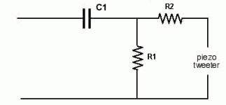

Piezo tweeters typically have an impedance of about 3k ohms (to the best of my memory).
You need a capacitor in series with the piezo to filter out lows, and you need a resistor combination (one series, one parallel) to balance the volume between the woofer and the tweeter. Personally I just use a L-Pad so it is easily adjustable.
Some people, myself included add a parallel resistor across the Piezo terminals to stabilize the impedance. I think I have 10 ohms across mine, but I have mine connected to a 3-way crossover and the crossover assumes that it is working with a roughly 8 ohm speakers.
Which brings up the final point, speaker impedances are all over the place. An 8 ohm speaker is 'nominally' 8 ohms, which means 'sort of' 8 ohms. The impedance across the operating frequency range will drop slightly below 8 ohms and go substantially above. However, I have seen consumer Hi-Fi speakers that drop as low as 3.5 ohms but are still rated as 8 ohm nominal.
If you search the Internet, you will find instructions on how to properly create a crossover, impedance stabilizer, and level control for a piezo tweeter.

what I have learned is piezo tweeters are very high impedance across there working range and after a certain level, 30 - 100khz they drop as low as 1 ohm and present problems to amps that run them
What I have read is to parallel an 8 ohm resister to stabilize the impedance, then before this paralleled 8 ohm resister is an 8 ohm L-pad,
Is this L-pad an attenuator of some sorts? to lower the piezo's efficiency, what is this L-pad what component is this

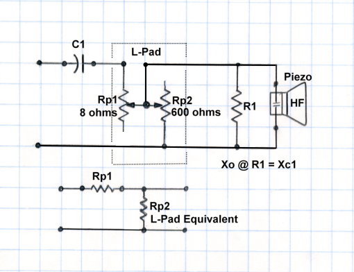

To make it easier for you to help me, Im going to use the
KSN1141A Piezo Tweeter and I'm going to 1st order highpass it at approx 2khz
So to make this usable and not so bad, im going to need some help from you guys I will try and understand to the best I can
So can someone help me with The L-pad and the circuit as a whole
I have a slight Idea of circuit order, the 1st order high pass, then the 8 ohm L-pad then the paralleled 8 ohm resister, is there more I need to add
Thanks Cya

An L-Pad is a constant impedance volume control for your tweeter.
In my case I have a 12" woofer, 3x9 mid-horn, and a 3x3 Piezo tweeter. The Tweeter is noticeably louder than the mid-horn, so I turn down the L-Pad until the relative volumes match.
An L-Pad always presents a constant load to the amp or to the crossover network regardless of where it is set. At full volume, you have a 600 ohm resistance in parallel with the amp and the tweeter. 600 ohms is substantially large enough to be effectively out of the circuit.
When the L-Pad is turned all the way down, the amp sees an 8 ohm load, and the tweeter is effectively out of the circuit. Thus maintaining a constant 8 ohm load to the amp/crossover across the full range of adjustment.
Because you will calculate your crossover frequency based on a known speaker load, you have to know what that load is.
You can put any resistor in parallel with the Piezo and use that resistor load to calculate your crossover components. Though, certainly some equivalent loads will produce ridiculous numbers for capacitors and coils.
I would say a capacitor connected to the L-Pad would insure stable cross over frequencies and limit the signal level to the piezo. I think the Piezo you picked has some built-in protection circuit to keep dangerous signal levels off of it, but it doesn't hurt to be cautions.
If you read the article linked to above by Peter, the Piezo page indicates that it is not necessary to terminate the piezo with an 8 ohm resistor. To some extent that is a waste of power. You could terminate the piezo with a 15 to 25 ohm power resistor and use a 16 ohm L-Pad, I think that would work fine.
16 ohm L-Pad
http://www.partsexpress.com/pe/showdetl.cfm?&Partnumber=260-254
I think even with the 10" woofer, the piezo is still going to be too loud and will definitely need an L-Pad to bring it down.
One other reason to put a resistor in parallel with the Piezo it that to the amp, unless I am mistaken, the Pieze looks like a capacitor which complicates matters.
Probably not much help, but there it is.

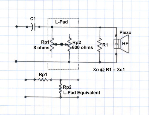

Attached is a drawing showing what your circuit should look like -
The Crossover occurs when the reactance (resistance equivalent) of the Capacitor equals the resistance of R1 (resistor across the piezo).
Your Piezo, unless my specs are wrong, has a natural crossover at abut 1.4khz which makes me wonder if your suggested 2k crossover is enough. If your woofer has sufficient frequency responce maybe 2.5k hz or 3k hz would be better. You need to remember that 6 db slope is very shallow and significant sound will occur far below and above the crossover points.
Because the crossover is so shallow, you could try tweeking the crossover points a bit. For example, the woofer could crossover at 2.2k hz and the tweeter could crossover at 2.0k hz. Though without a lot of components to play with or a computer modeling program, that might be too complicated.
The diagram I have enclosed is for a Parallel 1st Order Crossover, meaning, a capacitor in series with the Tweeter and a coil in series with the woofer. I think this is the most common type.
Also, as I already pointed out, you could use either an 8 ohm R1 and 8 ohm L-Pad, or a 16 ohm R1 and 16 ohm L-Pad.
Amended: Sorry, I just noticed an error in my diagram. It is the 'wiper' of the L-Pad that should go to the Tweeter.
Rp1 is connected to the capacitor and amp,
Rp2 is connected to ground,
the Wiper is connected to R1 and the Piezo.
steve/bluewizard
steve/bluewizard

I have used the KSN1141 quite a bit. Usually I have used Eminence 12" Gammas with them.
The x-o is fairly simple.
Just put a .56mH coil in line with the bass to roll off the top end.
Then use the circuit below with R1=22 ohms C1=3.9uF
R2 is then going to be used to balance the bass and tweeter, and will probably be around 30-50 ohms. It depends on the efficiency of the bass driver.
ps: do not use an 8ohm parallel to the piezo, you will drop its level too much.

I'll let Andy speak for himself, but think he is generalizing. By that I mean, he is not being really specific in his choice of words.
Putting an 8 ohm resistor in parallel with the Piezo will not reduce the signal level. Since they are in parallel both components get the exact same signal (or voltage). But since the Peizo is several hundred to a few thousand ohms, if is not drawing much current. The 8 ohm resistor, however, would be wasting some current unnecessarily. But keep in mind that it won't waste any more current than an 8 ohm speaker would have.
Since we have a nice high impedance tweeter, we might as well take advantage of it.
Notice the link I gave to a sample crossover that used a Piezo tweeter. They used a 20 and a 30 resistor (roughly) to drop the signal to about 60% of the original. Again, this is just another way of accomplishing what an L-Pad accomplishes. The problem is, a resistive network like this is fixed, so you better plan to have several resistors on hand to get the levels balanced between the woofer and tweeter. Again, for $10, it's much easier and more versatile to use an L-Pad.
So, in the example I linked to, the total load seen by the capacitor is 50 ohms (roughly), to find the crossover frequency, simply find out at what frequency the Capacitor is equal to the resistor. Notice that Andy also suggest using a 30 to 50 ohm resistor. Though to some extent I question whether his circuit is working the way he thinks it is.
Now my personal opinion, is that you use the configuration in my diagram, and to reduce wasted current, use a 16 ohm L-Pad and a roughly 16 ohm resistor.
Just a few thoughts.
Steve/bluewizard

Toast_Master said:What do you mean do not use an 8 ohm resister, "It will drop its level too much?" the ohm level or its spl? cause I thought having more ohms will drop it too much? can you explain?
Thanks Cya
Think.. if you put a near zero resist0r ACROSS the piezo, how much output do you think there would be??
If you put infinite resistance across, you get full output.
I have tried using an 8ohm resistor across the KSN1141, and it did not produce enough upper mids and top end to keep up with a pro woofer. Using 22ohms, it does. The R2 resistor in the circuit I posted is sort of a trimming resistor.
Remember that there is also a capacitor involved, which can be a lower value (less cost) if a 22ohm resistor is used across the piezo. You can calculate the value of the capacitor by assuming that the capacitor sees a resistance at x-o of a bit less than 22ohms.
