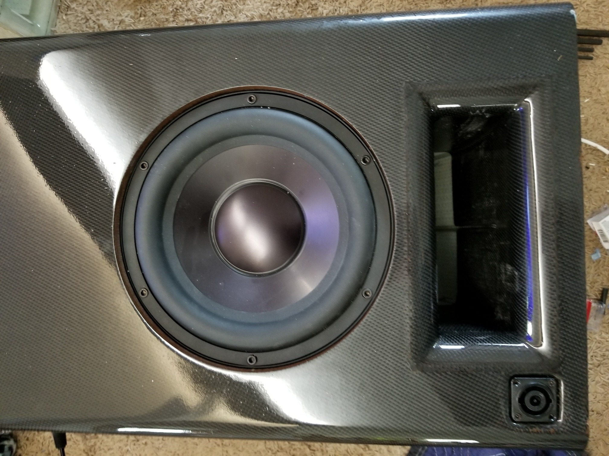

Part of the reason I'm going down this rabbit hole is because I once owned a Genelec 7060B subwoofer. It was technically excellent and played a tone pretty loud, but it just didn't have any impact.
With my design, I knew from the beginning that the 10" subs are the weakest link in the system.
The 10" subs are Dayton Audio RSS265hf-4s. They model at ~105dB from 20hz and up in my enclosure.
The other 2 subs are Eminence Lab 12s in sealed enclosures, and they model at 112dB @50hz.
If I changed to a 12" sub, it would probably be the Dayton RSS315hf-4 (12"), which would produce 110dB from 21hz.
I also like the way the 10" looks, although it's on the back so nobody will ever see it..... Here is the 10" sub and port outlet:
(It'll have a bezel around it eventually.....)

But did you see the drivers on the front of the box???That's a beautiful build and a beautiful driver. Pity you put it in the back of the box... 🙂.

That is a neat design for sure, but do you have both front and rear subs covering the same part of the spectrum? And how low do you run the coax 12"
This driver arrangement has the potential for good spectral response but right away I would suspect it has a negative impact on impulse response... so probably not a coincidence that that is what you are here asking about. Also interesting that you mentioned cardiod sub arrays, the one big downside with them is that they smear impulse resonse.

Nothing is set in stone right now. The working theory is that this is multiple subwoofers, so all for subwoofers are playing a summed signal from 20-100hz. I'm happy to discuss methods and share measurements, but preferrably under the other thread?That is a neat design for sure, but do you have both front and rear subs covering the same part of the spectrum? And how low do you run the coax 12"
