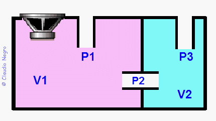

Perhaps you are referring to a 'single reflex bandpass enclosure' which is different from a normal reflex enclosure.
In a reflex bandpass enclosure, the woofer does not play directly into the listening area. Instead, it fires into a ported front chamber which acts as a low pass filter and acoustically limits the high frequency response.
In the DCR, all three ports have the same dimensions and the primary woofer chamber has twice the volume of the secondary chamber. The enclosure will resonate at two frequencies instead of one. The primary chamber is tuned to a highish frequency, but at lower frequencies the two chambers act as one large chamber providing an additional tuning of half that frequency. This double tuning provides bass reinforcement over a wider band of frequencies than is possible with a single ported reflex enclosure.
Now, what was the question again? :scratch:
