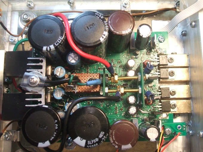

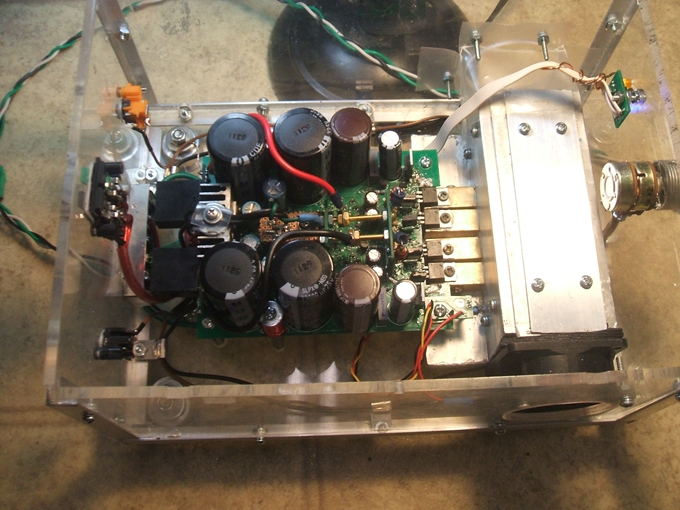

I have done, at least with Mosfets, it seems a bit of improvement on typical thermal mounting Here & Here & Here. It is interesting to note that with the type of transistor used here, there are typically two versions with identical datasheets except one is in TO-220 and the other is TO-247. The only difference is Pd. Here I have taken the TO-220 version (they are quite a bit cheaper😀) and mounted them directly to small blocks of (at least 80Cu/20Zn) brass with grease. The blocks are insulated by mica and grease from the heatsink. In an audio power amplifier output transistor, Pd dissipation occurs in spikes. That is, Pd is great but with a short duty cycle. Because the brass is a dense metal, it acts like a filter capacitor in the thermal transfer trading a lower maximum temperature for a higher average temperature. In addition, the surface area of the brass in contact to the heatsink is 3 whole TO-220 mica pads, greatly increasing the surface area thus reducing the overall ‘resistance’ of the mica pads in the thermal transfer. Effectively, to a degree, I have made them into larger transistors. Geek speak translation: I can achieve >70W of output power from just one pair of TO-220 devices.🙂
