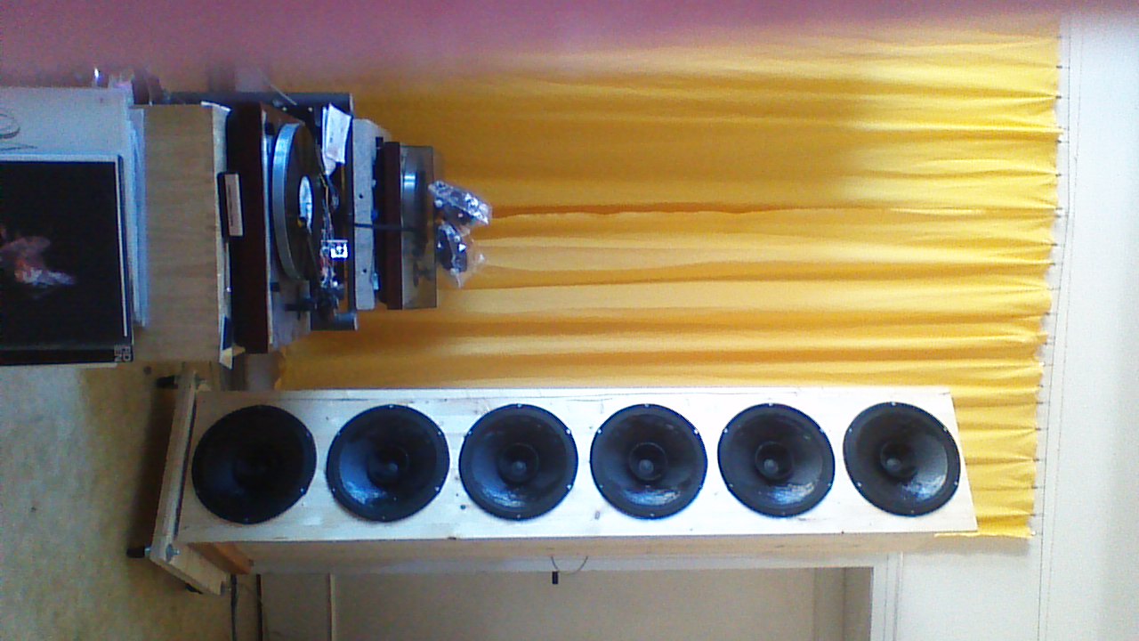

This is a pro sound application. Dipole losses are very real and suggesting a dipole subwoofer for a prosound application is ridiculous, it won't work.
Looking at your pictures, it appears that you have 12 drivers that are at least 12 inch, maybe 15 inch drivers in a very small room. THIS is exactly why a dipole subwoofer for a prosound application simply isn't going to work.

The dipole cancellation phenomena is well understood, well documented, and very real. Anyone who has actually used a dipole speaker or subwoofer should know very well that they are output limited below the baffle step frequency due to cancellation. Using them in a small room will obviously net some benefit above the Schroeder frequency due to reflections and modes but dipole cancellation is very real and it does take a huge toll below the baffle step frequency.
With regular normal placement in a room the dipole cancellations will happen right at the edge of the baffle, long before the waves ever get to the boundary reflection points. So whatever is left after the cancellation can be reflected and can cause room modes but in any normal situation the cancellation occurs long before the waves ever reach the walls of the room.
It may be an inconvenient fact for you, but measurements do match the math on this subject and it can all be easily simulated. I have a wealth of experience with dipole speakers and subs, the measurements don't lie, they directly support the theory.
Your 1 meter square dipole panels are no exception. Due to their huge size the baffle step frequency is quite low. This is a baffle diffraction profile of a 1 meter square baffle with the entire surface area radiation source, like your ESL panels.
As you can very clearly see there ARE no losses until you get lower than 140 hz. THIS is why you didn't notice or measure any losses in the panel's passband when only used above 140 hz. The theory isn't wrong, you just don't understand it. The losses below 140 hz, below the baffle step frequency are significant.
Maybe ask yourself why you chose 140 hz as a lower limit to use these panels. Was it a manufacturer's recommendation? Was it because they don't do well below 140 hz? It seems strangely convenient that you chose 140 hz to use as a crossover point when the theory indicates that 140 hz is the lower limit to the diffraction profile's flat response and below 140 hz the diffraction profile takes a nosedive into very low spl territory. This can't be coincidence. This is dipole cancellation theory in full effect providing real world measurable results that match the theory.
As for your dipole subwoofer, it's a unique case of a massive baffle size located parallel and only a few inches from a wall. It's not a true dipole in that sense, it's actually just as similar to a bandpass as a dipole because it does have an acoustic load on the cone provided by the air between the massive baffle and the wall.
The theory is not wrong, the measurements match the theory and the sims match the measurements. The problem is that you don't understand the theory.

In room it IS a problem. If you want to play flat lower than the baffle step frequency the driver qts (or eq) has to provide the extra gain to keep the response flat. This comes at the HUGE price of MASSIVE excursion below the baffle step frequency. MJK's open baffle papers show this clearly but don't focus on the excursion required to keep the response flat below baffle step. http://www.quarter-wave.com/OBs/OB_Design.pdf
This is all very simple to simulate too, and measurements match the sims.

Dipole subs aren't going to work for PA applications.
Example - I put a pair of Beyma 15P1200Nd on OBs, one per side. EQ'd to 20Hz, cone excursion got to 30mm p/p and they were pulling around 300w per driver. Decent listening volume, but not excessive.
The same drivers in small sealed boxes make the house (old, solid stone walls) make complaining noises, and go louder than you'd ever need in a domestic environment.
The OB setup was a little cleaner at low volumes - next to no room interaction meant that the LF there was very very good. Headroom was a huge problem, though. As I said, 30mm p/p travel on peaks at LF when turned up a bit. Linear travel is 19mm p/p, so the peaks were likely being compressed.
Back on-topic, which is fixing the 2x15 subs.
I'd recommend gluing triangles into the joins where the cabinet walls meet. Do lots of them. You'll increase the strength of the joints hugely.
Putting cross-bracing inside a constructed cabinet will be difficult, but not impossible. This will help stop the panels bending.
Use good wood glue, and (if you haven't done already) go along all the joins in the wood you have already. Use lots and wood glue - its very strong.
