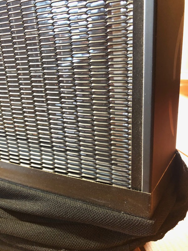

Is it possible that the panels were rebuilt by someone before? do the diaphragms look darkly coating with a graphite type coating? what you are describing sounds like the diaphragms aren't charging up. IT could be the power supplies, but both playing softly really sounds like a diaphragm coating issue

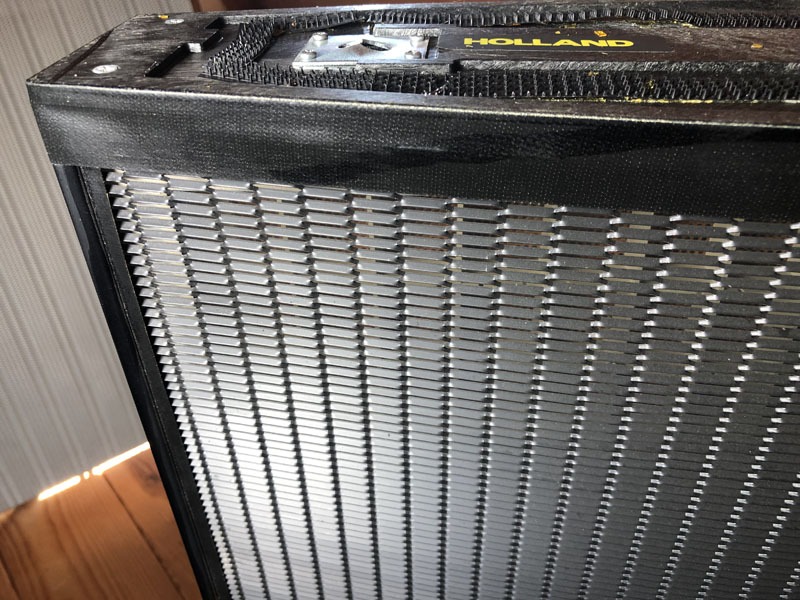

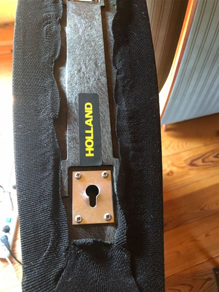

Having the plates removed the cloth looks really tidy. As if the 63s are never been undressed since their assembly in Huntingdon.
I have to strip them anyway to check the dust covers. Who knows what's hidden underneath.

For what I can see these are never opened before. The glue under the velcro was crackling and the tape has no irregularities what so ever. There are no markings of any rebuild. I neither discover darkish coatings. So I think we can rule out the diagram coatings?
