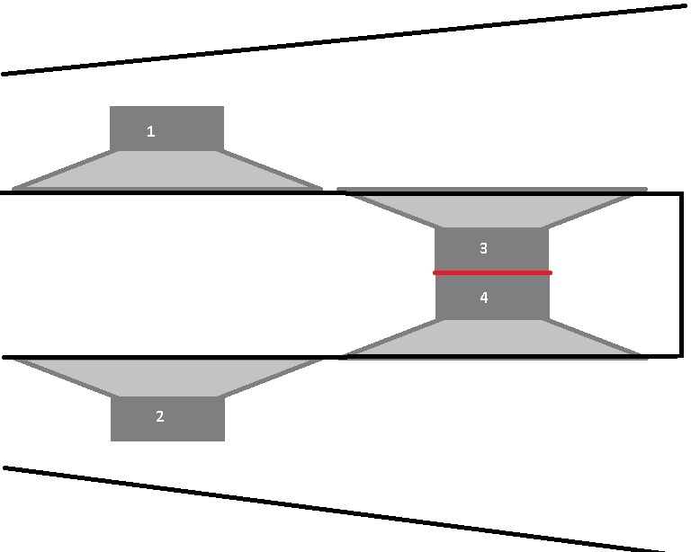

I'm working up my latest tapped horn sub design, and am planning to use 4 Lab12C drivers. I want them to operate in a push-pull arrangement, as well as having opposing pairs cancel mechanical vibration, so I came up with the configuration I'm showing in this rough paint drawing (not at the real computer currently, so no real drawing I'll post yet)
I find myself wondering if there is a critical distance that I need to remain above for space between the magnets on drivers #3 & #4 (the red line)? I'm envisioning some sort of interaction between their magnetic fields that might be problematic, but real world advice as to whether I'm imagining things or if it's an issue known to those with better brains & more experience would be appreciated.

This way the heat from the pole will not effect the other woofer. Mounting the woofers with their magnets butted together could cause them to over heat before the other two woofers.
Your and TB46 suggestion is definitely the way to go, in regards to symmetrical loading, the heat issue and the plenum volume can be reduced by half (or more).
A plenum as large as required in the OP would be a big waste of space, it would need to be around 14 inches across to leave some cooling room.
thanks guys, I guess the unilateral opinion is cooling is likely to be more of a problem than magnetic field interaction & I should solve both by inverting a pair of drivers. I was looking to place the drivers so that mechanical cabinet vibration would cancel completely, but I may be splitting invisible hairs.

... I was looking to place the drivers so that mechanical cabinet vibration would cancel completely, but I may be splitting invisible hairs. ...
You still get the cancellation when the drivers are configured as in JLH's drawing. I don't think you can ever get rid of it completely, so don't worry about the asymmetric placement, you wouldn't be able to tell the difference.
yeah, I realize it still effectively cancels in the other configuration. It's probably a symptom of insanity that makes me drift towards exact symmetry. I cant help but envision the minuscule residual forces caused by the angular differences in complementary motor alignments, although they do also cancel, they exist before they cancel...and even smaller amounts of those forces will actually be transferred into the rest of the cabinet by virtue of it not being symmetrical to that pair of motors. I know it is infinitismal relative to the rest of the energy in question, but there it is anyway. So I have to continually poke myself to ignore the fact that they aren't in perfect physical alignment.

You need to wire the drivers so that they "move as a complimentary pair" or as one moves in the other one nested in it moves out.
The nested cones are still in anti-phase.
You still have the same cancellation as the speakers need to move the same way they did before.
It is just that one is "backwards" now compared to the way it was before.
