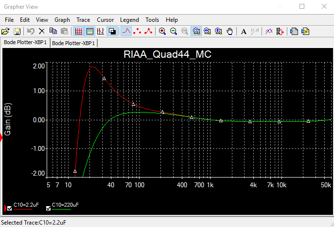

This is what it looks like but it is possible that these are older boards. I think the metal can transistors were used in very early versions. Probably as at that time there were the one only available as very low noise devices.

Schematic on page 21 of the service manual -- i don't have the new issue of "The Art of Electronics" at hand (lists popular transistors by noise level), but there are some nice TO-92 transistors from Zetex and a DIP packageThatcorp (That340 -- matched P and N pairs) that would work in the same space.

> I do not see any switches to adjust the input impedance
If Jack's schematic is correct....
You "switch impedance" by changing parts on the PCB. (Or by buying different sub-model modules, but that is no longer an option.)
If you like nominal 300uV sensitivity, you simply change R1 R2.
For extra precision, C1 and C2 may be changed.
If you run multiple cartridges of similar output, R1R2C1C2 can be on a (high quality!) switch or a plugin-module.
If you need 100uV sensitivity, the list of changes grows. R13 R14 made smaller to boost gain, but that seems to ripple-through the NFB network. Obviously all these values were well-considered and should be followed. Obviously 300uV/100uV switching is a nightmare.
The BC440 transistor is known to me, though long ago. Data says 2A and hFE 40-250. If we sort-off the lowest-hFE units this will be a fine low-Z microphone input device. At the lower Z of MC windings, even the low-end hFE devices won't hiss much.
Other devices are now more common, but they tend to a similar spec. A "maximum" current FAR-FAR higher than a few mA implies low parasitic resistance and low congestion in the crystal. A high hFE leads to a broader range of high impedances at which it can give near-theoretical low hiss; may not matter with low-low source impedances.
Metal can or plastic blob is surely indifferent. There's no heat and the environment is benign. The crystal inside is what counts. I'm sure QUAD tested not only several likely types but several batches of each type to find good types, and further tested each device for excess hiss.
