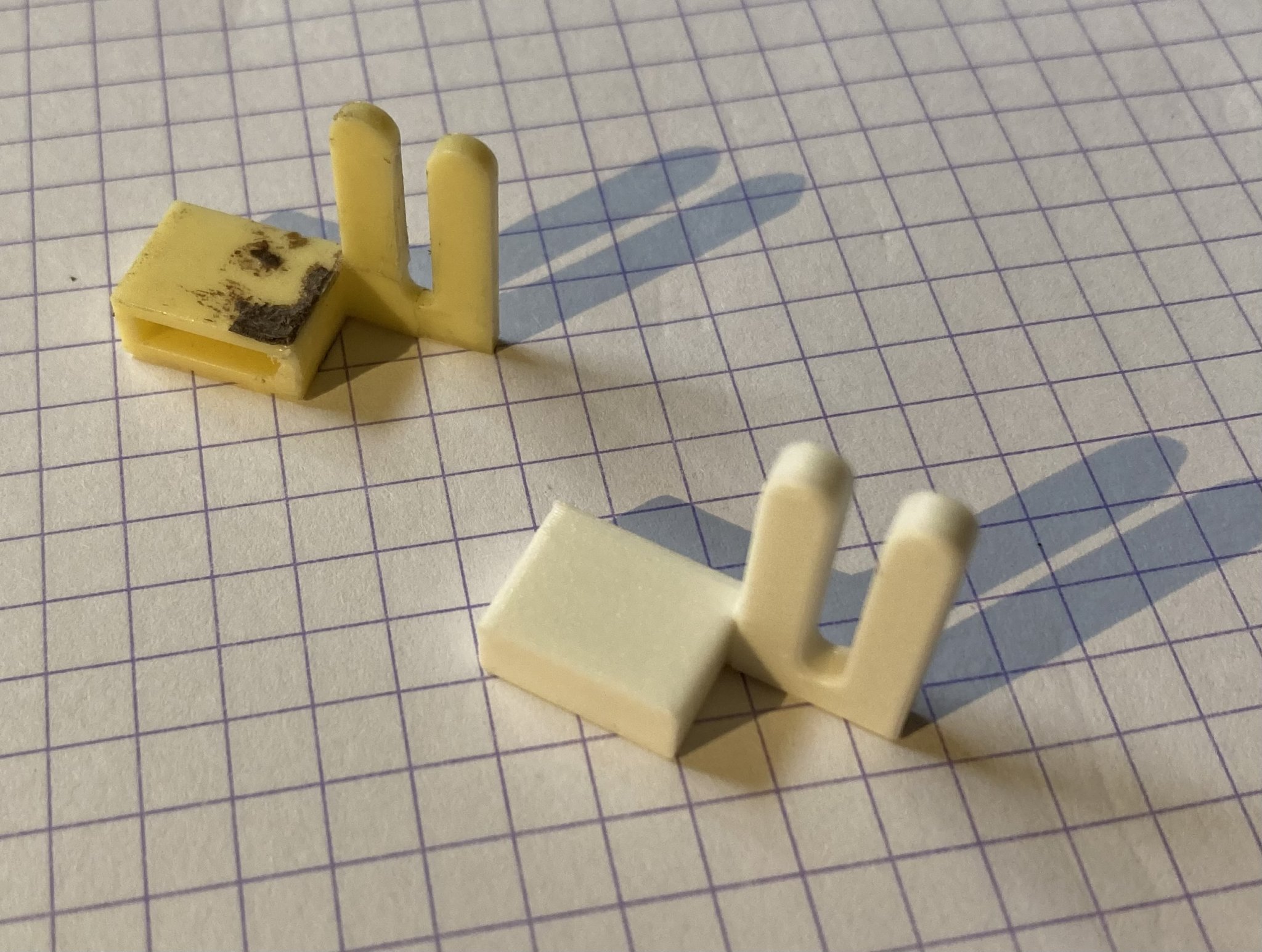

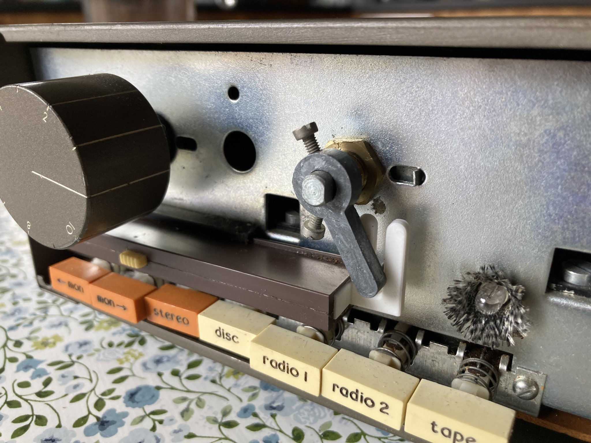

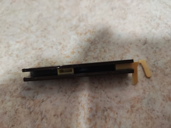

i need 3d model of balance mechanism for quad33, or only model of top part and i will glue it on my broken, there is no more 3d model online i check every place, was before year or so on few pages but now its not available online anymore so need help, dont wnat o buy new part this is easy fix so need help if anyone can send me 3d model

Yes, as the grease in the slider gets stiffer with ageing, more force needs to be applied and the “fork” cracks eventually.
You could cut/file/drill/route the part from an aluminium sheet, that is what I did about ten years ago.
I can draw you a 3D model, but I’m only back at my desktop computer tomorrow. Have a little patience.

Just this: the Quad 33 is a nice good looking little preamp (hence a re-issue), but a bit limited for current digital sources at a level of up to 2V with it’s single-rail supply of around 11V. Input sensitivity is 100mV, easy to overload. Also the phono preamp and the tape input/output have certain limits. It is a good idea to restore one but do not expect the ultimate sound experience from it. I’ll see to that 3D drawing today.

I’ve made the two bits of the “fork” a bit thicker (2.5 mm instead of ca. 1.65 mm) to make them stronger.
The original one appeared to have been glued already, so I took the occasion to test my print result.
You can pry the old block out of the slider using a sharp knife, cutting the old glue. It comes off easily.
