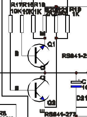

This transistor seems to be in the left channel signal path. I thought it was only the tape out buffer, but not sure--lack a good schematic.

The part number seems to be an internal part number. VN10LP is a diode part number, but the schematic I have shows transistors a this location. Any idea what transistor Quad used here? Or a good cross reference?

Wow, that's wild... Quad used the wrong schematic symbol:
It's odd that my Google search turned up a part with the same number as a diode.. Gotta check to see if this part is available in the US.
