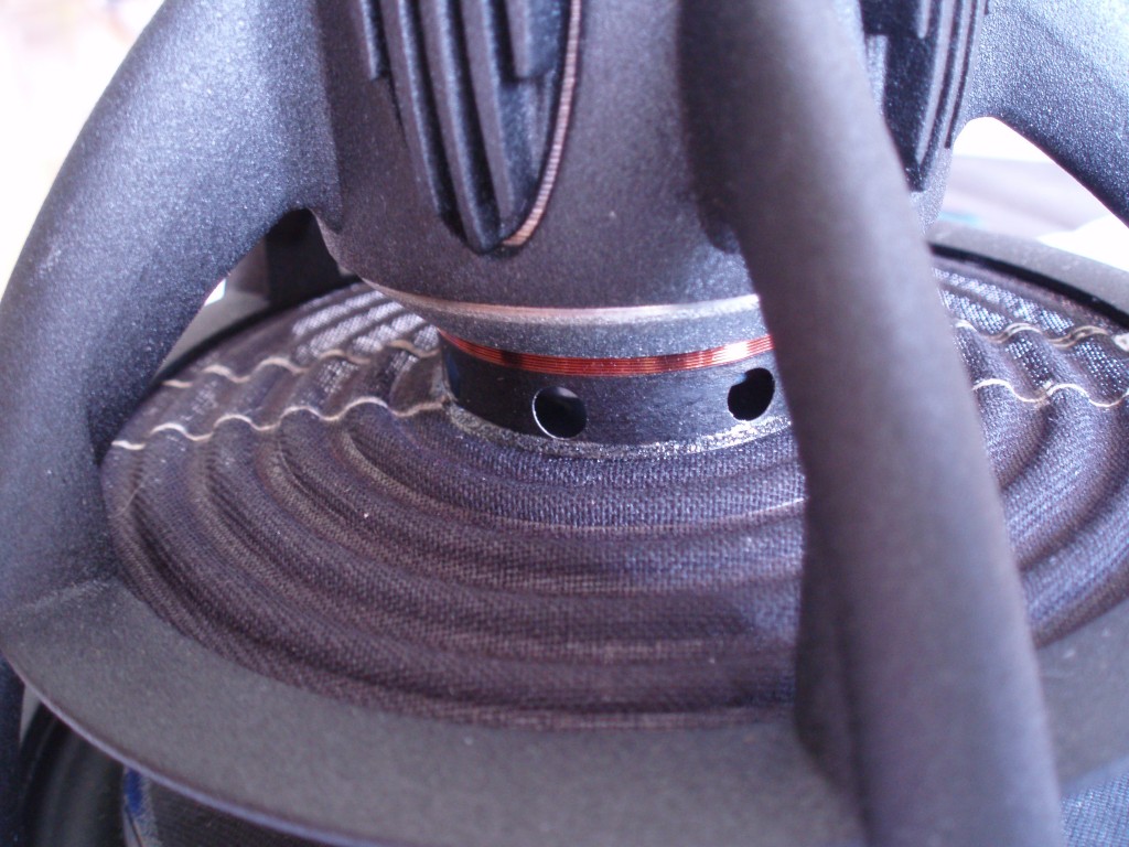

Many woofers and midranges employ some type of rear cone and/or motor air venting for cooling and/or to vent the dust cap air. I can hear this air noise, and so I send it to the back wave where is it less noticable. Most speakers are designed for closed box operation where the vent huffing can be contained. Speakers with phase plugs, even large woofers like the Lambda TD15D, often have the lowest air noise.
