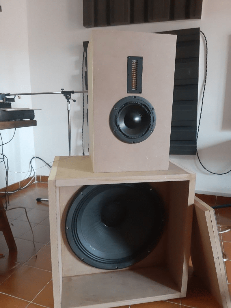

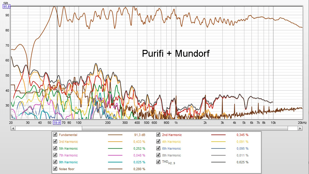

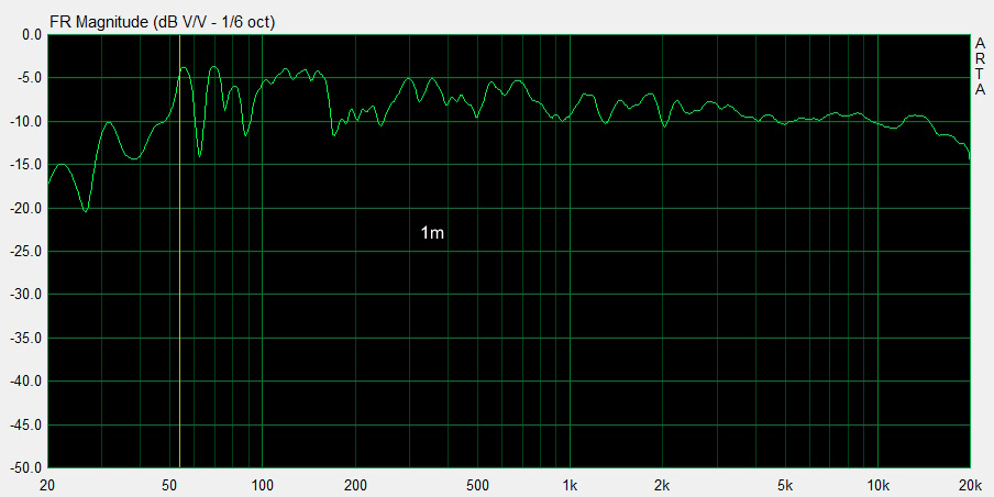

I would like to share with you the my good experience with these drivers able to give extreme performances better than Ceramic drivers.
The distortion is considerably less than that present on my ceramic drivers and I'm not talking about something just measurable but a substantial improvement in listening.
The Purifi mid-woofer integrates perfectly with the AMT tweeter returning a fast and detailed mid-range with plenty of separation between the instruments.

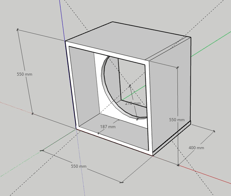

I will share the complete project with a H-frame dipole subwoofer created with a normal pro 18" and active filter.

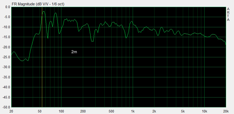

about 1mWhat are other conditions of ceramic vs. Pufifi measuremnts, how far from speakers was mic, is level actual level at measuring point or normalized?
same output level and same position for both system

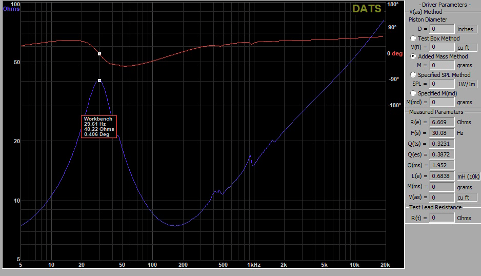

which 18inch driver is that in the h frame how do you rate the sound from that one ?

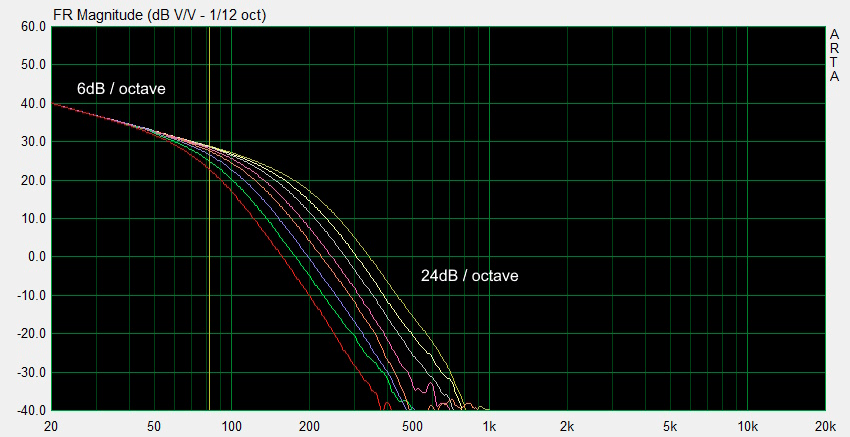

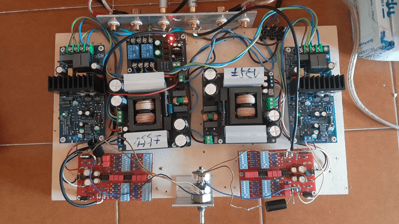

I have used an old K.C.S. 18" S-1846 woofer with active filter to compensate the dipole

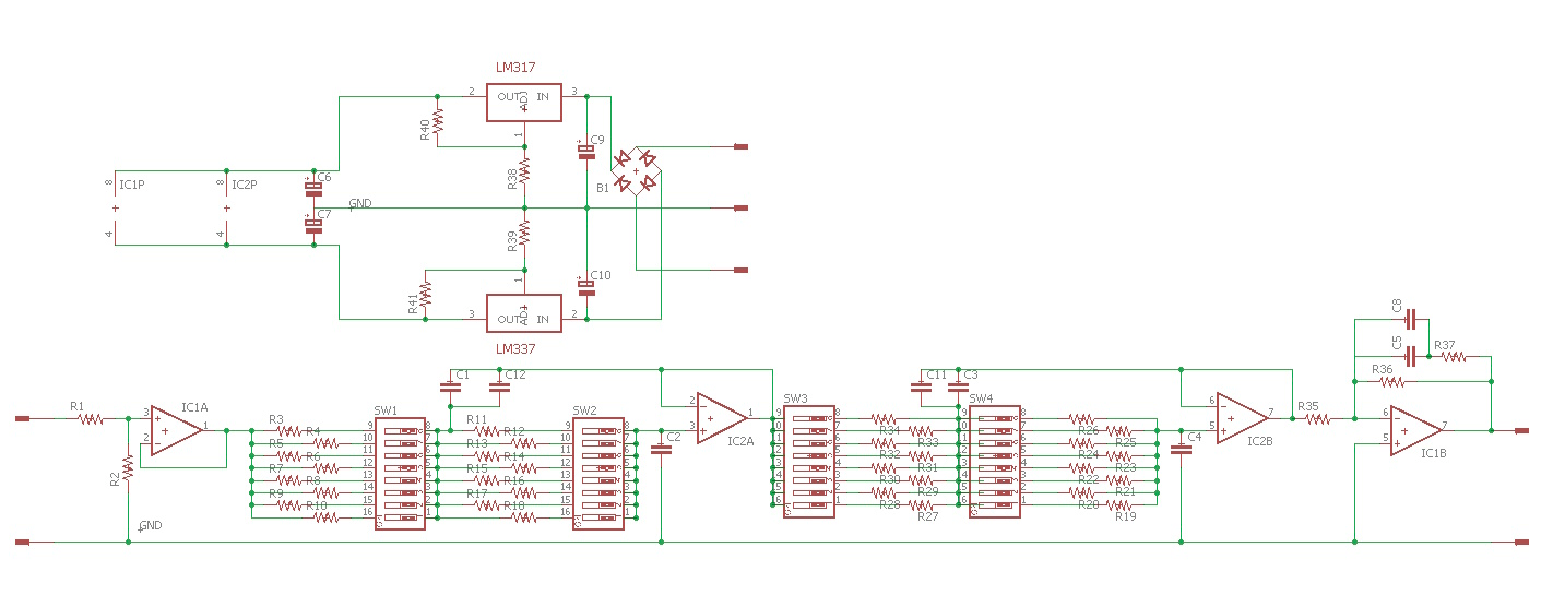

n. | C1 (nF) | C2 = 2xC1 | R1 and R2 | C1 (F) | C2 (F) | F (Hz) |
1 | 150 | 300 | 3570 | 0,000000150 | 0,0000003 | 210,0 |
2 | 150 | 300 | 4120 | 0,000000150 | 0,0000003 | 182,0 |
3 | 150 | 300 | 4700 | 0,000000150 | 0,0000003 | 159,5 |
4 | 150 | 300 | 5490 | 0,000000150 | 0,0000003 | 136,6 |
5 | 150 | 300 | 6200 | 0,000000150 | 0,0000003 | 120,9 |
6 | 150 | 300 | 7150 | 0,000000150 | 0,0000003 | 104,9 |
7 | 150 | 300 | 8250 | 0,000000150 | 0,0000003 | 90,9 |
8 | 150 | 300 | 9530 | 0,000000150 | 0,0000003 | 78,7 |
R2 100Kohm 1/4W 1%
R3,R11,R19,R27 3570ohm 1/4W 1%
R4,R12,R20,R28 4120ohm 1/4W 1%
R5,R13,R21,R29 4700ohm 1/4W 1%
R6,R14,R22,R30 5490ohm 1/4W 1%
R7,R15,R23,R31 6200ohm 1/4W 1%
R8,R16,R24,R32 7150ohm 1/4W 1%
R9,R17,R25,R33 8250ohm 1/4W 1%
R10,R18,R26,R34 9530ohm 1/4W 1%
R40,R41 270ohm 1/4W 1%
R38,R39 3000ohm 1/4W 1%
R36 56Kohm 1/4W 1%
R35 3Kohm 1/4W 1%
R37 0ohm
C1,C2,C3.C4,C11,C12 0.15uF WIMA MKP
C5,C8 0.22uF WIMA MKP
C6,C7 470uF 35V
C9,C10 100uF 25V
IC1,IC2 NE5532
U$1 LM317
U$2 LM337
B1 diode bridge 1A
SW1,SW2,SW3,SW4 dip switch 8 way
Gerber and Eagle CAD files are available.
