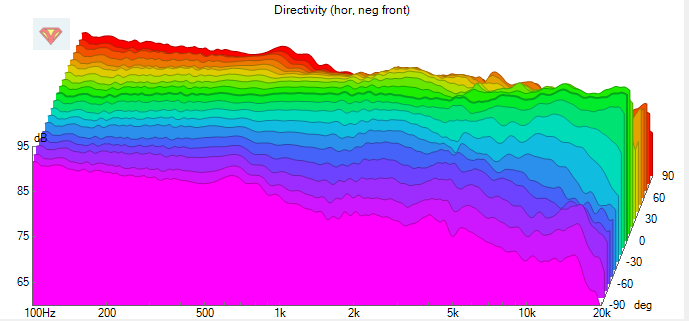

wowo,

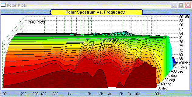

one directivity is not equal to all others. Note that with Earl's waveguide SP levels fall quite constantly with increasing off-axis angles. This is not the case with dipoles, where SPL tends to fall off mostly above 45°. While your considerations may be true at 60°, they don't equally apply for 30°. With a true dipole you simply won't get a sweet spot as wide as with a OS WG.
Just toe in the baffles so that the driver axes meet well in front of you and hope for the best.
About Linkwitz: I don't buy his argument about the 30° sensitivity. I rather believe that it is a blooming of his dipole pattern, caused by the overly wide baffle, which makes his reflected sound top-heavy. We would need to see some polar response measurement of the Orion++ to verify this, but I don't know of any.

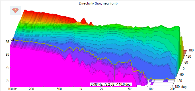

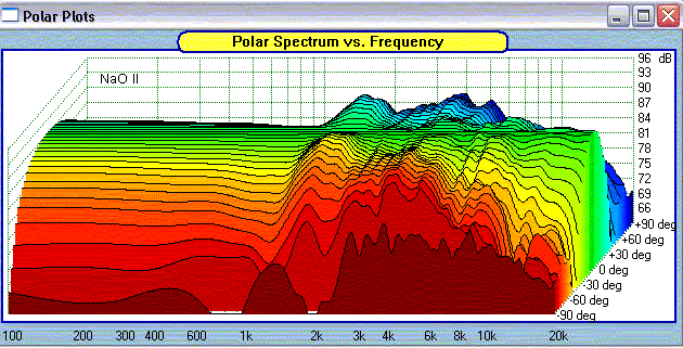

I think this may be a good time for me to chime in on this. I tend to agree with you about the blooming. As you may be aware I am working on my new speaker, the NaO Note, which maintains fairly good dipole directivity to about 8 kHz before the pattern stars to narrow at higher frequency. When I listened to the Note in comparison to my older design, the NaO II, I noticed that it sounded different to a greater extent than I imagined. The NaO II has an ESL quality to it. Like the Orion, the radiation pattern blooms to the sides above the crossover point due to the wider dispersion of the conventional dome tweeter. The Note sounds more natural to me. I found myself wanting to understand what the source of the difference was. The Note has exceptionally flat on axis response. The NaO II has a little more irregularity above 4k Hz. I thought that perhaps this was the cause.
What I did was to use some DSP software from SoundEasy and corrected the response of both speakers to ruler flat on axis with matched levels and listened. The difference was still present even though the direct sound was identical. The conclusion can only be that the difference is due to the difference in radiation patterns of the NaO II and the NaO Note above 2k Hz or so, and particularly in the 2+ to 8 k Hz range. If fact I can make the Note sound like the NaO II by boosting the high frequency response of the Note, or I can make the NaO II sound more like the Note by cutting the NaO II tweeter level. Thus the difference in sound seems to be more associated with the total radiated power above the mid to tweeter crossover than with anything related to the direct sound. The NaO II is similar to the Orion, dipole mid with conventional tweeter, but the crossover point is higher in the NaO II, which was initially intended to help counter the high frequency blooming.
Having the NaO Note alongside the NaO II and being able to able to digitally correct the axial response of both systems to be identical has show how significant variation is the polar response is on the sound.
The polar plots of the Note can be found here. The polar response of the NaO II here.

Earl Geddes had presented an application with some plots indicative of the polar response. There was some question about the on axis response which he corrected. However, it would be safe to say that the Orion polar plots woudl look much like the NaO II when normalized by the on axis response. Since the Orion and the NaO II use the same tweeter the dispersion is going to be very similar. On thing different about the NaO II and the Orion is the NaO II uses a narrower baffle.

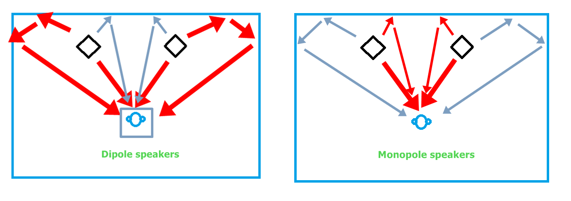

I agree here too - I don't know why SL offered the explanation he did, because it should have been very obvious to him (and other with dipole measurement experience) that between 1-4kHz, the Orions have irregular polar patterns. No wonder they need to be tweaked by ear in this region. I was surprised right from when he posted his update, because he has been one of the biggest proponents of the importance of the off-axis response.
Brilliant work John. For a while now, I've suspected that the total radiate power may actually have a bigger impact on the sound than the direct ("flat") response.
