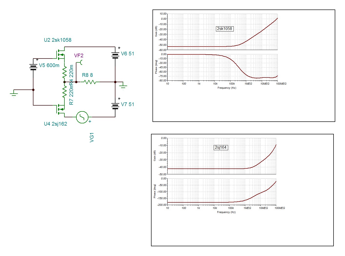

These lateral MOSFETs are very commonly used on this forum, has anyone noticed the very poor power supply ripple rejection? Any solution? The feedback is bringing down to -90 db only if the gates are driven by high impedance.

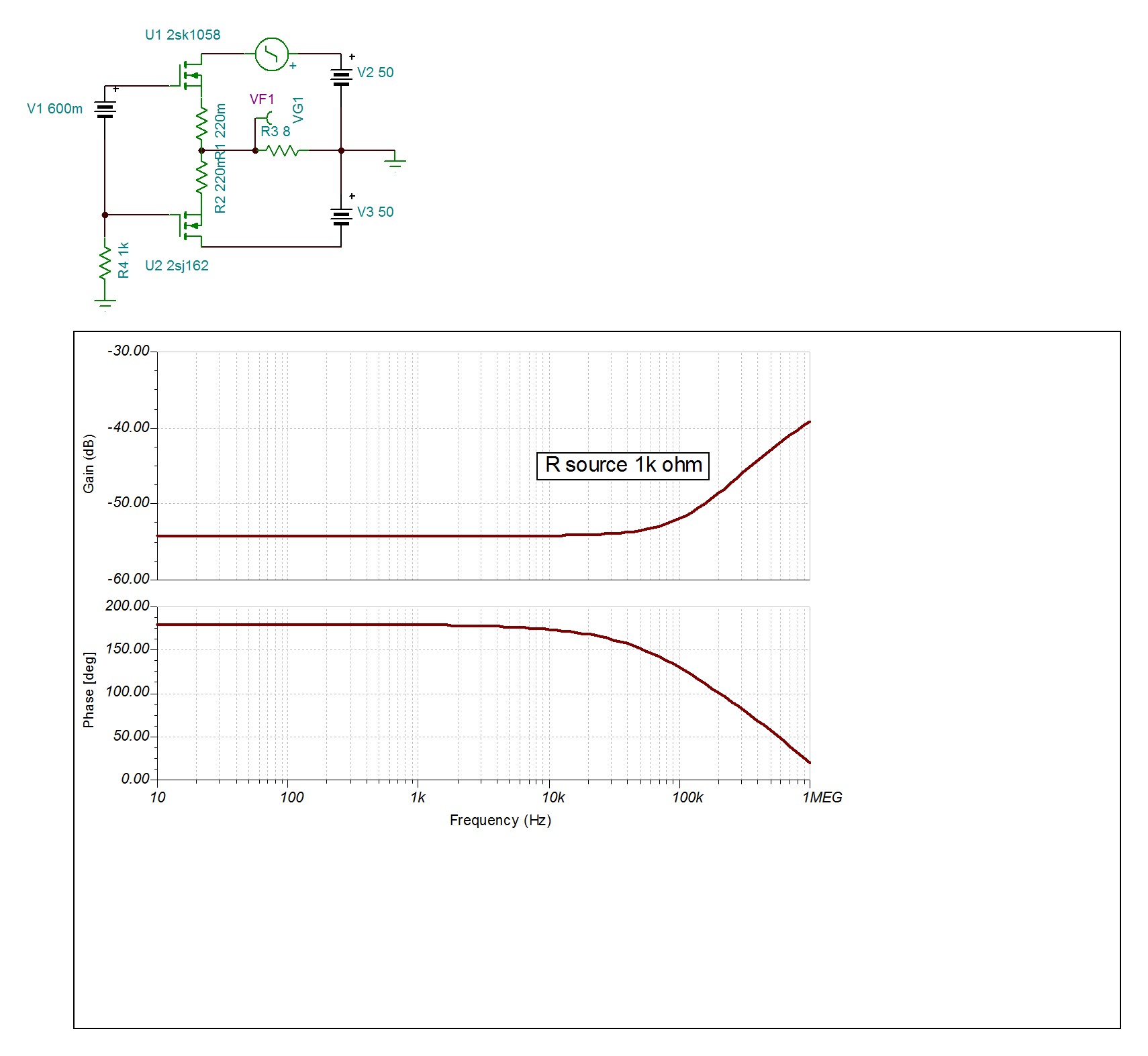

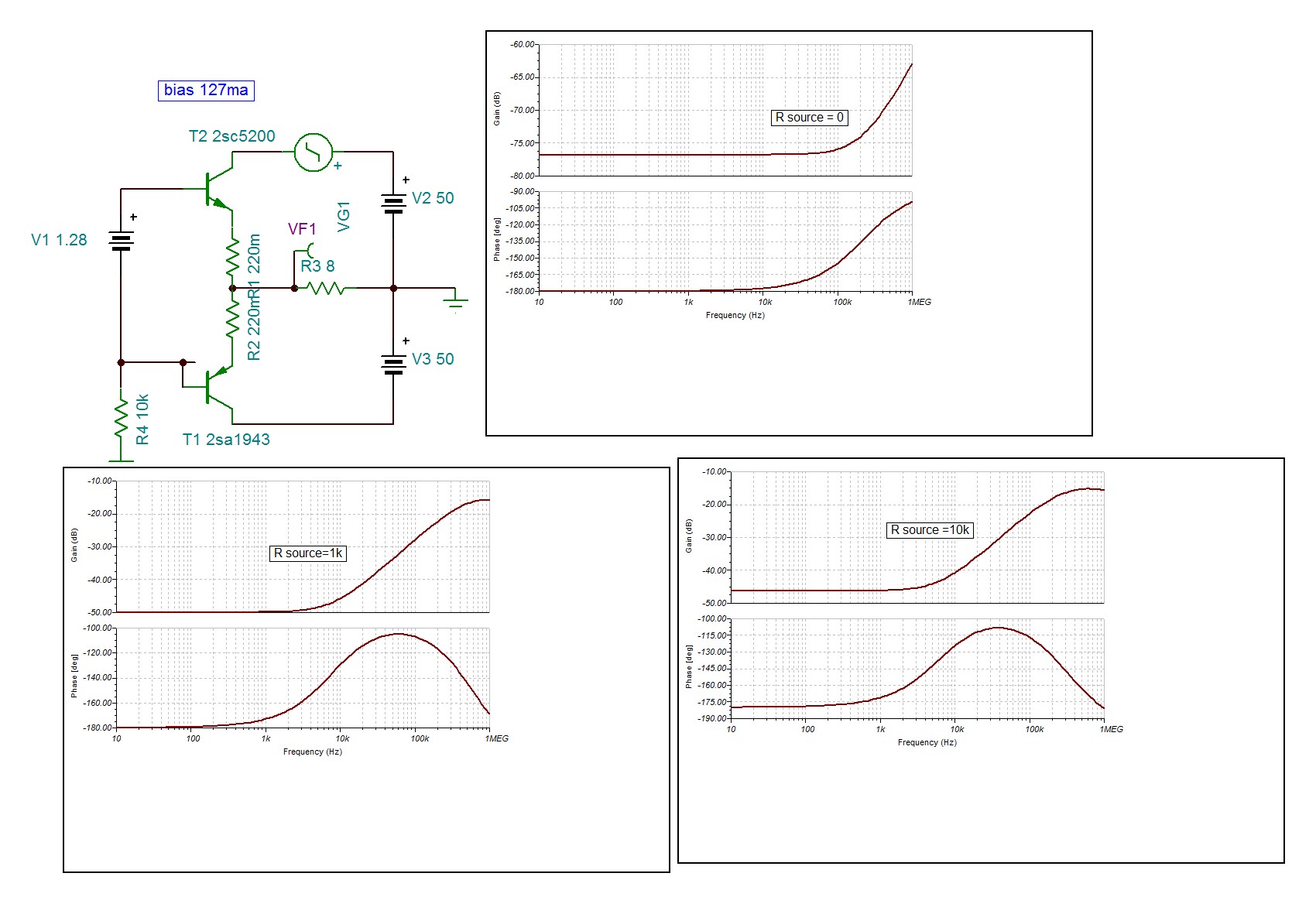

Two distinct mechanism play a role here, and they shouldn't be mixed up: one is the equivalent of the Early effect for FET devices, the channel modulation, which happens under all conditions, including DC, and apart from massive feedback or cascoding has no solution, the other is the Miller capacitance effect between D and G, which is frequency-dependent and can easily be cured with a low drive impedance (the cascode also works in this case)
Yes , you are right . It is the early voltage remains the main problem with low driven impedance . As you you see it is worse with the P type. People designing no overall feedback must be aware of this .
