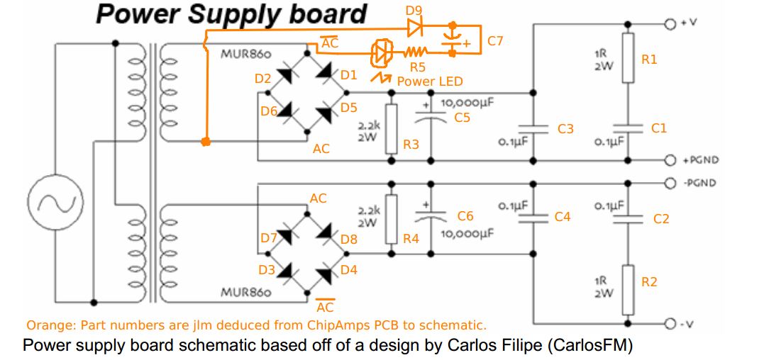

I've received so much help from you all on my Chipamp project, that I thought I'd make an (albeit small) contribution back. Here is a pic. of the Chipamp.com PSU with part numbers on top, as well as the LED power light indicator circuit and parts.
Hope this helps someone.

I'm a total newbie with nearly zero electronics knowledge. If you would please clarify what you mean by that, I will try to fix the diagram.

Sorry, not clear. What do you mean by reverse? Do you mean swap label D3 with D8 and swap D7 with D4 or something completely different?

Look at the two halves of the PSU - the same connections that give positive output on top give a negative output on the bottom 😀
Leave C6 and the other components as they are, but connect the D3/D7-node to the negative side of C6 and the D4/D8-node to the positive side.

I can't really imagine in my mind exactly how that would look. Maybe someone else can change the diagram and re-post?

Current only flows in one direction through a diode. Some of the diodes are drawn the wrong way and need to be reversed. This schematic keeps popping up with the same response.

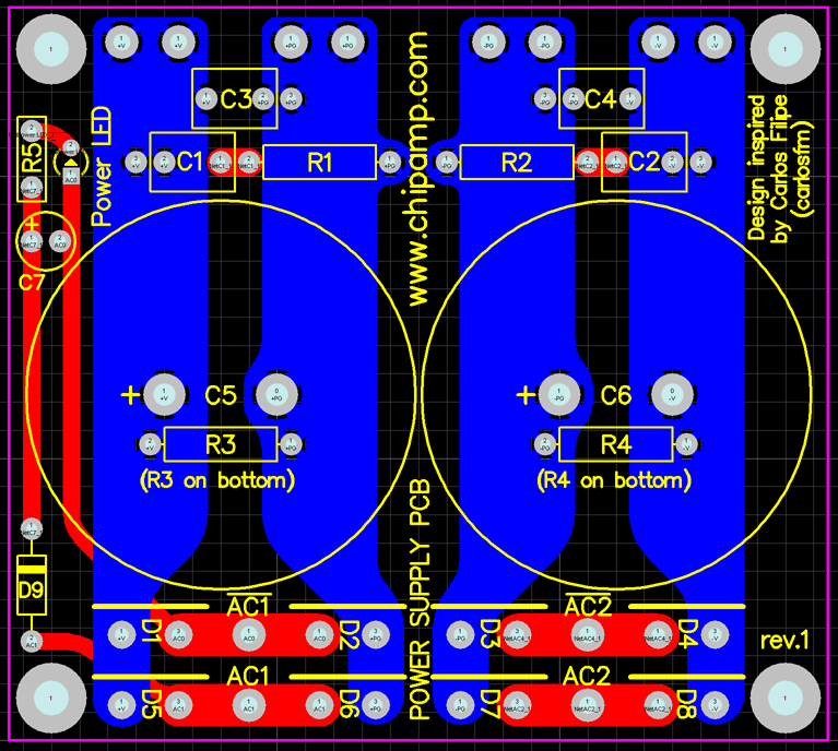

Yes, I know. I'm just trying to make it easier for newbies. It's never a great thing when a schematic doesn't match a PCB.

I think both the schematic and the PCB are correct. If you measure the DC at the outputs you’ll find the +/- orientation is exactly the same even though the outputs are marked (from left-to-right) as V+/PG+ then PG-/V- If you reverse the polarity of your probes you’ll measure the direct opposite polarity from the V/PG outputs on their respective sides. https://www.electronics-tutorials.ws/diode/diode_6.html
Will likely work better if the snubber components are connected closer (directly) to the rectifier diodes (source of hf shot noise) and not at the opposite end of the board, inches away from them and the added inductance of the filter capacitors as well.
Pretty nice to have a board with everything on it though, much cleaner looking than some of my setups!
