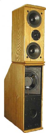

More as a design example for the general form, I designed and build these for my boss when he wanted to learn a little about loudspeakers. Too long ago to recommend the components, but the form still works.
As an aside: the peculiar woofer driver position is the result of a fix for MCM T/S parameter and woofer size miss-information, it's a dual 8" woofer isobaric arrangement that doesn't really fit into the box
; just take it as a warning, always measure your T/S parameters, and the driver dimensions before you build a box.
These don't reach down to 20Hz, but keeping the tops and bottoms separate provides you with all kinds of options. You can always add a tapped horn or two for the lowest octave.
