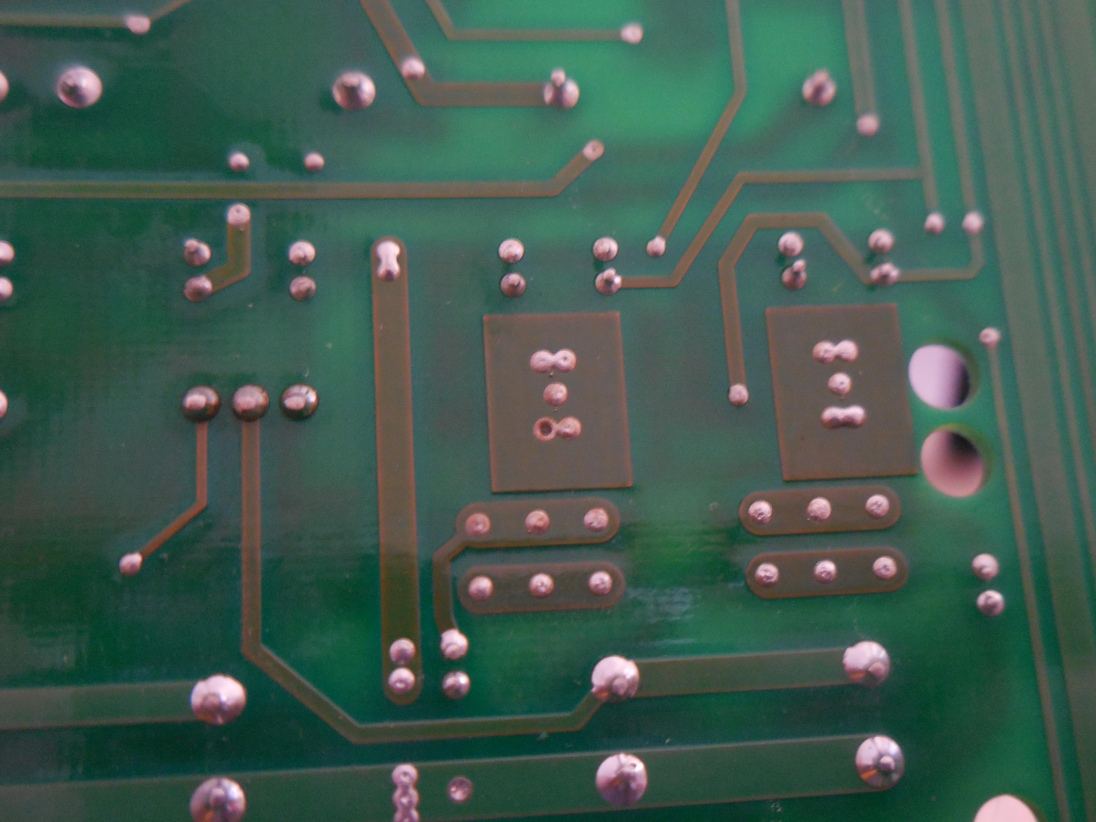

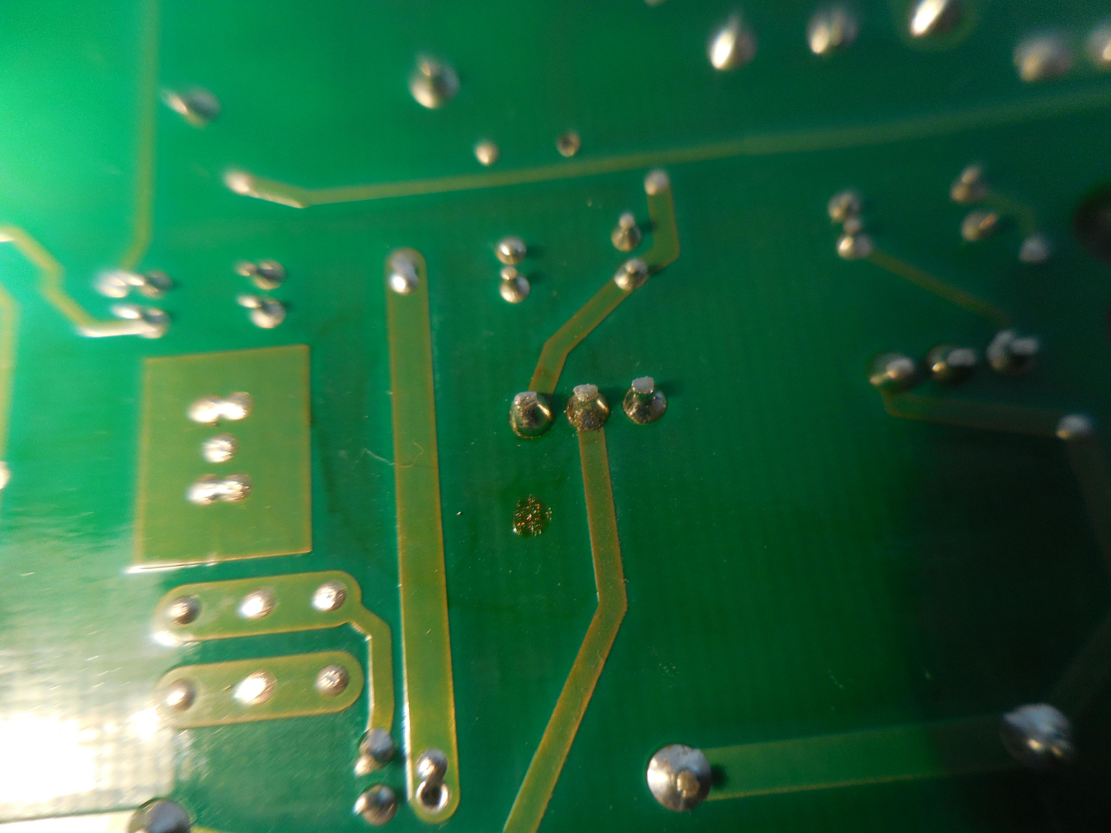

pics of solder some missing
I took the board out and here are some pics of what I found
some of the capacitors had no solder at all, the spark was evident and was a poor solder area, my fuse socket fix thru the case was bad looking but probably still conducting my internet is very slow I will add more pics at the next break

I started the amp and it was of course in protection mode on the left channel. I tapped the relay and the amp started and played for several hours even at very loud volume. so I am hoping the amp stays out of protection mode. I guess time will tell
thank you all for all of the help If it goes back into protection mode or distorted mode I will change the relays. taking the amp apart and fixing the solder bolstered my confidence in working on it. it is suprising that the three or four connections were completely missed when the amp was built.
