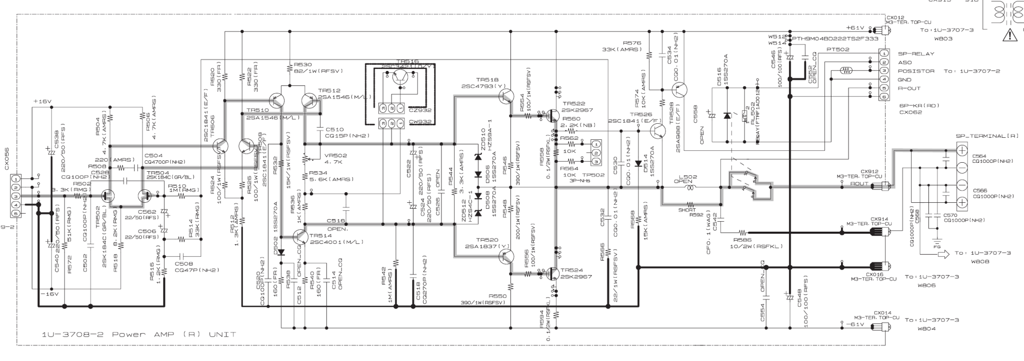

I am attaching the service manual.
I suggest driving both channels with the same sine wave signal and comparing the two channels. Of course, increase drive cautiously. Be sure to use a x10 scope probe.
With luck, the scope will reveal the culprit. Let us know what you observe.

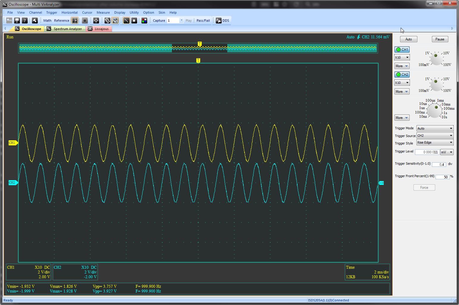

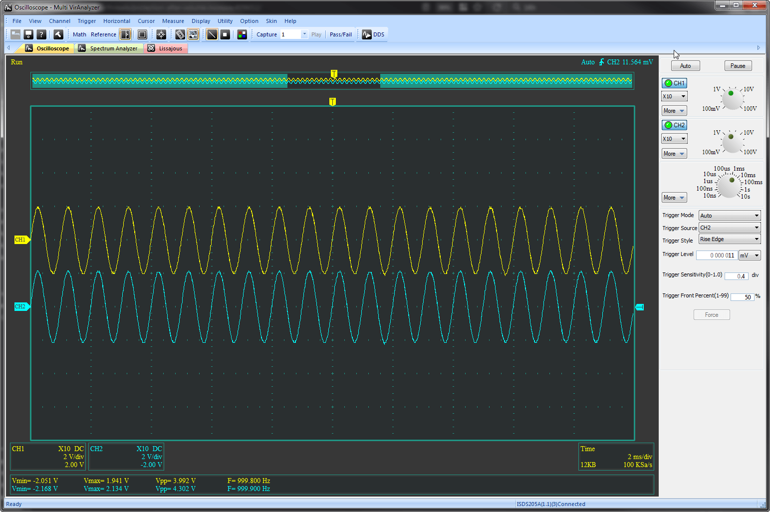

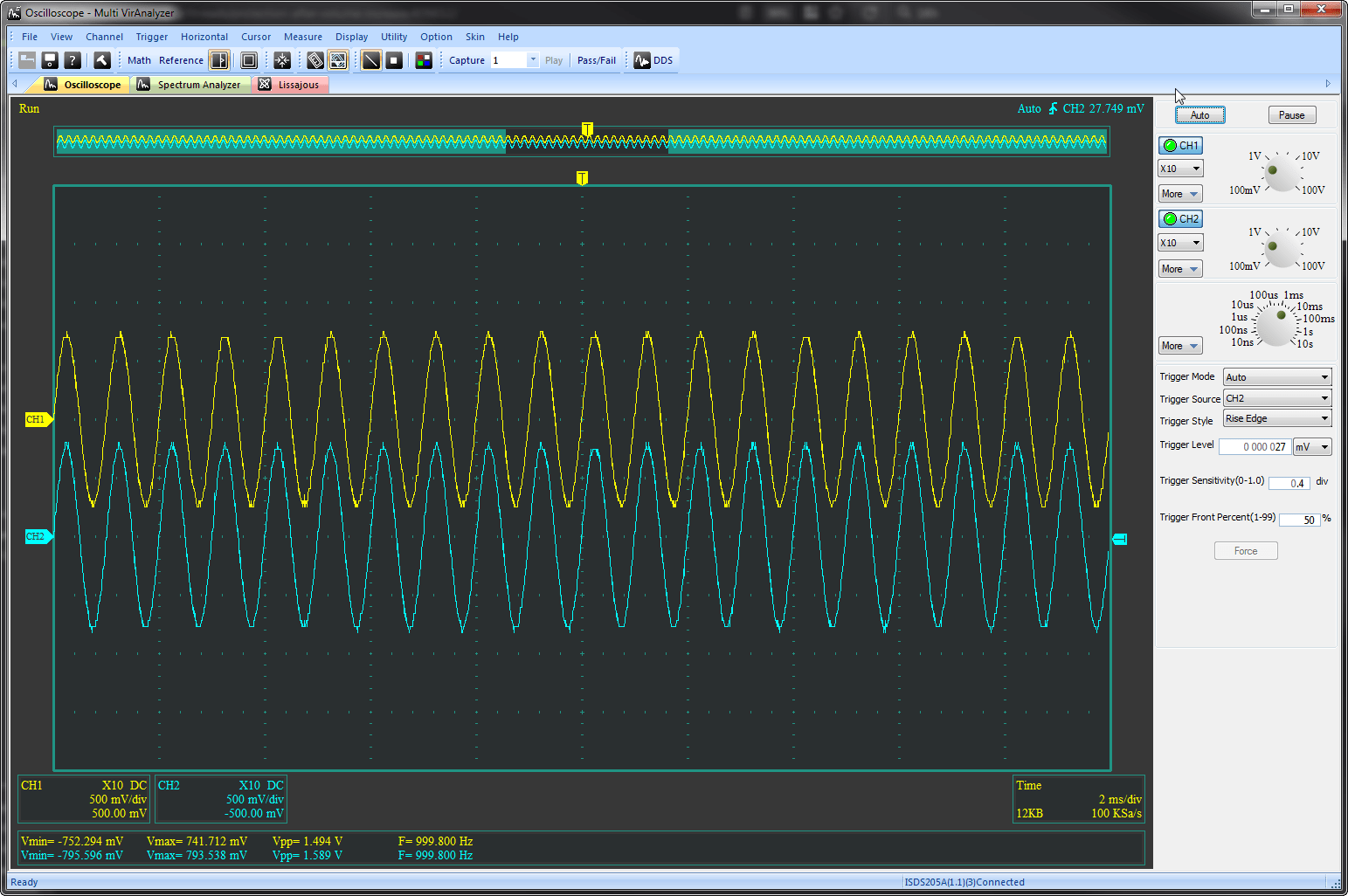

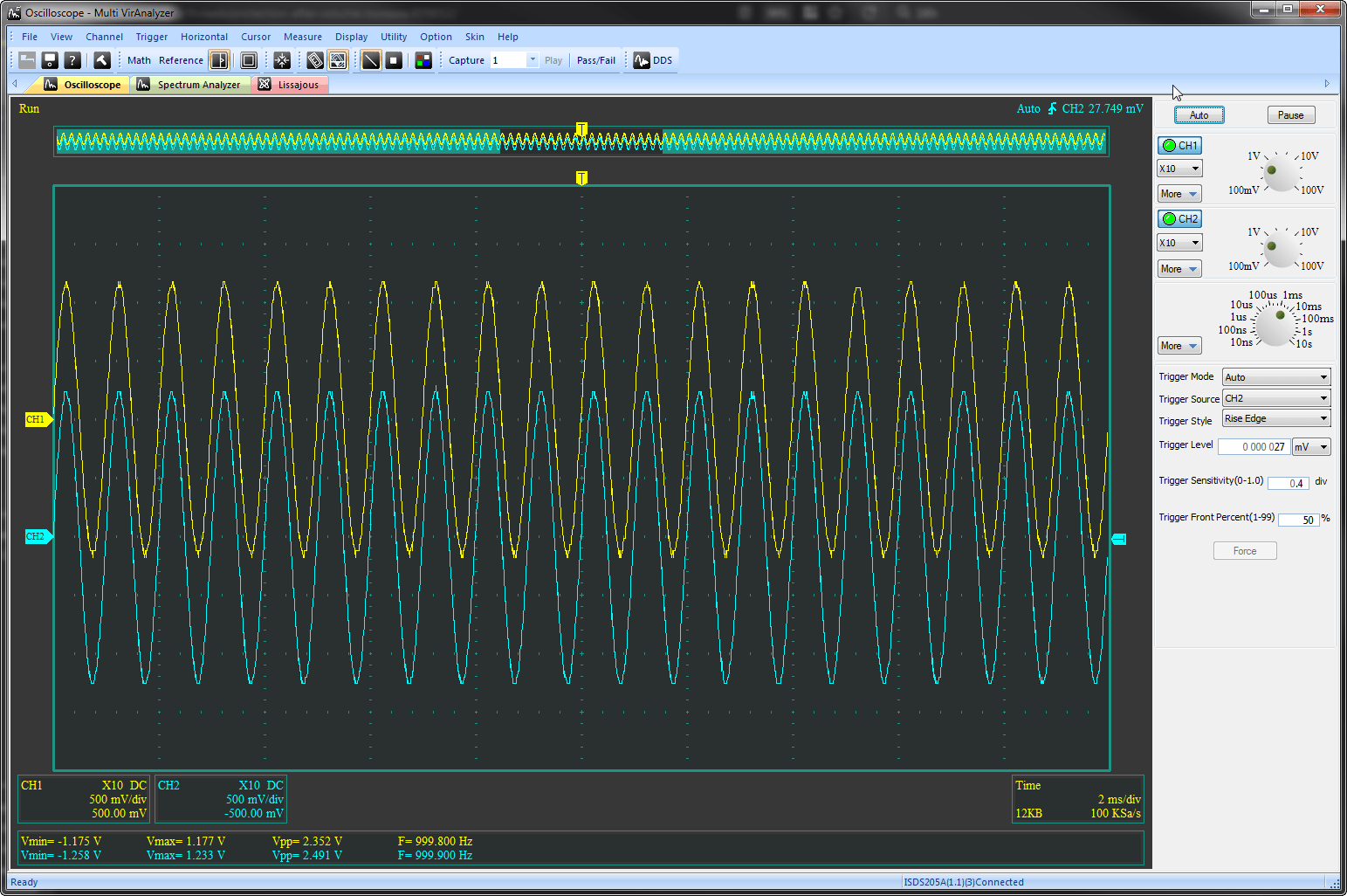

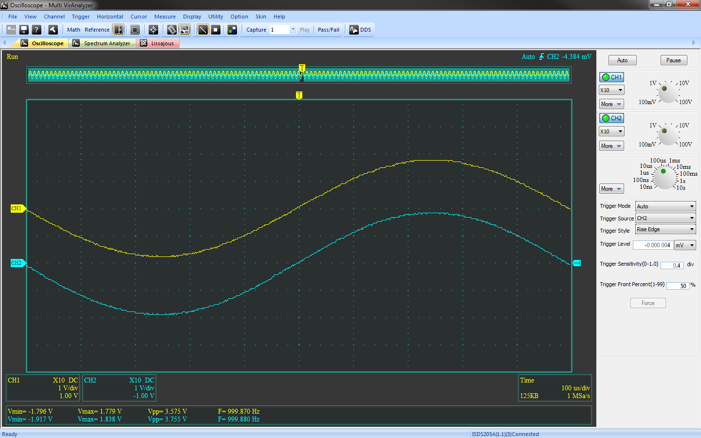

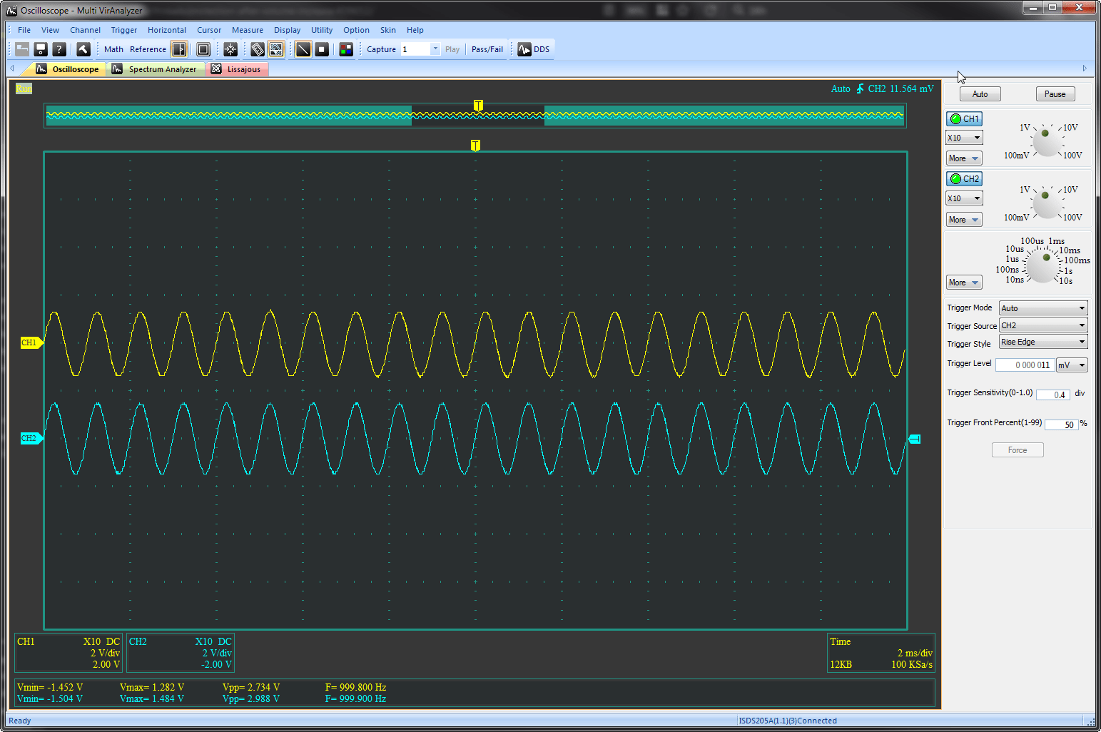

I didn't mention it, but I did the measurements above with 1Khz on both channels.
The two channels behave approximately the same and at 3.5-4Vpp it goes into protection.
Problem chanel is ch 1

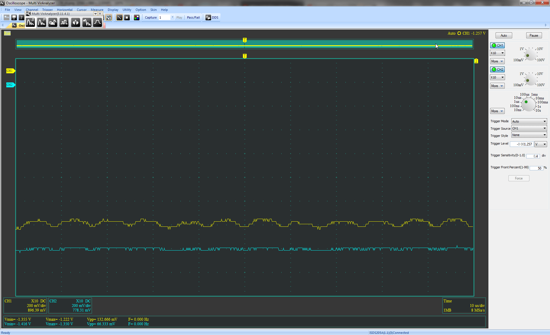

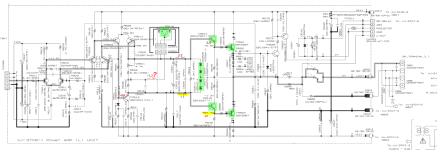

I also changed the drivers TR518, 520, no change. I extended the cables and now there is good access for measuring.
Try adjusting amplitude to about 3V pp and raise sweep speed to better study crossover behavior. Be sure to use DC coupling on scope to observe any shift in trace center as you vary amplitude—- there should be no shift in DC position vs. ampltude. Examine waveforms at bases of output and driver stages using working channel for reference. Remember x10 probes to minimize any tendency to oscillatio, especially re interstages.
If problem is protection triggering then let's study protection triggering.
In his amplifier TR526 detects high voltage across R558 meaning it detects high current.
So start by scoping its Vbe.
You should see a positive half wave, measure its peak value.
Anything above some 650 mV will trigger it.
Use a fully floating scope input, because both terminals, Hot and scope "ground" follow speaker out signal.
Or use differential mode if your scope allows.
For such uses I bought a cheap ($25) 9V battery or class 2 wall wart powered mini scope at Al1B4b4 , invaluable for such tests.
Of course your current scope might be able to make such test.
After we make this vital first test, we can proceed further.
To save sometime also measure R558.
It should register practically a short, it might have blown open.
Or its solder pads or tracks could have been vaporized or cracked open, making the protection system trigger happy ... literally.

When measuring the Vbe of the TR526 the protection is immediately switched on.
R558 is OK

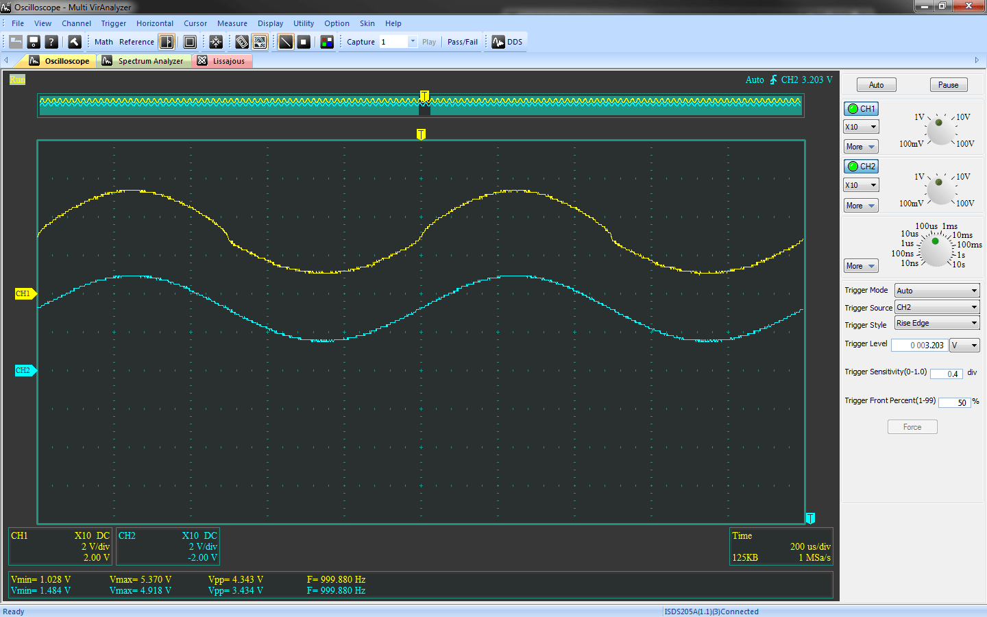

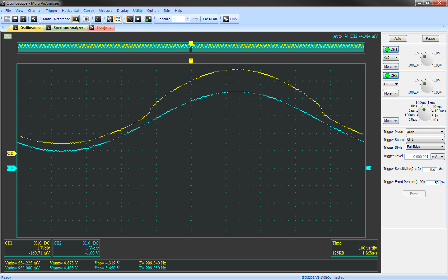

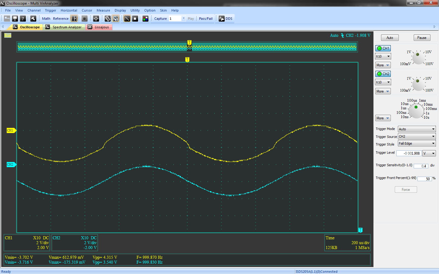

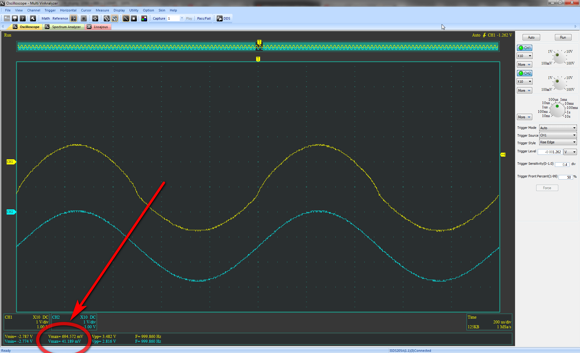

Short pins 3 and 4 on CX056 when testing; leave the output open. You have to remove & check each BJT carefully - the multimeter will do here. The MOSFETs will need a tester, to check... they are tricky things. If the gate capacitive barrier is slightly damaged, it will cause oscillations, but the MOSFET will measure okay with a multimeter. Use a grounded wristband.
Ch1 has oscillations visible on the oscilloscope trace. It looks like a non-linear device issue to me (a diode problem). Either that, or you still have either BJT or MOSFET issue.
I'd replace all diodes, including Zeners.

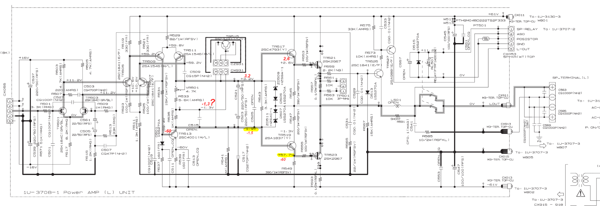

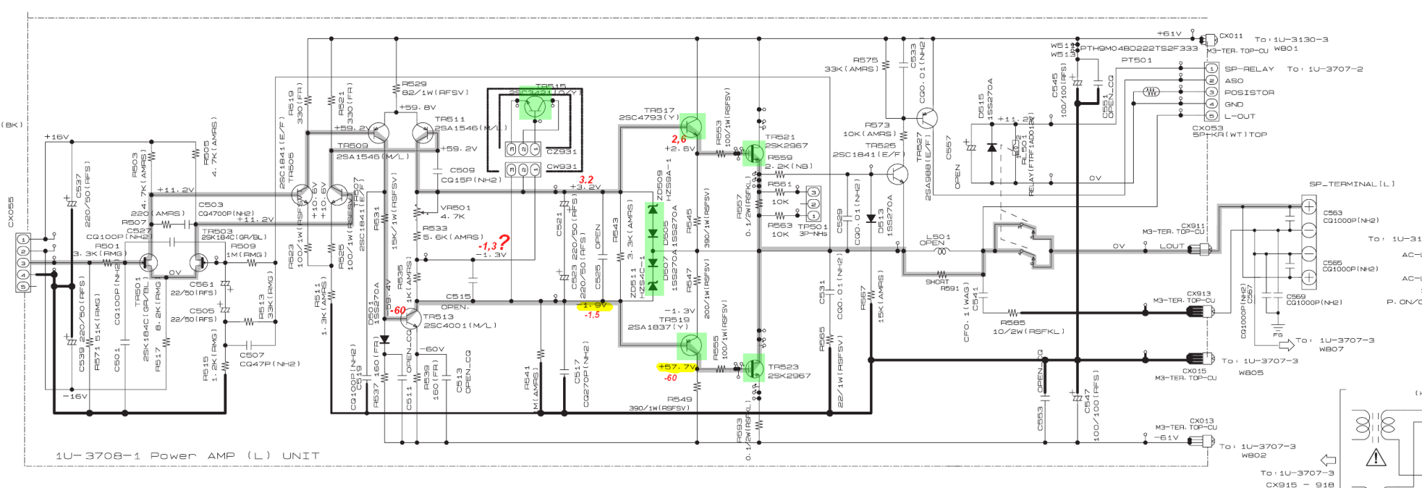

Hi guys,
I have time left for this repair. It seems the problem is around the base of the TP516(515). I use the schematic of the good channel because it has the voltages marked on it.
Did you adjust bias after replacing parts? (Page 3 of SM, no load)
Where did you purchase the parts?
Yes, I did bias adjustment. The parts are certainly original, but the fact that there is no change in the behavior of the problem tells me that the ones I removed were ok too.

I took a closer look at the math and detail it below.
For simplicity I’m assuming pure class B with sine wave signals, so the current in TR523 will be the positive half cycle and 0 current during the negative half cycle. In a half cycle sine wave with peak Vpk, the average voltage is 2Vpk/Pi, so the average voltage over a full cycle is:
Va = Vpk/Pi or alternately Vpk = Va*Pi. *
In post 8, you observed a bias voltage in bad channel of 292mV. This would correspond to a Vpk of 0.917V across R557. The corresponding current is 9.17A peak. Assuming this peak current produces a clean sine wave, the output power would be about 336W into 8 ohms.
I doubt this output power is really delivered, but if the sensed drain current is roughly correct, that current must be going somewhere. I’m guessing into TR523, so it and TR519 would be my favorite suspects. I would imagine that the two FETs should be getting equally hot, and hotter than the good channel.
Good luck!
