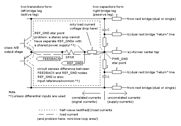

Now I found that drawing again I made a while ago to show the mentioned current flow. As Nico points out, when the diodes are off, it's only the caps that are at work, closing the loop. And when the diodes conduct, the currents are rather uncorrelated to the signal.
With a little imagination and using some black box circuit equivalents for cap arrangements etc, one can also redraw a cap output amp and will end up with exactly the same schematic, with the only difference -- wrt to the output stage -- that the center tap is always floating (while with a split supply it's only floating most of the time).
When we speak of virtual ground in the context of power amp (speakers or headphones) then we have an active return point, some sort of output stage. This changes the situation a bit in the details, but not in the basic idea that the load currents always go through the supply caps in some way or another (exept for constant current class-A bridge circuits).
- Klaus

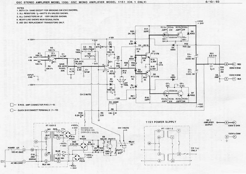

Dear all,
QSC uses this type of amplifier with a virtual ground. It is also copied by chinees amplifier manufacturers.
(see the attachment.)
This amp is uncapable of delivering DC on the output, that's a big plus. Unless you have a short in one of the capacitors. then everything will blow!
When i compare it with brands like Crown, Peavey, Crest, it is a bit weak in the bass.
I am uncertan about the ground connection with this type of amp. Is is wise to install the power transistors to the heatsink without isolating the collector? and can you connect 2 channels ground to the same chassis? I think it will result in strange currents between the amps.
also, i analized the AC current running and it seems to me that the voltage swing is the same as the total voltage multiplied by 2.
Because the return current must run over the negative (or positive, depends where you start) voltage connection to the rectifier.
Or will the voltage over the capacitors always be the half of the total? When i look at the specs, this might be the case.
Interesting stuff, any replies /remarks/suggestions welcome!
Koert
that QSC is an example of a floating supply "common emitter" output - viewing the output stage as a single compound sziklai/cfp "transistor"
separate transformer sec are required for each channel
the channel grounds may be connected together - with the same or less concerns that exist for any amp with common power output ground connection
the QSC schematic actually supports a proper use of "star" ground referenced to the output gnd connection by having diff amp input stage
if the floating sec were center tapped then the ct could connected to the output/cap midpoint and you'd be able to put out DC all day long - this would also assure more equal V across the output/ps caps with C value tolerance variations
