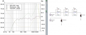

I've just finished a pair of small desktop speakers with the driver Monacor SPH-30X.
This little 3" full range has gotten some pretty good reviews and I must say it sounds promising and with surprisingly good bass.
Although it sounds promising the frequency response reveals that the sound can probably be improved even more. See the attached graph(s).
Before measuring the response I would have guessed that a strong notch around 10khz and then some baffle step attenuation would have done the trick, but since it has a dip around 3 khz that I dont want any deeper i'm now leaning towards multiple notch filters.
The solution I have so far includes 3 notch filters, but since two of them deals with the dip at 10 khz, maybe it can be done more effectively. I'm hoping that some of you guys will take a look and tell me what you think 🙂

My first reaction would be DSP. I am thinking you could shelve the response (down) from about 400 Hz to 2.5 kHz, then from 2.5 kHz to 3 kHz (up). Then you are left with that 10 kHz peak to sort out with a notch. Maybe you can do the same thing with analog networks, I wouldn't know. DSP was a step to avoid learning analog stuff. I haven't regretted it. 🙂

Well i have thought about digital signal processing, but i dont have much experience in that field. How is that easily implemented? The idea of these speakers, being desktop speakers, was also the possibility of playing music via an ipod and a cheap class d amp.
I already have some of the filter components, so i think i will try to do it passively, but i can imagine that it would be easier to do digitally..

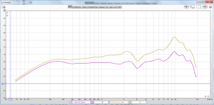

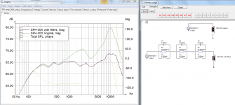

If anyone is interested I have now built the (triple!) notch filter. I used components that i had just laying around, but the impact was minor.. Anyways, I think it looks very promising, but I still haven't done any listening tests 🙂
Below are pictures of the simulated effect and the actual measured effect of the notch filter (looks surprisingly alike imo)
