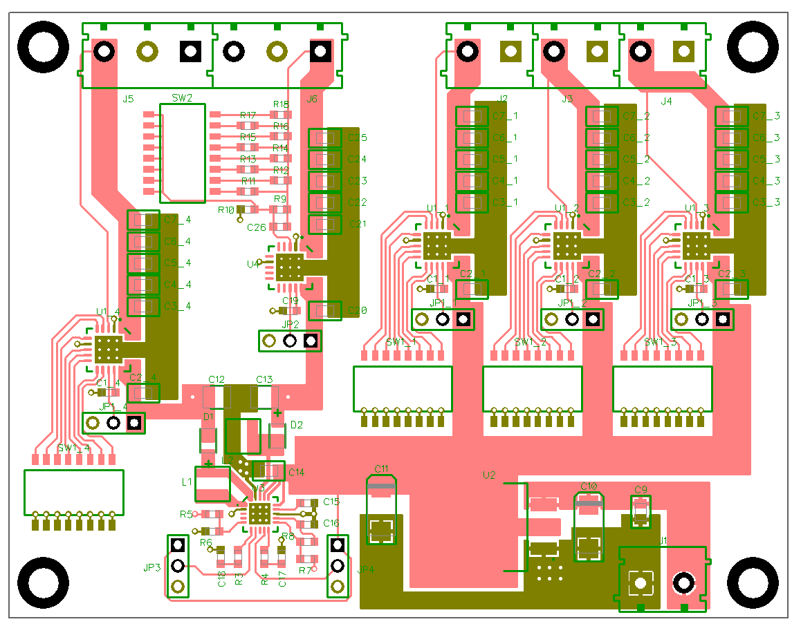

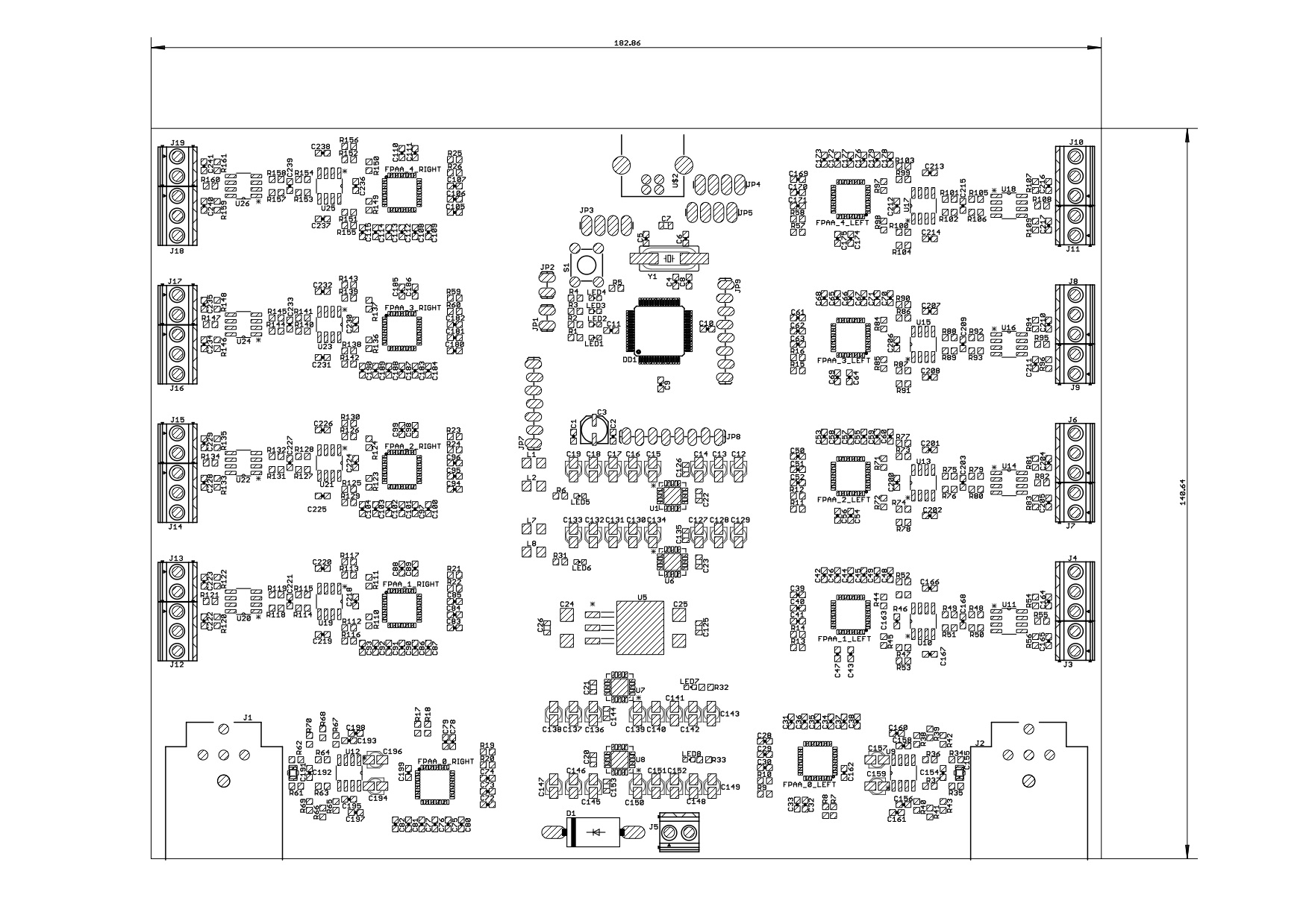

I've started to develop a programmable active analogue crossover. The board has an onboard PIC chip for easy programming via a Windows app / USB. The initial goal is to see if I can recreate the Linkwitz ASP in a programmable analogue form for the LX521 speakers. The signal path is completely differential analogue from in to out. No DSP in sight.
I am designing the board to use with 8 of the MOD86 amps by Tom/Neurochrome.
http://www.diyaudio.com/forums/vend...mposite-amplifier-achieving-0-0004-thd-n.html
So, I have made a start. I have started the schematic, chosen a few comps, and made a simple PCB layout.
Input - XLR differential (OPA1632) to 0-3v.
Output - 0-3v differential to differental / single ended (OPA1632&OPA1611)
Analogue and digital supplies - TPS7A47/33
Crossover ICs = special sauce.
I am looking at resitors and cap choices. I hear Susumu RG 0805s are the gotos for SMD. I will keep you updated over the course of the next few weeks.

While using a PIC will make it possible to simultaneously implement many changes to the crossover at the same time, what I didn't see mentioned is HOW you plan to make the changes to the analog active circuits. This is really not a trivial matter in my eyes if you want the performance of the crossover to be predictable and accurate compared to what you "dial up" on the PIC.
Typically you are talking about circuits with active elements (e.g. op amps) and networks of resistors and capacitors. These latter two passive components are pretty much all you can change, and of these digital potentiometers can make for good control elements. The only problem with these is the lack of good precision. Sure you can precisely set the end-to-end resistance to step 512 of 1024 but the end-to-end resistance of each device might be +/-20%. Will you calibrate all of them?
What will your approach be for changing the performance of the filters in the crossover and what topology(ies) will you be using? You mentioned some special sauce or whatever. Please give more details on your ideas.

Thanks Charlie. I'll try and answer your questions in the coming days. I've not seen the IC used before on DIY audio. I don't know whether that is a good or bad thing...

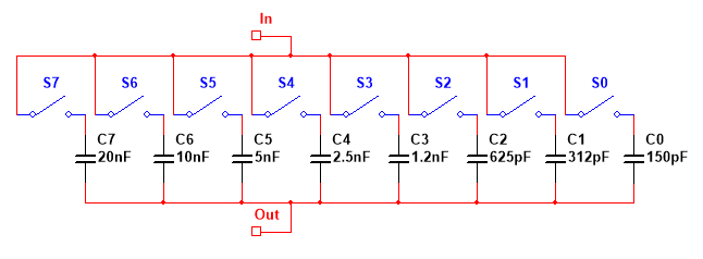

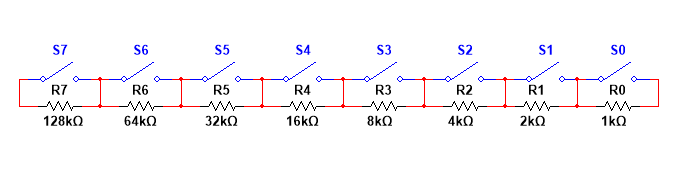

I'll second the emphasis on switching / control devices. Yes, DPOTs and programmable attenuators can be used to control a filter, but relays are often easier to use with standard filter circuits. To change the frequencies, sometimes it's difficult to use only a programmable attenuator - an actual switch whose switching channel can float without creating distortion is needed, for example to change the value of a cap that has a nonzero signal on both terminals. That nixes DPOTs and solid state switches, as they behave well only within a narrow signal voltage range, or with almost zero voltage at the switching terminals.
As for your component choices, the Susumu 0805 resistors are quite nice, quite stable, and very inexpensive. Great choice.
Capacitors are a tougher choice. Since you're using SMD, I'd like to recommend the modern NP0/C0G multi layer ceramic caps. They're made from an extremely linear dielectric (calcium zirconate), they have no microphonic effects and no nonlinearities. The problem is that they're only available up to 0.1µF or possibly 0.22µF. For larger values, you have to parallel multiple devices. But, they are actually better than film caps, since their terminations are far more reliable - there are no 'bad units' that can cause measurable distortion, which is what one sees in anywhere from a few bad units to maybe 20% of a batch of otherwise quality film caps.
If you'll use through-hole films, then it's hard to recommend anything specific, as the unit to unit defects mentioned above are essentially their largest problem. The traditional thinking is that by choosing a nice dielectric, a good cap is assured, but that doesn't always happen in practice. To avoid these termination defects, some sort of screening procedure should be done on each unit, either to look at ESR (which points to termination quality) or dissipation factor, which could also point to similar problems.
A test using a high res distortion analyzer will also work, but the only commercial analyzer I know of with a distortion floor low enough to measure this problem in a cap is the APx-555. It's a fantastic analyzer, but it's very pricey. There are some DIY generator - analyzer combos out there that can approach or beat the 555 residual, but you'll have to do a lot of work to cobble a fixed frequency oscillator and notch filter together. But, amazingly enough, with an HD residual below -150dBC, you can detect capacitor defects that cause distortion on a unit by unit basis.
Good luck with your project, and try to tackle the biggest problem - the switching issue - before you sweat the details of specific components. It's not a simple problem to solve!

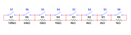

You can get a lot of values, and a lot of precision with these type arrangements:
