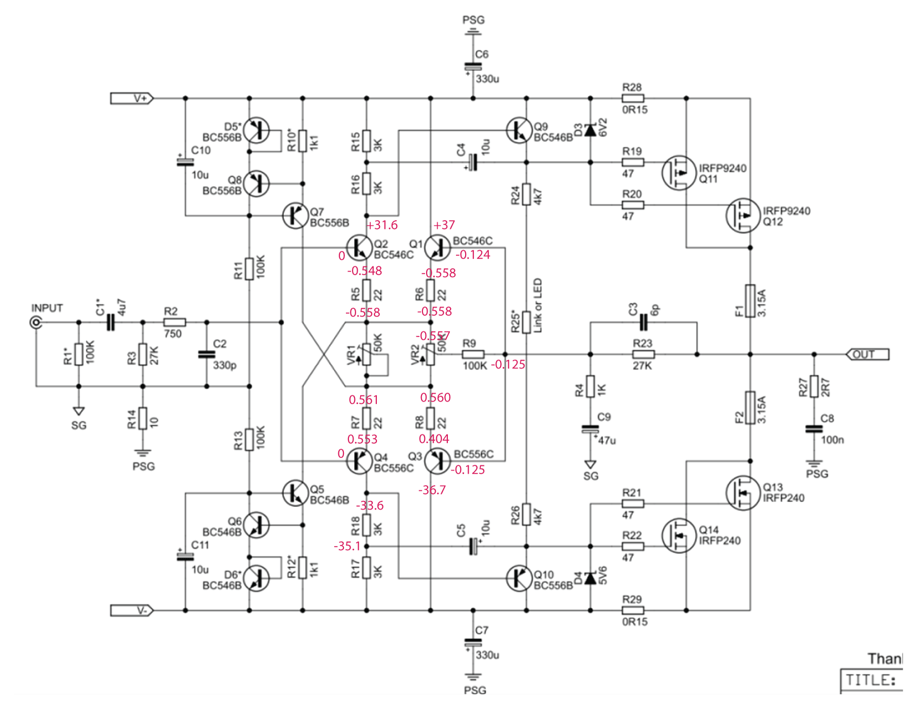

Just to make sure: you're talking about C3 in this diagram?

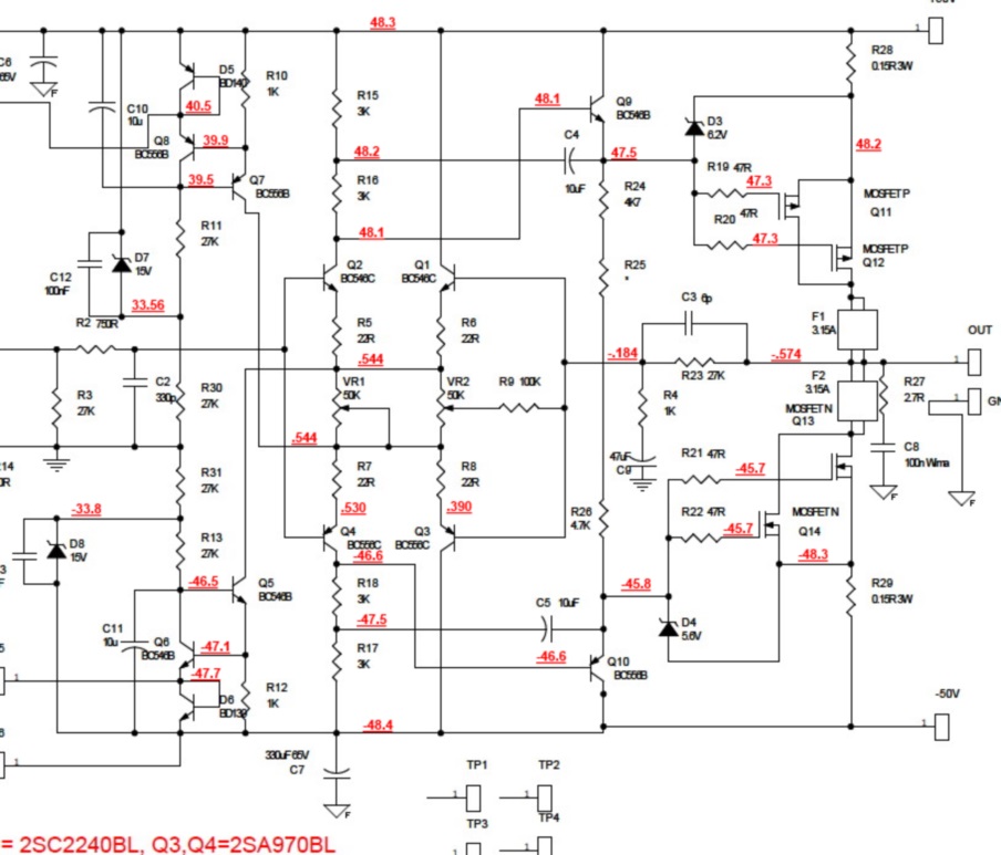

The new one does not oscillate, one can adjust the bias current very steadily, but this time I cannot get the DC offset below 460mV. It does respond to adjusting VR2, I only 'run out of headroom', i.e. reach the limit of the trimmer before it is zero. I'm running the circuit with +-37V instead of the specified +-50V, but I think this should be within the operating range.
A schematic with the voltages (all relative to power ground) in the first stage is attached, since I would guess the source of the problem lies here (?). Some of the base-emitter voltage drops seem a bit on the low side (Rod Elliott mentioned that they should be around 600-700mV), but I'm unsure whether this is a cause or a symptom. Is it obvious to anyone what the source of the DC offset may be from this or are potentials at other nodes required?
Instead of the BC556C and BC546C I used on the first board, I switched to the 2SC2240BL and 2SA970BL now (keeping the different lead convention in mind).
