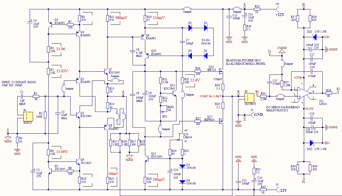

After building the circuit below, I'm experiencing some low-level hum when the volume is low.
Even with no source connected, I'm still getting hum with the volume set low.
Also, when I connect it to my fiber optics TV receiver, I can hear a high-pitched "whistling" sound when my plasma TV is on. Turn the TV off or disconnect the interconnects and the whistling sound is gone.
It's almost certainly a ground loop. Are the input RCAs isolated from the chassis?
Only one end of the shield on the two conductor input cable should be connected.
Does shorting R3 increase or decrease this hum? Have you checked the circuit's
behavior for HF stability with a scope?

Ok, I thought you had two separate cables, and were using the two conductors in each as hot and cold.
Then you have the grounds of the input RCAs shorted together, and both connected to the single shield?
If so, change to two separate cables for the L and R channels, and keep the two input grounds separate.
Use each cable's two internal wires as hot and cold for each channel, ground only one end of each shield,
and don't connect the shields to anything else. The shields should not carry current, signal or otherwise.
Or you could use a twisted pair for each input, again keeping the input grounds separate, with no shielding.
This usually works out about as well as using shielded cable in this sort of application.

Hi ammel68, did you connect the GND (see schematic) to the chassis and/or PE? If you did then there is a signal path SGND to GND through the PE connection.

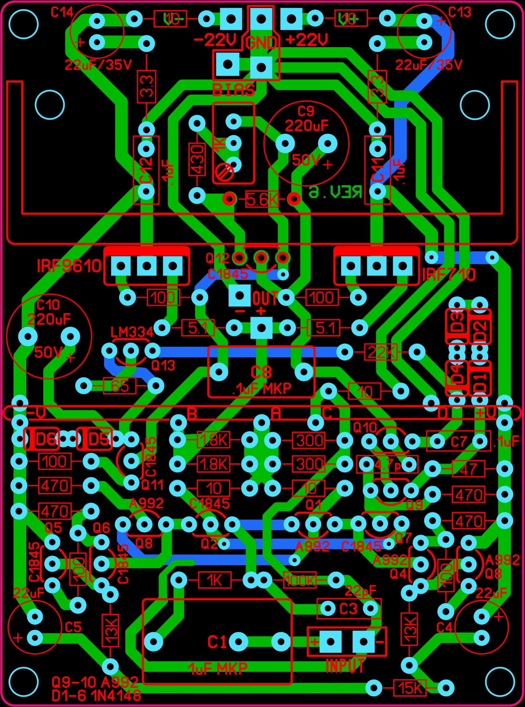

Can you post some photo's?
Can you test with only one channel powered and connected to a source? And, as Rayma suggested, don't connect the L and R SGND's together.

Do you have a scope and function generator? The HF noise "might" be gone now, try it and see.
Otherwise we can troubleshoot that.
Hi Mark,
I haven't connected any grounds to the enclosure, power or signal.

The residual signal level is likely due to the 10 Ohm resistors lifting the pot's ground terminals
above ground by 20xlog(10/10k) = -60dB down, nothing to worry about.
The noise is likely on the input interconnect cable shields, so try connecting a 0.01uF ceramic
(with very short leads) between each RCA input ground terminal (NOT the hot lead) and the chassis.
Connect one side of the caps to the chassis even though nothing else is connected to it?
I'm not questioning your advice, just trying to understand it.🙂
The two caps go between each RCA ground lug and the chassis close by, with short leads.
They short any HF picked up by the interconnect cables' shields to chassis ground.
The chassis acts as a shield for the circuitry in this case, even if the circuitry is not connected to it.
A nice summary from the horse's mouth: http://www.calex.com/pdf/4ground_shield.pdf

I feel like the high gain of this circuit is partly to blame for these issues.
A bandwidth of 1MHz also seems ridiculous to me for a audio amplifier.
An input filter won't help much, if the amplifier itself is unstable.
We can reduce the open loop bandwidth easily enough, if you want to try that.
Increase C6 from 4.7pF to about 270pF. That should make it a dominant pole.
You can tack solder the larger cap (with short leads) across C6 without removing it.
Something like this one should be ok. A npo/cog type is best, 50V-100V.
http://www.digikey.com/product-detail/en/avx-corporation/SR151A271JAR/478-5211-ND/1549697

Don't worry too much about such small DC offsets or drifting. It could be the input stage
needing better thermal tracking, but it's likely harmless. Or it also could be
the unregulated power supply's fluctuations causing such variation. That said, there's
always a possibility of HF instability in a circuit like this. Is it built on a pcb with a
ground plane? Can you post a link to the original project?

The PCB does not have a ground plane, just what I would call a "star" ground where all the traces come together.
Below is the PCB I'm using minus the DC servo board.
http://www.diyaudio.com/forums/analog-line-level/283966-sony-ta-e1-preamplifier-clone.html
Is there hum problem with the servo inactivated?
Mostly, hum problem is from cabling. Are you sure you don't underestimate cabling?
