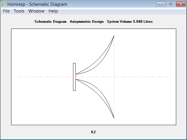

I've devised a generic example comparing two horns, one is better as a waveguide and one loads more (the more curved one).

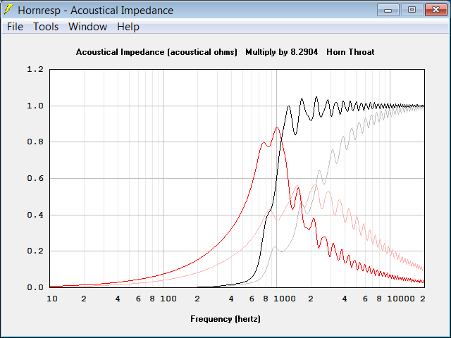

For completeness I've included their loading. Here one loads strongly to below 1kHz (the solid black and red traces) and the other fades above 1kHz.

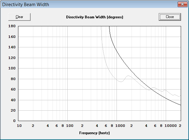

This next screenshot is the beamwidth. The closer to conical profile keeps control down low (the pale trace), where the loading horn has already given that up and gone wide. The loading horn goes too narrow at the top end.
