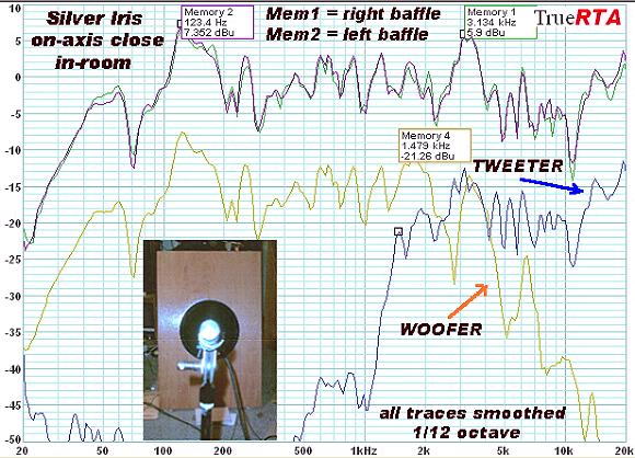

Yes - the Silver Iris does have a ragged high frequency response. I read someplace that this a function of the woofer cone shape providing poor loading for the compression driver. Despite this it has a very smooth easy-going sound to it - that why I disclosed that I was biased towards coaxial drivers.
I have yet to find a coaxial driver without a ragged response, and I've been looking at them for years. And yes, it's mainly due to the horn loading of the compression driver by the woofer's cone. The only graph you'll find without such a response are those from Radian, which is either only because they're ridiculously smoothed, or because their crossovers have smoothed it out (as they were supposedly measured with their corresponding passive crossovers), but I highly doubt that. However, the Radian coaxes are supposedly very good sounding. I've seen every bit of scarce info on the net regarding these units, and I remember coming across more than one person saying that they closely resembled that of the older Tannoy dual concentrics. I actually purchased one of the 12" in-ceiling models (yeah, crappy stamped steel frame) to try on an open baffle, with the intention of mating them with Alpha 15A's on OB if all went well. However, I still haven't gotten around to it, due to finances and staying busy lately. And I need to figure out the crossover too.

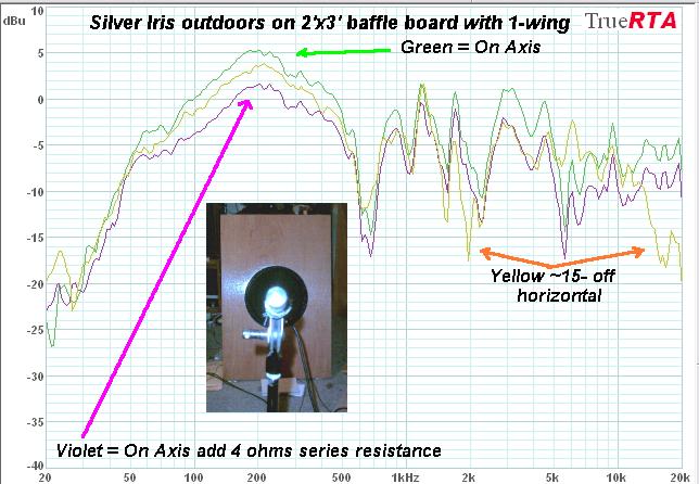

I have seen the graph specs on the Silver Irises, and I did not see anything ragged in it. Does anyone have the link to the chart?
John L said:I have seen the graph specs on the Silver Irises, and I did not see anything ragged in it. Does anyone have the link to the chart?
I have some response graphs of all the Hawthorne woofers (including the SSI), which might have been taken by Eminence, although I'm not exactly sure. As far as graphs of the high frequency unit, these two seem to be all I have..
