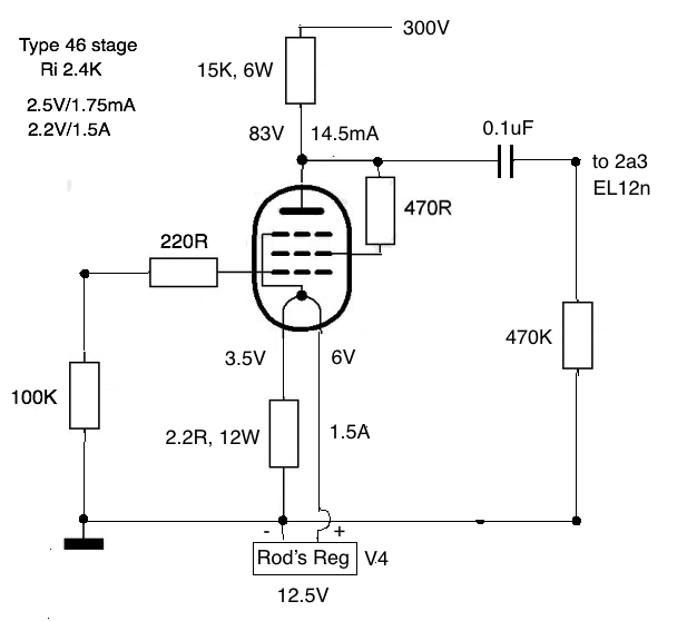

I have also used 46 and 47, but not 49. The 46 is better sounding to me, but has a mu of 5.6 whereas 47 is 8. Same filament supply. Ale has used filament bias on these tubes despite the big heatsink and cathode resistors required, but gave up on it. I'm persevering with filament bias - it's always my choice where possible.
Here's a driver stage for my 2a3 outputs, with a 1:4 SUT for added gain. I also use a 10Y driver stage for the 2a3 but they're getting very expensive so I need an alternative as a daily driver. Big heatsink required for Rod's regs, and something like 100W metal clad cathode resistors.

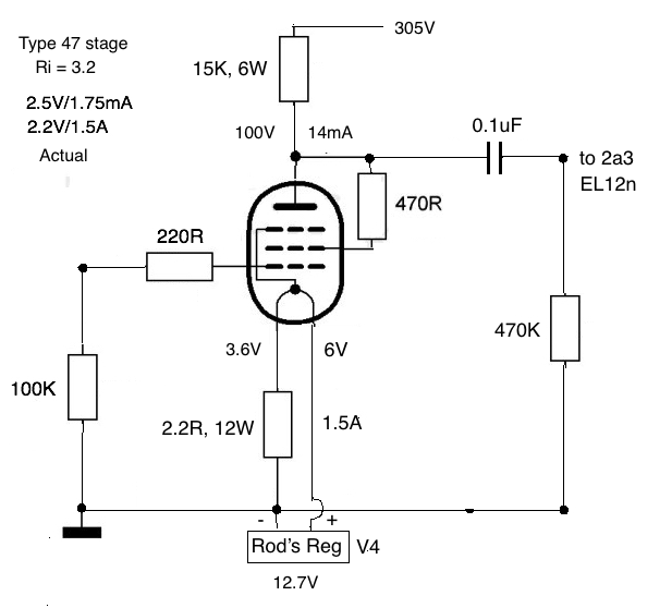

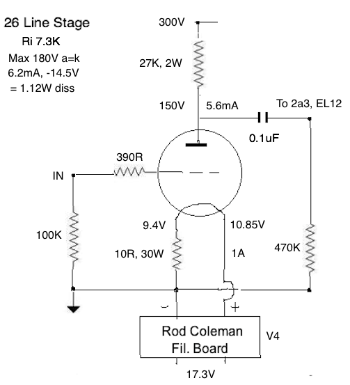

I'm building a simple version of the 46 in filament bias, without the 1:4 SUT. Not needed for my SE EL12n outputs which have a mu of 18 in triode. They're sounding very nice with a 6J5 input (CV1135) so should sound even better with a 46 in front. I'm using up some of Rod Coleman's older regs. For the V9 the supply voltage would be 9.5V.

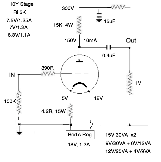

I've been using my EL12n in triode output stage for a while now - the 2a3 stages are on the shelf. I just did shootout between the three best driver stages I have - 26, 47 and 10Y. The 26 was very nice - more than I expected. In the ST version it wasn't warm sounding, it was very smooth and clean with excellent vocals and a nice bell-like sonority to the grand piano. The 47 was neutral with just a tinge of brightness, very clean again. The 10Y was neutral, dynamic and had more micro detail.
I'd say all three were very close - I could be happy with any of them. All three were a level up from 4P1L, 2P29L and 112A. All these were used in filament bias with Rod Coleman regs. I also found the cathode resistors, which are large with filament bias, made an audible contribution to the sound. I've been using Russian ceramic resistors but got better tonality with some stackable NOS wirewounds and some big porcelain ones. The aluminium clad resistors were not so good.

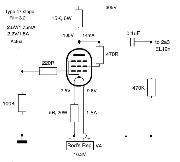

Sample schematics attached. I'm still using up my stock of V4 filament regs, but you would now use the V9 ones. When driving the EL12n the output would be 0.1uF teflon FT-2 and a 470K grid resistor.
I have a SE amp with EL12n outputs, mu of 18 in triode so just needs an input tube with a mu of 8 or so. I had hopes for the 46, but turns out that the best fit with the EL12n is the 47, and it's really nice. Not what I expected but I'm happy.

The first time I tried the 47 I thought it was inferior to the 46 as a driver tube, but for some reason it's swung the other way. Two fine valves. The 47 is really singing in my current circuit, and I use it every day to keep my 10Ys for special occasions.
