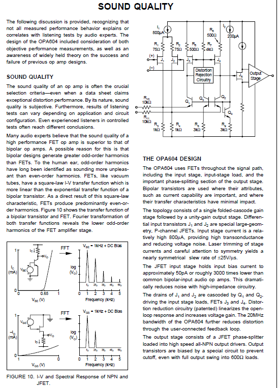

Can't believe no one mentions OPA2604 😕
http://www.ti.com/lit/ds/sbos006/sbos006.pdf
Made for audio
+-24V
drive 600ohm
from
http://www.ti.com/lit/ds/symlink/opa604.pdf
Wow thats almost perfectly the same! Thanks, I think I'll use that instead so I don't have to buy voltage regulators
