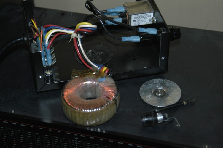

I have a B & K preamp with an outboard Power Supply ( Basically a transformer with 25V + 25V & 10V + 10V secondaries) that is overheating (extremely hot melting adjacent plastic fuseholder and its own clear plastic insulation BUT..... still supplying the correct voltages and not blowing the small 0.5A primaries side fuse.
It gets hot even with the preamp load disconnected!!!!!
Can someone tell me what is happening???
Has anyone experience this situation?????
Is the insulation on conductors shorting out or what???
I included a photo of the damage as well.
Any help would be appreciated.

Look for shorted diodes, bad capacitors and such, if they're part of the circuit. Most likely it has a shorted turn somewhere. Also, if that bolt through the center touches the disk, and the disk somehow touches the chassis, that would create its own shorted turn. If you put it on a bridge, you could see the shorted turn by the high dissipation factor. Anybody got any other simple methods?
I'd go with th e shorted turn theory - but strange that th eprimary fuse is not blowing.
Another suggestion: disconnect the transformer secondaries from the rectifiers (i.e., secondaries open circuit). If it still gets hot, its th e transformer. If not, its in the rectifiers or caps.

I just took anothe r look at th e phto - looks like there is no rectifier or caps in the PSU box. If this is indeed true and its getting hot with no output connection, the problem mus t lie around the transformer.
If you run the supply as shown in the photo with the transformer out of th e box and it still gets hot, you probably have an internal transformer problem - shorted winding etc. If it run s cool - your transformer mounting is a problem as described earlier in this thread.
So you think the insulation has failed and it is shorting out on the core or adjacent/overlapping conductors?
The voltages are still 25V and 10V as specified.
Does this shorting affect the output voltage????
I still can't understand why the fuse does not blow when connected OR NOT connected to load. It heats up enough to melt plastic!

Yes you are correct there is just the noise filter and fuse on the primaries and nothing other than the 5 pin connector (to mate to preamp on the secondaries. The bridge & the PS Caps are in the preamp and will not affect the load if the cable is not connected from this outboard PS Box.

Can you measure the primary current?
I'd expect for a well designed transformer with no load this would be tens of mA (maybe 50-100mA max).
Did you try disconnecting all the secondaries? There could be a short in the cable or connector. If a secondary with relatively low power is shorted that winding can overheat without blowing the primary fuse.
A shorted turn won't change the output voltage much. It is possible for the fuse not to blow, the fuse will allow 50W/100W (depends on line voltage) to be dissipated somewhere. If dissipated in a localized spot even less than a tenth of this will be more than enough to melt the insulation. If it has a shorted turn the heating would tend to be localized. Is the whole transformer getting hot after a little while or is it a localized area that is getting hot? A shorted turn will get hot pretty fast compared to overloading a transformer.

I finally got around to measuring the primaries and secondaries.
And guess what I am measuring resistance of about 20 ohms between the primary windings and the secondary windings which I believe is not right.
So I assume this is the problem of why the transformer gets extremely hot and eventually blows the fuse.

If you're getting a reading between the primary and secondary windings then the transformer is toast, the insulation between the windings has failed somewhere. This creates a hazardous situation other than the overheating because depending on where along the winding the short is, you may have a path to the mains 120VAC on you output, electric shock hazard by touching the amp and ground!
Normally these transformers should be isolated (ie, no conductance between the primary and secondaries.
