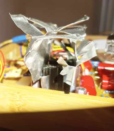

Guess what I did? I bent up some thick aluminum foil (from a disposable pan) and friction-fit it to a few of the fins on the heatsink. Now the heatsink is just very warm, but no longer very hot.
