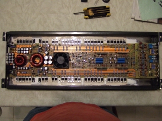

I need some help debugging this amp. It all started with the output level dropping and distorting. I put a sine wave through each channel and saw that half the signal was being clipped. Opened up the amp and poked around, checking transisters, rectifiers, etc. Finally found my problem, a leg of the inductor to the neg rail had broken. I re-soldered it, and checked my rails, and got both my neg rail back. I thought this was the end of it, but when I screwed everything back together, I now have no output on any of the channels. I must have messed something up when I was poking around.
I've traced my input signal all the way from the input boards to a big blue rectangular caps in the 4 similar sections which contain caps,resistors, transistors, and a vertical mounted board. My power supply seems good, with rails at +35,-35. I just don't get a signal on the base of my transistors.
I don't see anything blown, and all channels are equally effected.
Any ideas on the problem? Is there a 'mute' or protect signal that is stuck?
There are 4 voltage regulator circuits, 2 make my +15,-15 rails which go to the input board opamps, the other 2 make +38, -38, which go to the vertical boards and some transistors. What kind of voltage should the vertical boards be getting?
Any ideas/help will really be appreciated, I'm kind of stuck right now.

Did you remove any boards like towards the end plate ?? If so when you put the board back did you realign the connector properly ??
try to post a pic if possible its been a while since I looked inside my PC4100....🙂

Here is a pic of the amp. The connector is aligned correctly.
I haven't powered the amp up yet. But there are two J108A transistors in each of the 4 sections. All 8 have the drain, source, and gate connected to each other.
Pin 3 of the board goes to a A06 which then sends a signal to an A56, not sure where the signal goes from there.
