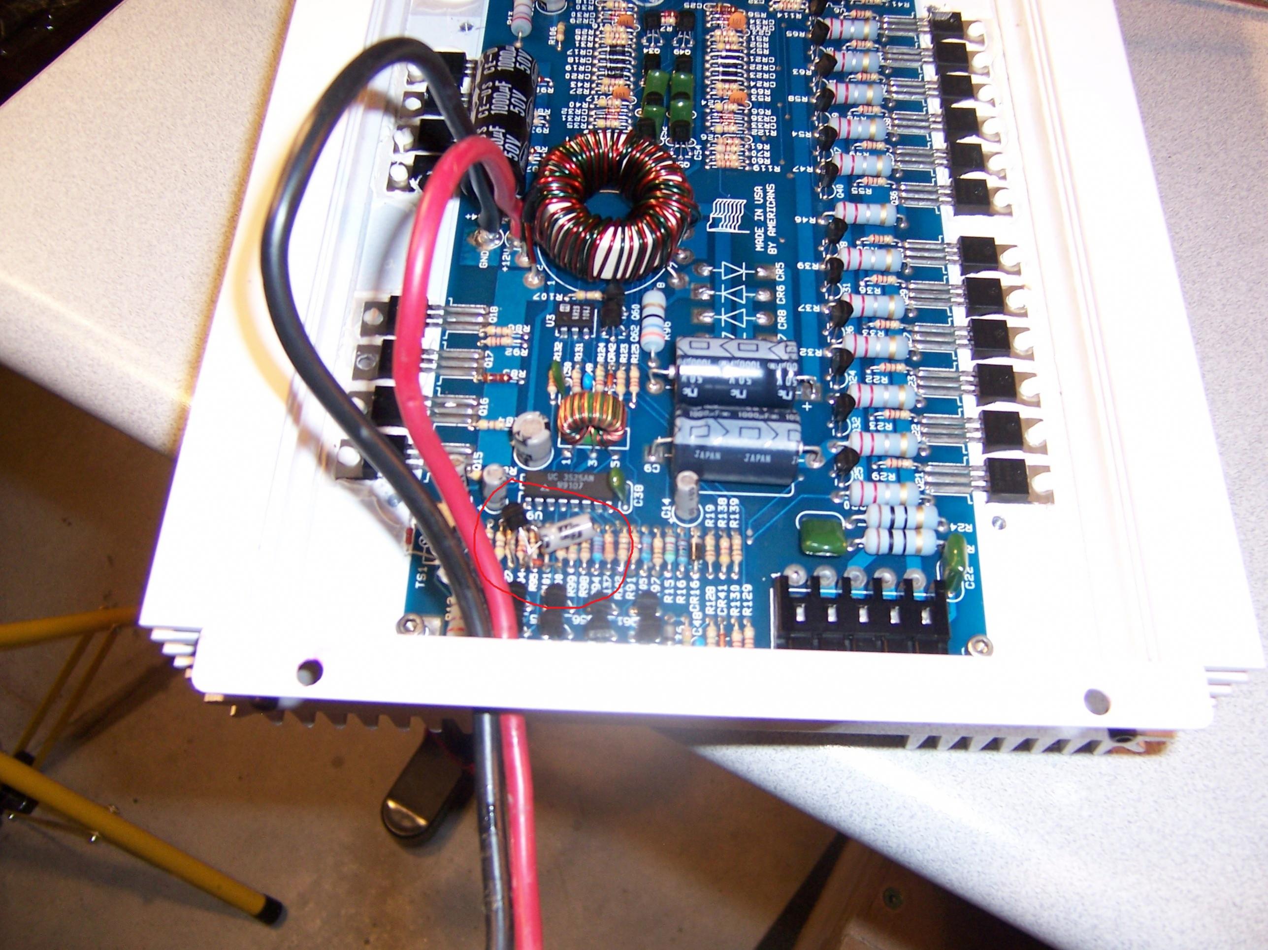

The mod is where the PC board designer accidentally left out circuitry designed into the amp and when the PC boards were made < rather then toss them to scrap > they added the missing circuitry and used the reject PC boards that a designer screwed up... CAD CAM was still on the drawing boards when these amps were made so they got hand drawn and hand made at great expense. PC board like this use to cost about 2 cents a square inch back then but that was a lot of money back then also, especially when you can add stuff onto like they did so neatly LOL
As for what this add-on does well I would need more circuitry then you posted to figure that one out. An easy test is to pull the diode lead and disable it and see what happens. Its doubtful it will hurt anything to dynamically test the circuit in and out of use.

Thanks Cec... This thing is all original and still works! Japan Caps! 5N05E MOSFETS!
So should I leave it all original, would it be worth more? Or should I upgrade it with Z44N's and 47 ohm gate res, Elna caps....ect...
Question, instead of Z44N's, will HUFA75645P3's work? (if I upgrade it)
I'd vote to leave it as is. If you decide to sell it, you can ask whoever is buying it if they want it original or not. If you remove the original parts, it will never be original again. The caps are the only parts that should be removed from amps when they have a reputation for leaking.
Perry has a good answer, and I will tend to agree with him. Your shining example of this amp is pristine, and original, its value holds better as is. and if it fails then yes upgrade but as it looks in your photos I would carefully put it back together and leave it factory pretty as is....No one can say you messed with it..
