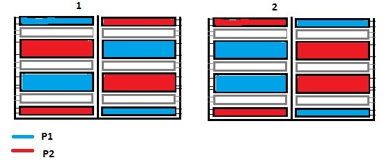

I'm planning to make PP output transformer for UL KT88 amp. Nothing new, +470-480V B+, UL, around 4.5k Ra-a.
What I have at hands now - M6 EI 120-53 lams, split bobbin.
Windings in one bobbin's half - 1/2 P-S-P-S-P-S-1/2P (4 primary, 3 secondary)
where 1/2P is 3 layers (74 turn each) and P - 6 layers (74 turns)
Secondary(S) is 4 layers: 2 layers(114 turns)+2 layers(114 turns) in parallel = 114 turns in one section
All secondary sections also in parallel (both halves of bobbin)
Overall - 2664 turns primary, 114 sec. , so Ra-a is ~4.4k (without considering DC resistance, just turns ratio). Other data - ~160 Ohm primary(80+80), ~0.32 Ohm secondary.
Main question - will it be OK as is, or cross-connection of primary windings is necessary? Any advice would be appreciated.

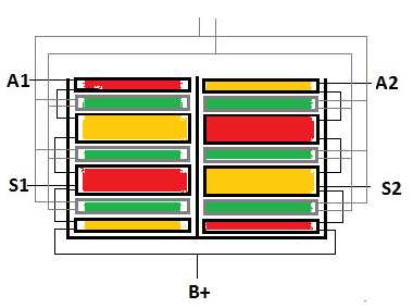

Cross connecting the primary parts surely will minimize leakage inductance without increasing inter and intra winding capacitances. So go for it, but be aware of correct phasing.

If we have 3 primaries, cross connecting seems pretty straightforward (just cross-connect middle sections with right phasing), but I'm planning 4 primaries - so, which option is better - 1 or 2?
Of course, I can test it in practice, but always good to hear feedback from more experienced colleagues. I've made many SE amps and few class A PP's in past 20 years, but UL transformer with this windings layout and class AB is something new for me.

Not necessarily it increases capacitance. In this case, voltage gradients from primary to secondary do not change.
However it does decrease leakage that happens of the transition from class A to class B operation, when only one primary effective half remains active.
Cross-coupling is recommended for class A-B operation.
FEV, any particular reason your anode layers are on the top? Do you want to minimize anode to core to anode capacitance?
Here's how to cross-couple:
Assuming the secondary is at zero ground potential, all capacitances remain the same.
Cross-coupling becomes symmetrical with an odd number of primary layers.
Your sketch of number two will give higher leakage inductance IMHO, because one half has a lower primary to secondary turns than the other. 2 layers of 1/2 P on 3S vs. 2 layers of 1P vs 3 S

And hence my questions here... I "feel" that my windings layout may be non-optimal or plain wrong for UL AB amp.Cross-coupling becomes symmetrical with an odd number of primary layers.
Maybe I shoud go for 4 secondaries with 3 primaries in beetween?

As for the symmetry, I meant for the vertical axis only geometry. You have a point, that with an odd primary turn number, the equal turn rule to secondary will not be satisfied. With three internal primary layers for example, that would translate to one primary active layers on the one side and two active layers on the other.
In this PP case, I find it can be worth starting the anodes at the top, because capacitance between the two A-A regions and the core will be high, 4 times compared to one A region vs ground capacitance. Especially if using a tight, thin coil former.
However you will still have some A-A capacitance, depending of your filling factor, the distance between the outside layers and the core legs.
A-A capacitance is located into the primary region only and not much evil compared to a primary to secondary capacitance. It will effect the peaking (series RLC) resonance, that is easily dampened by load.
Primary to secondary capacitance can bring much more chaos, especially if you series connect the wrong secondary layers. But it seems you are using all secondaries in parallel and that acts as self-screening shunt.
The most capacitance is located however between the primary and secondary layers, because most voltage gradient difference and physical closeness are there.
In a SE transformer still, I see no reason to start the anode connection at the top. It's slightly beneficial to begin at the bottom, because of the lower Mean Turn length, hence less surface area and less capacitance to the following secondary layers.
You're good to go for cross-coupling with the first schematic.

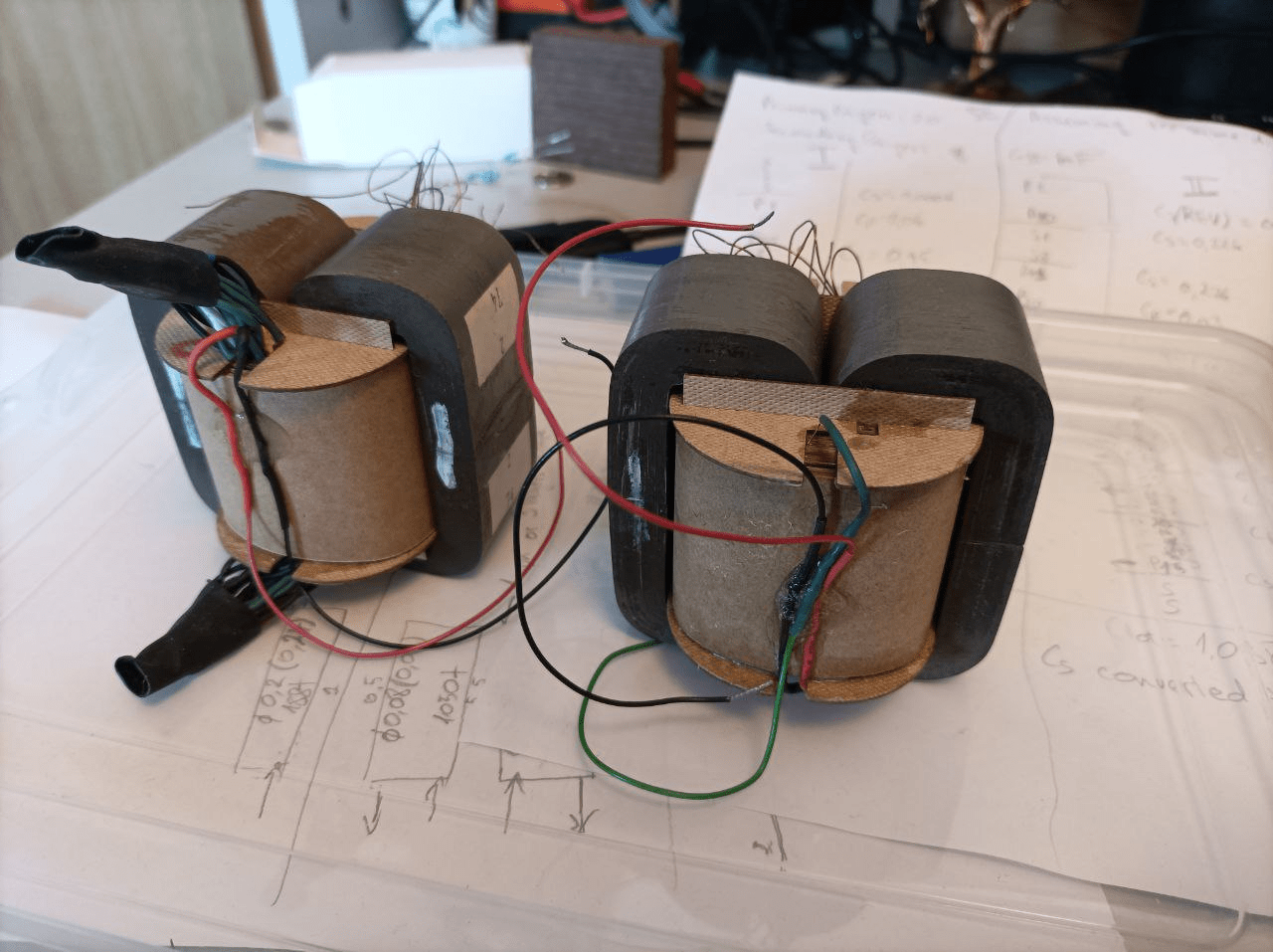

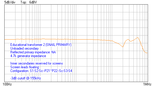

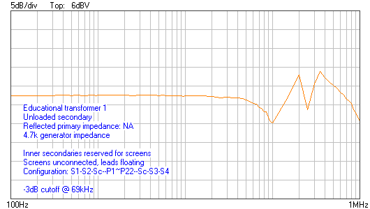

A year ago,I built two line-out education purpose transformers to demonstrate this, that are deliberately high-leakage transformers (70mH), involving S-P-S interleaving. Three layers of secondary, 22 layers of primary, then another three secondaries.
The first one involves a normal winding pattern, where the anode starts at the bottom, close to the S layer. The second transformer has, I call it Snail winding, where the primary chunk anode ending begins within the middle of the chunk, then progressively advances to the B+ zero potential end towards the secondary layers. Back and forth from the middle to the ends. It is not an entirely free lunch, as the capacitance is dumped into the primary region, however you can observe it is much less offensive there, judging by the frequency response comparison.
