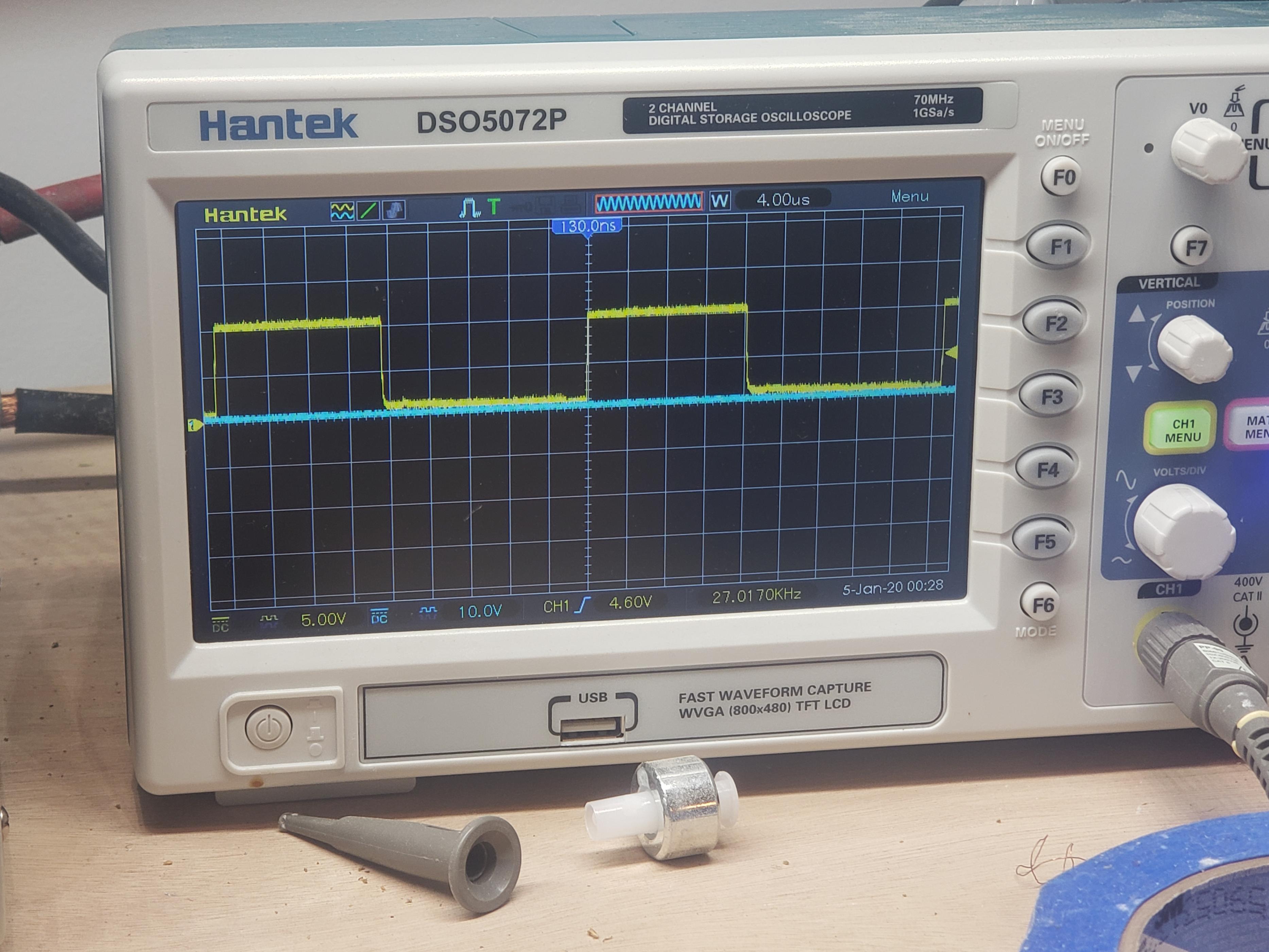

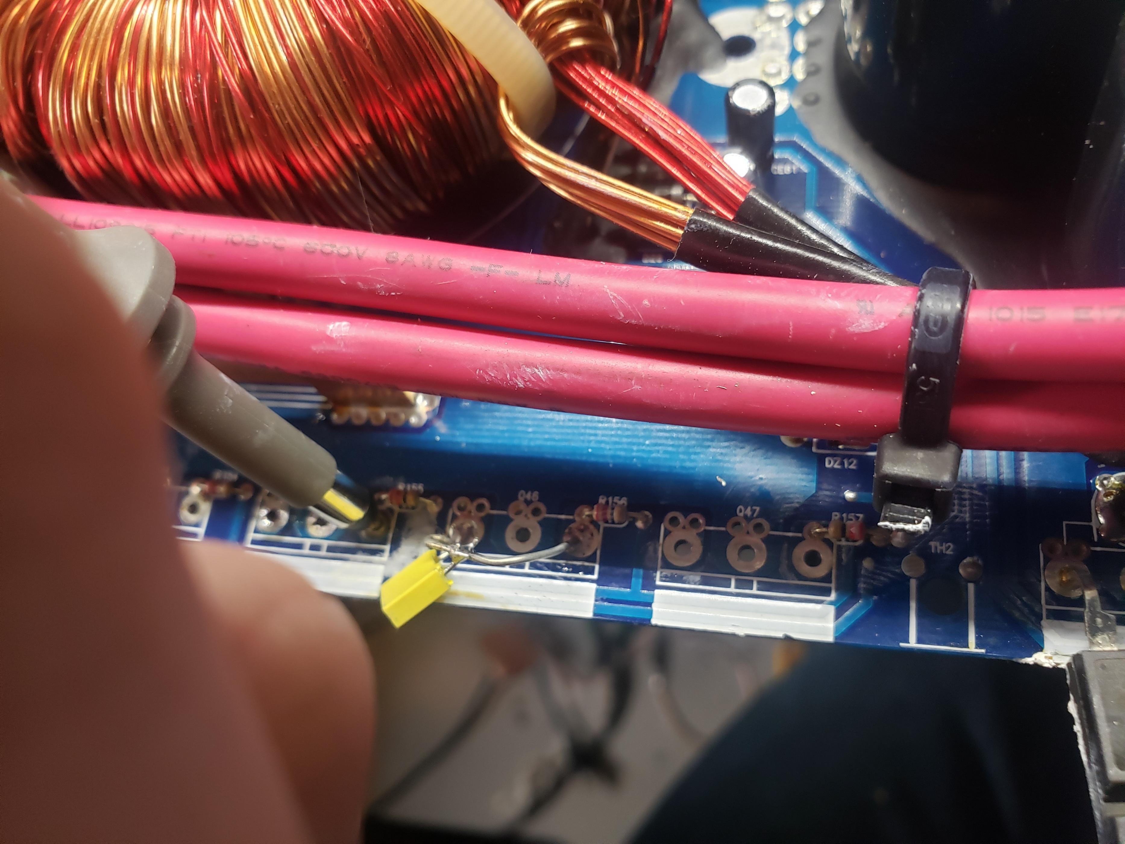

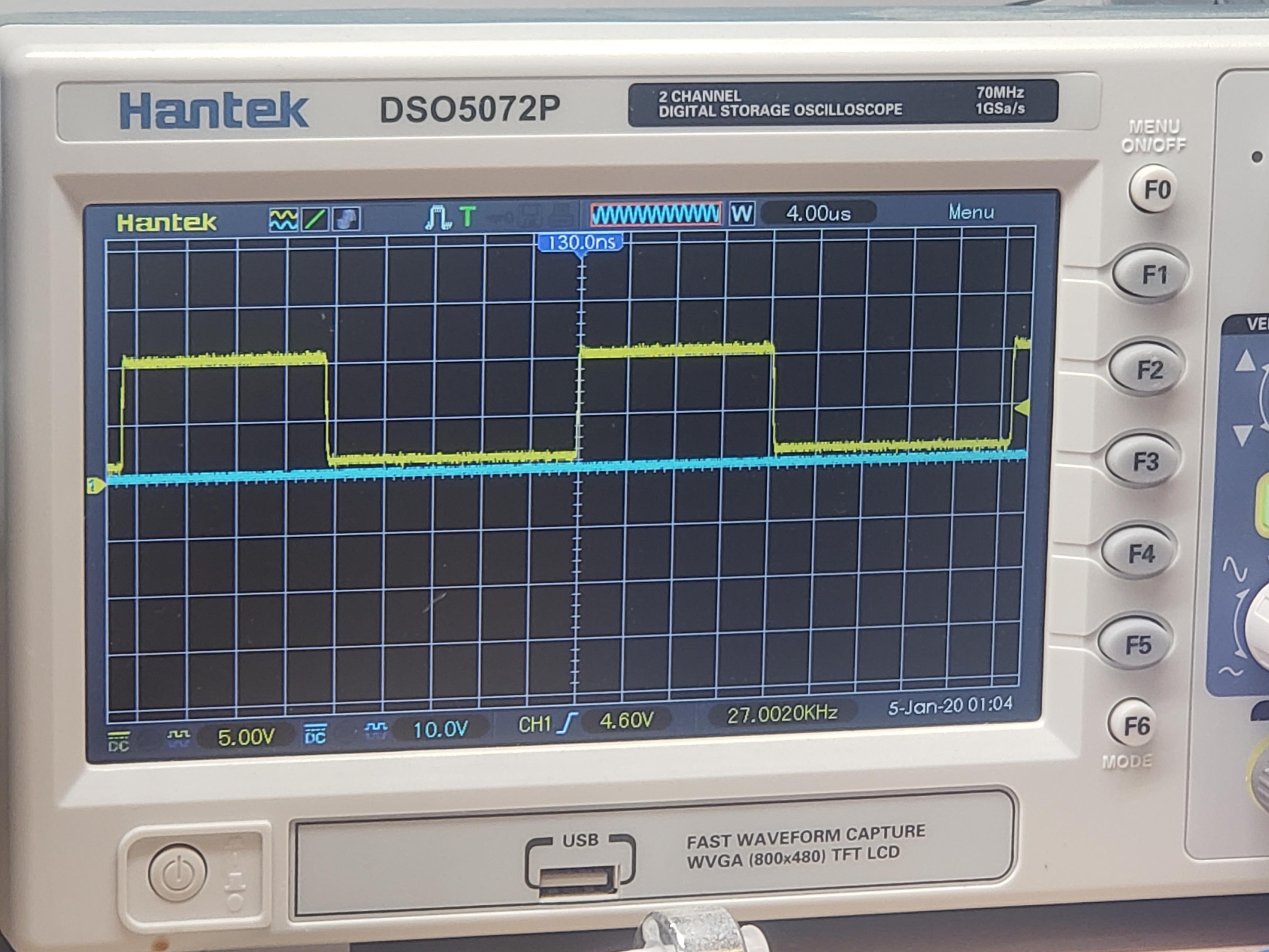

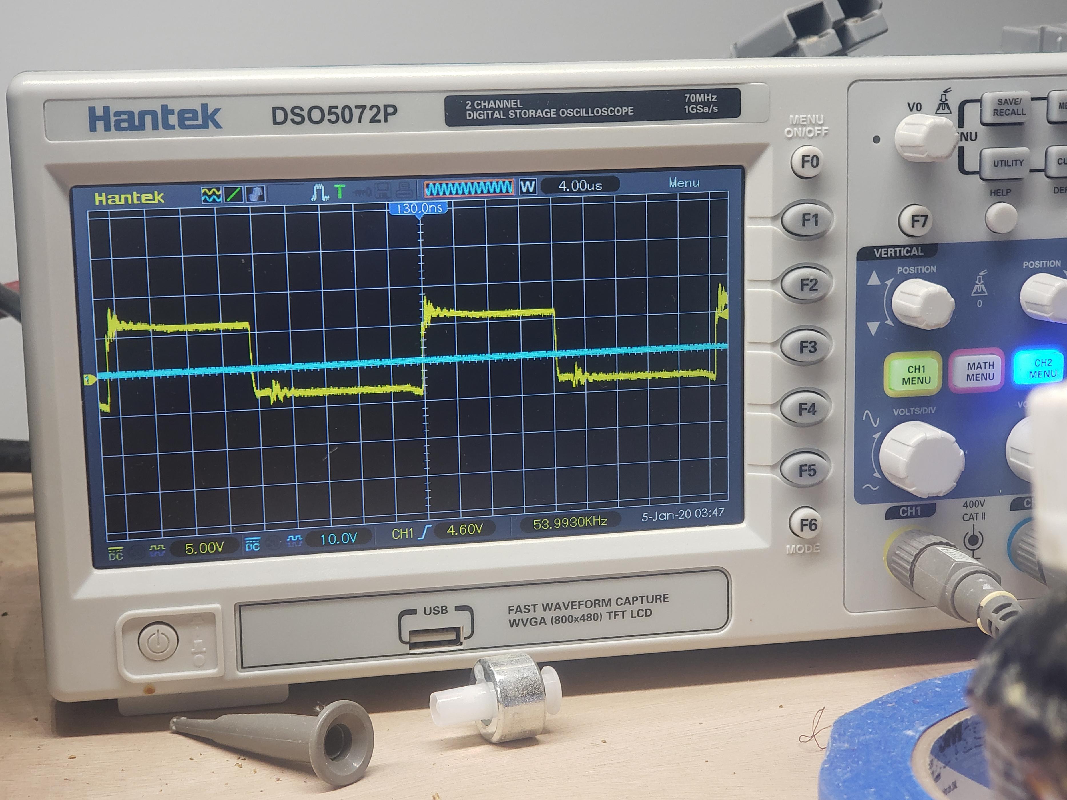

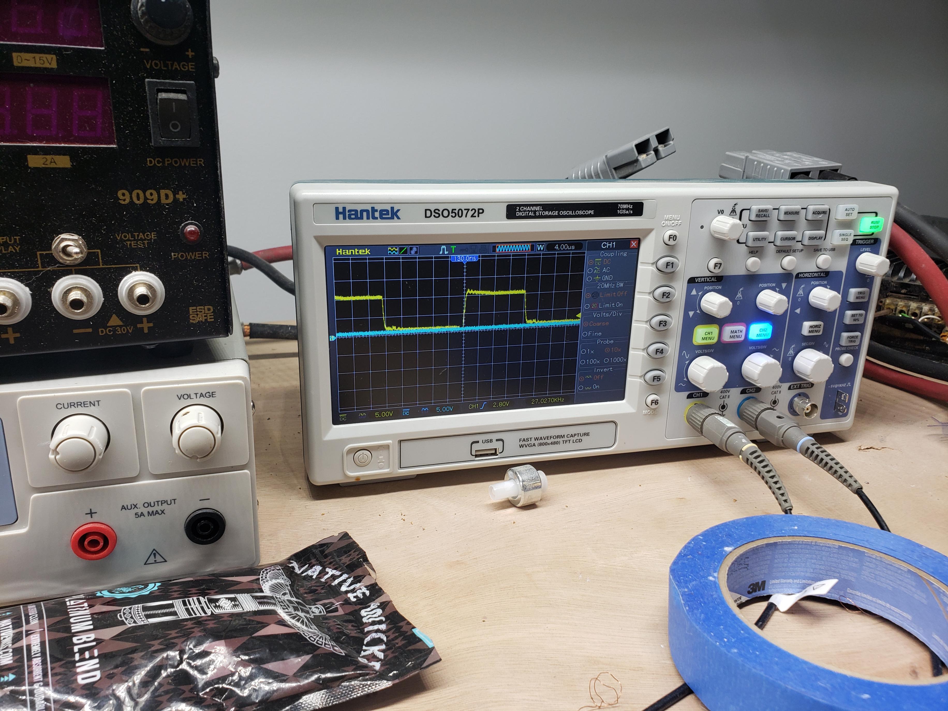

mnhiphop101 Member Joined 2011 2020-01-04 3:46 pm #1 2020-01-04 3:46 pm #1 Is this how the power supply squarewave is supposed to look? Attachments 20200104_094214.jpg 719.8 KB · Views: 95 ••• More options Share mnhiphop101 Member Joined 2011 2020-01-04 3:48 pm #2 2020-01-04 3:48 pm #2 Sorry about the upside down picture ••• More options Share P Perry Babin Member Joined 2003 bcae1.com Paid Member 2020-01-04 3:48 pm #3 2020-01-04 3:48 pm #3 It looks like only one bank bay be driven. Do both banks look the same? ••• More options Share mnhiphop101 Member Joined 2011 2020-01-04 3:53 pm #4 2020-01-04 3:53 pm #4 yes all 4 banks look the same ••• More options Share P Perry Babin Member Joined 2003 bcae1.com Paid Member 2020-01-04 3:58 pm #5 2020-01-04 3:58 pm #5 What do the gate signals look like? ••• More options Share mnhiphop101 Member Joined 2011 2020-01-04 4:02 pm #6 2020-01-04 4:02 pm #6 This is with the fets removed Attachments 15781536745341353032681519742640.jpg 777.3 KB · Views: 90 ••• More options Share P Perry Babin Member Joined 2003 bcae1.com Paid Member 2020-01-04 4:05 pm #7 2020-01-04 4:05 pm #7 The signal needs to be loaded. If the FETs are not in the circuit, load one location gate to source with a 0.047uF cap or something close and re-post. ••• More options Share mnhiphop101 Member Joined 2011 2020-01-04 4:40 pm #8 2020-01-04 4:40 pm #8 Here's what it looks like loaded. Attachments 15781558550251463994382164592095.jpg 678.3 KB · Views: 88 ••• More options Share mnhiphop101 Member Joined 2011 2020-01-04 4:42 pm #9 2020-01-04 4:42 pm #9 This is what u meant right? Attachments 15781561036625899123680130670004.jpg 687.5 KB · Views: 92 ••• More options Share P Perry Babin Member Joined 2003 bcae1.com Paid Member 2020-01-04 4:55 pm #10 2020-01-04 4:55 pm #10 Yes ( I think, from what I can see at that angle) but you have to probe the gate with the capacitor connected to it. ••• More options Share mnhiphop101 Member Joined 2011 2020-01-04 7:21 pm #11 2020-01-04 7:21 pm #11 That's at the gate with the fets in. Attachments 15781655970344987251720859452986.jpg 838.6 KB · Views: 58 ••• More options Share P Perry Babin Member Joined 2003 bcae1.com Paid Member 2020-01-04 7:24 pm #12 2020-01-04 7:24 pm #12 If this has a standard power supply with grounded FET sources, ground the scope probe to the source of one of the FETs and probe the gate leg of the same FETs. ••• More options Share mnhiphop101 Member Joined 2011 2020-01-04 7:32 pm #13 2020-01-04 7:32 pm #13 Ok. Here's what it looks like now. Attachments 15781662543488190217123064388619.jpg 984 KB · Views: 53 ••• More options Share P Perry Babin Member Joined 2003 bcae1.com Paid Member 2020-01-04 7:35 pm #14 2020-01-04 7:35 pm #14 That's a lot better. Does the drain look better when grounded to the source. If this is a regulated power supply, lower the 12v power supply voltage to force the duty cycle to as near 50% as it will get. ••• More options Share mnhiphop101 Member Joined 2011 2020-01-04 7:38 pm #15 2020-01-04 7:38 pm #15 I looks a little better but not normal. Attachments 15781666103045119251744633741098.jpg 800.7 KB · Views: 49 ••• More options Share P Perry Babin Member Joined 2003 bcae1.com Paid Member 2020-01-04 7:44 pm #16 2020-01-04 7:44 pm #16 That appears to be near 14v. Did you try lowering the voltage? ••• More options Share mnhiphop101 Member Joined 2011 2020-01-04 7:45 pm #17 2020-01-04 7:45 pm #17 my power supply is set at 12.4v ••• More options Share P Perry Babin Member Joined 2003 bcae1.com Paid Member 2020-01-04 7:46 pm #18 2020-01-04 7:46 pm #18 Go lower. ••• More options Share mnhiphop101 Member Joined 2011 2020-01-04 7:52 pm #19 2020-01-04 7:52 pm #19 That's at 10v Attachments 15781674385701387344716707826550.jpg 987.5 KB · Views: 50 ••• More options Share P Perry Babin Member Joined 2003 bcae1.com Paid Member 2020-01-04 7:54 pm #20 2020-01-04 7:54 pm #20 OK. That didn't clear it up. What's the duty cycle? Measure on the gate. Does this amp have snubbers on the primary windings? ••• More options Share 1 2 3 4 Next 1 of 4 Go to page Go Next Last Show hidden low quality content You must log in or register to reply here. Share: Facebook Twitter Reddit Pinterest Tumblr WhatsApp Email Share Link Home General Interest Car Audio Powerbass xtr 4000d Top Bottom
