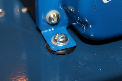

Finally got around to addressing this problem. Simple fix was to cut some large grommets into slices and place one under each transformer foot.
Can still hear the transformers humming close up but that will do.
I feel I'm treating the symptom rather than the cause though because I have 2 similar amps that I acquired rather than built (both electronic design and physical layout, just lower power) and they don't hum at all. Mains transformers on those are probably recycled I'd say - unknown brand.
