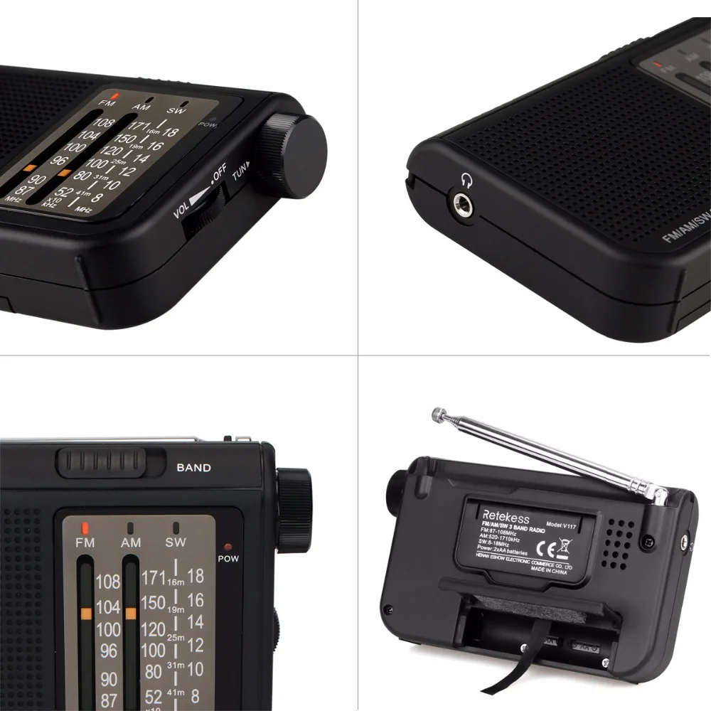

on/off is combined with the band-selector:
https://images-na.ssl-images-amazon.com/images/I/517gbOJOjvL._AC_SL1200_.jpg
on/off is combined with the volume:
https://ae01.alicdn.com/kf/HTB1DrtO...-nger-Kurzwelligen-Batterie-Powered-Tuner.jpg

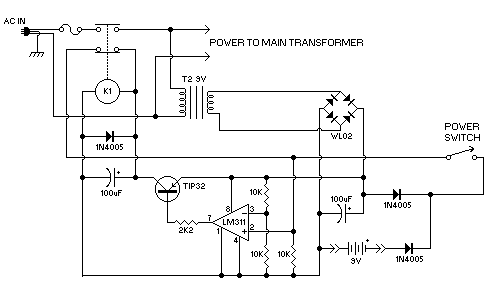

I have built circuits in the past that used a battery to initially turn on the power relay, which was then switched out by one of the relay contacts once the ac power supply came on. This way there is no current draw at all until the power switch is turned on and since the battery supplies only a short pulse of power it lasts a very long time before needing replacement.
Take care,
Doug
Here is an example of a circuit to do this.
K1 is a relay with a 9 volt rated coil and needs to have a sufficient contact rating for powering all of the desired power supplies. The LM311 comparator senses the power switch position and activates the relay using the 9 volt battery. The 100uF capacitor across the relay coil holds it on until the AC powered 9 volt power supply can take over. The 9 volt power supply actually supplies about 11 volts, ensuring that it powers the relay and circuit instead of the battery. I have had the batteries in these power supplies last many years before requiring replacement.
