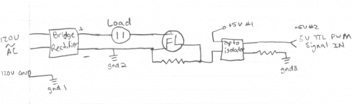

Hey guys, the project I am currently working on only slightly has to do with audio. The goal is to syncronize lights to music. I am currently having a PIC control everything. I didn't have any triac's handy and was having a hard time finding good schematics for them for what I am trying to do, so instead decided to use MOSFETs to switch the mains voltage. The problem is that mains voltage is AC and MOSFETs can't switch AC. So I simply put a bridge rectifier on the mains source giving me a 120V 120hz pulsed DC. Since I am merely switching a light bulb, this is no big deal.
Enough background. I found that the MOSFET only worked when I tied the - side of the bridge rectifier to my +5v power supply ground. That supply is what is being used to switch the MOSFET. This causes a different problem though. Now, my ground is 60V higher than the ground in my wall and in all of my other electronics. I measured with a voltmeter my ground and the ground on a few of my amps as well as the ground in an outlet to confirm this. So now I can't connect my circuit to any others because the grounds are way off and would cause a short... I know there must be something simple I am missing, but I can't figure out what it is.

Here is an attached picture of the schematic I am thinking of. It is slightly different than what I have built and was using which prduced the wrong and unsafe grounds. Does what I haev drawn look correct? I am not sure however which of my grounds can all safely be connected. My biggest worry is 'gnd1'... I doubt that I can connect it to 'gnd2' because of the said 60V difference when they are not connected. I have found that the only way to get the FET to switch is to connect gnd2 and the gnd associated with +5v#1. I also understand that +5v#2 and its associated gnd3 must be isolated from all of the others in the circuit, but I'm still not 100% sure how isolated they need to be. Do I need 2 transformer/bridge/cap/vreg sets for each? Or can some of those be shared? Maybe only have a single transformer and 2 bridge/cap/vreg sets comming off of that or something like that to cut down on size and cost.

OK, let's see here.
Grd 1 is AC ground and should be connected to the chassis.
Grd 3 is circuit Grd for +5v#2 and the PWM circuits.
Grd 2 should not connected to ground. It is the - connection for +5v#1 and must be isolated from all grounds.
You need a seperate isolated power supply for +5v #1. It does not need to be regulated. It can be just a transformer / bridge / cap. It can be very low current, less than 100 ma is OK.
I think I would put the load on the other side of the bridge rectifier in the neutral side of the AC line as shown in you drawing.
I say again BE CAREFULL.
