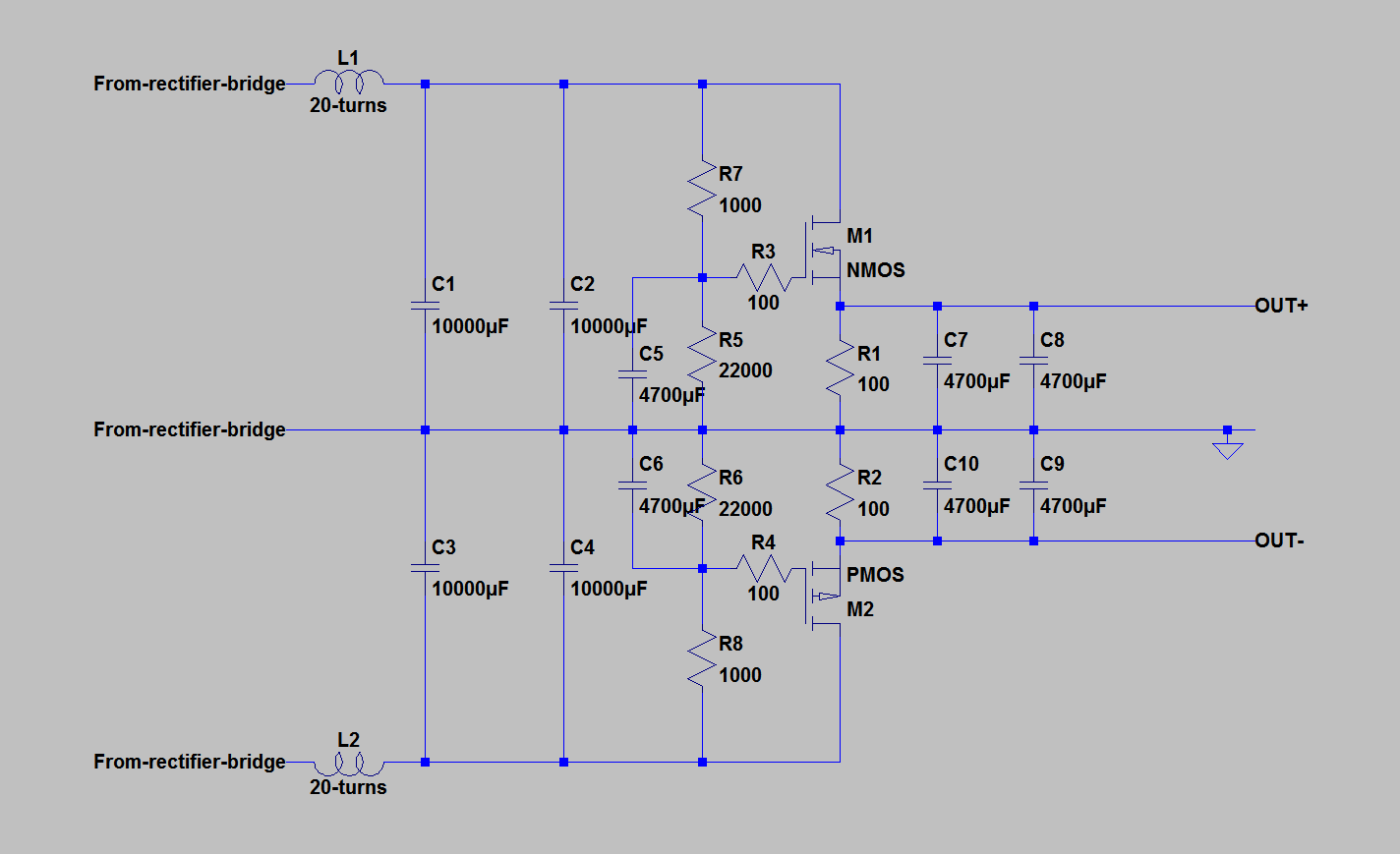

As a more generalized answer I would argue that the power-supply is a very important part for a push pull amplifier. A single end amp with a constant current source only needs a reasonable quite power-supply, but a push-pull amp like the F6 usually sounds much better with a low noise, very low output impedance power-supply. I want to argue that the power-supply constitutes at least 50% of the total sound-quality of an push-pull amp.
Simple active capacitance-multiplier power-supplies with very low total resistance in the preceding filtering will add a lot of dynamic vitality and firm control to the sound compared to passive resistive CRC filtering. This is at least my experience with power-supplies.
Johannes
Johannes
L1 and L2 should be 20 turns of very thick cable around a small former of some kind. It will smooth the peak loading current pulses from the rectifier bridges and prevent or at least damp the constant pulses of intense RF noise that otherwise plague normal power-supplies based on rectifiers under heavy load.
Feel free to increase the capacitance values. The 100 ohm resistors connected to the source-pins of the fets are to bias them and avoid letting them close and enter the very non-linear region at very low currents. It might not seem very important with class A amplifiers, but you can definitely hear a difference with or without them.
Johannes
