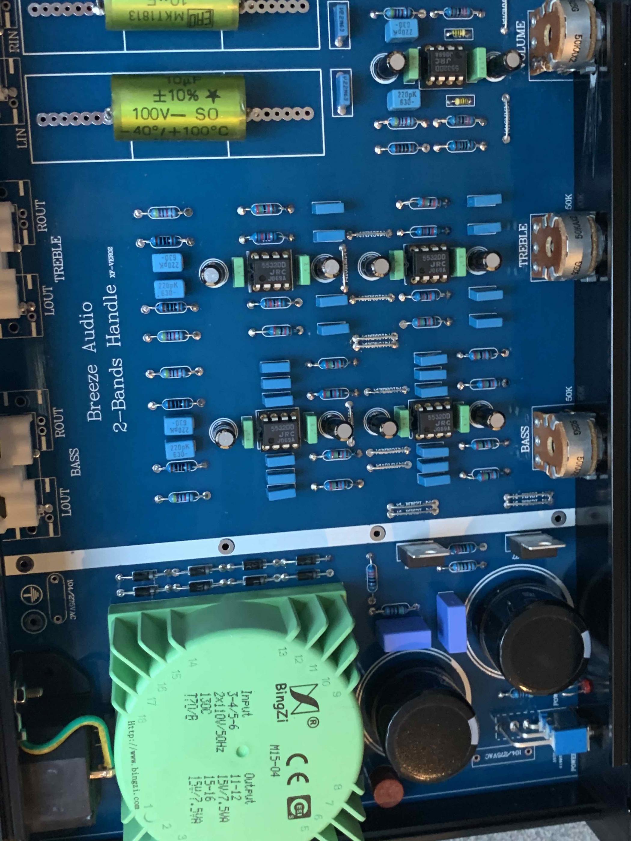

Consider a 2 way active crossover with just 5 double op-amps (originally NE5532)

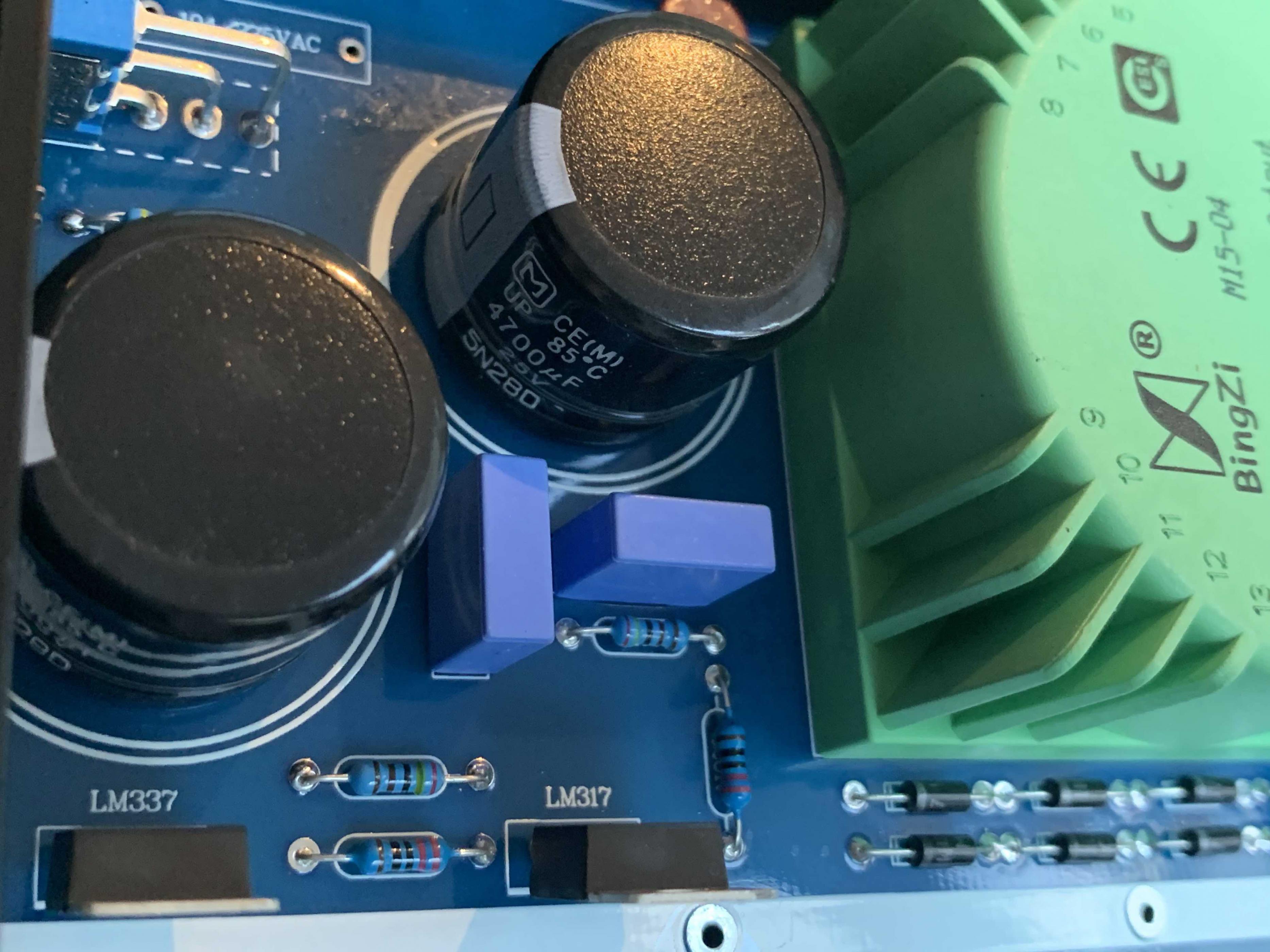

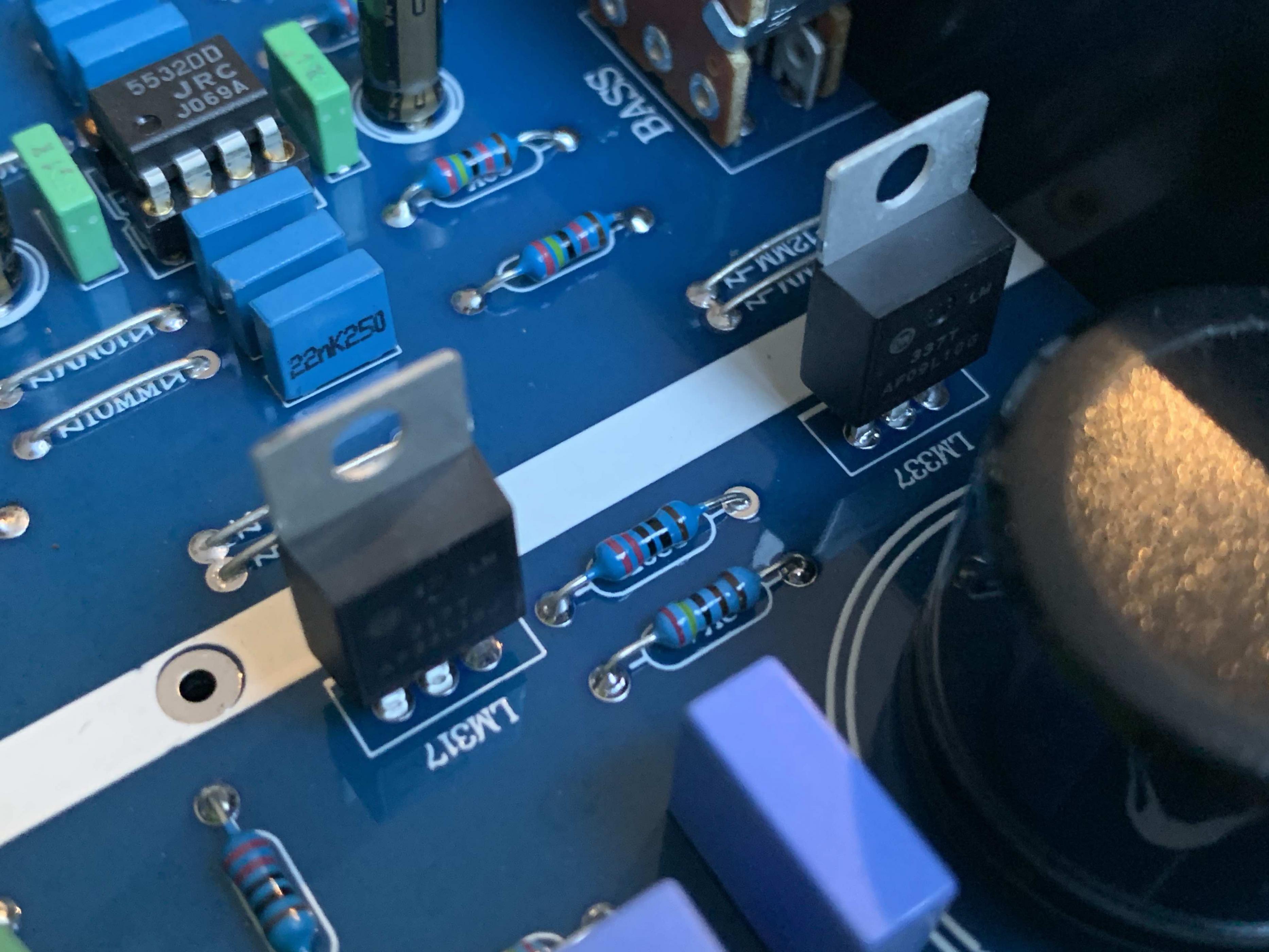

What do I need to look at to make sure the power supply could feed op-amps with higher current demands without over-heating? (I'd like to try discretes).
Voltage regs are LM317 - 337 in TO220 package. No heatsinks.

You should get at least 100mA without heat sinks, and perhaps your supply could give even more current
with individual heat sinks bolted on the regulators. That depends on the unregulated input voltages and the
capacitors used (and maybe the transformer).

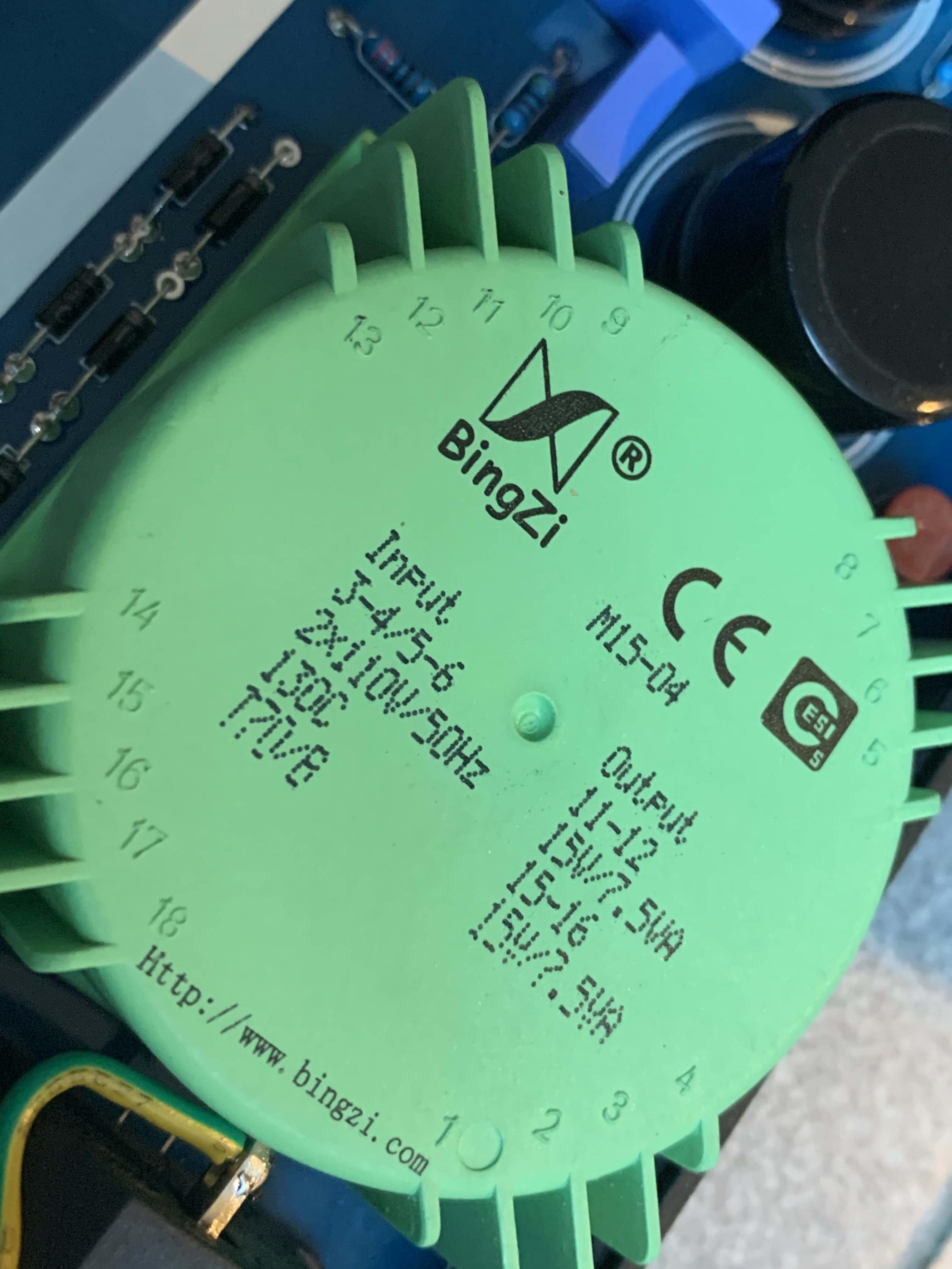

I would like to use discrete op-amps; lacking a complete datasheet I can only have a wild guess at what a dual opamp package consumes but I'd consider 60mA quiescent current per package to be a safe assumption; multiplied by 5 that's 300mA quiescent, not even mentioning dynamic current...
Is there anything you can tell me about the feasibility of the project, looking at the attached pictures?

I would add heatsinks.Voltage regs are LM317 - 337 in TO220 package. No heatsinks
May not be enough room for sinks. Also the transformer winding may not be large enough for the extra loading.
You could try it, but check the voltage across the regulators and make sure it is at least 3VDC, and preferably more.
