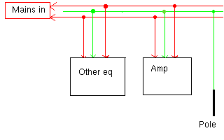

So, to sum up all the advices, use common sense, drink akevitt (That's how it is spelled in norwegian) and use a grounded plug.
Now, as I said I don't have a grounded outlet in my room. Running a wire frm the kitchen is possible, but only a short-term solution (and not a good one for me).
Now, I have a perhaps unorthodox solution to the problem:
I run pretty much everything electric from extension cords with muliple outlets, and they are all with grund plugs. If make an extension cord with only ground connected, plug it into one of these, and run it out the window to an iron pole driven deep (say 1m/3ft)m into the ground. Wouldn't this be sufficient?
As a side note, what would using a dedicated ground like this do to hum loops?
