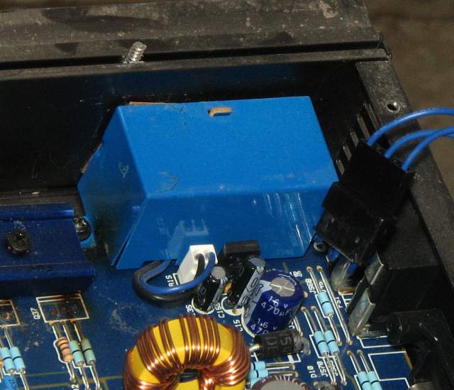

Hello all.. I'm having a problem with an amp that my brother has had for quite a few years... he only used it for about a year and never abused it. Then one day it just stopped working.. All it does is moves sub back and forth at a slow rate even when not hooked to rca jacks. When it does this it draws a lot of power from the power source and the red led light on the board stays lite the whole time and blinks with the draw of power. All wiring is hooked up right. I was wondering if someone had this problem before and how it fix it. Its a Power Acoustik Fire & Ice FI2X-1600 amp.

Yes this does have a box that says high voltage on it. it plugs into the other part of the circuit board from the left hand side. Is there anyway that I can test the transistors or anywhere I can buy them from like a radio shack or something?

I already unplgged that box the the neon and the neon itself when i pulled the cover off.. I don't want to seem like an idiot but the trans your talking about is the yellow round thing at the bottom of the attached pic from perry? I'm no electronics expert by far but I know basic 12v circuits pretty well and obviously know how to check resistance in circuits. 😎
The yellow component in the photo is an inductor. The transformer will be larger and the core will be parallel to the board instead of perpendicular to the board.

I measured across the blue resistors that are close to the transformers and got no voltage. I checked the voltage across 2 green ones on the audio side of the amp and got 12v at them when the input amp voltage is around 6. Not sure what it means but thats the latest that i have found.

This amp uses ceramic emitter resistors. It won't be possible to measure across them directly when the amp is in the sink. Place the red lead on the E terminal of Q114 and the black lead on the E terminal of Q115 and power up the amp.
Do the same for Q214 and 215.
Remember, the voltage will be very low (well under 1v).

Q114 and Q115 E's had no voltage
Q214 and Q215 E's had .09-.10 volts

That tells you the problem is on the side with Q214/215.
Pull the output transistors on that side and recheck them out of the board. Check with the meter set to diode-check and with it set to resistance. You shouldn't have any readings less than 0.4 on diode check or less than 2M ohms on resistance. You're likely to find 1 or two that are defective.
If none of the output transistors are defective, you may have a defective driver transistor or a broken solder connection in the bias circuit.
If they're defective, you'll typically find a direct short (~0 ohms) between two or more of the leads.
